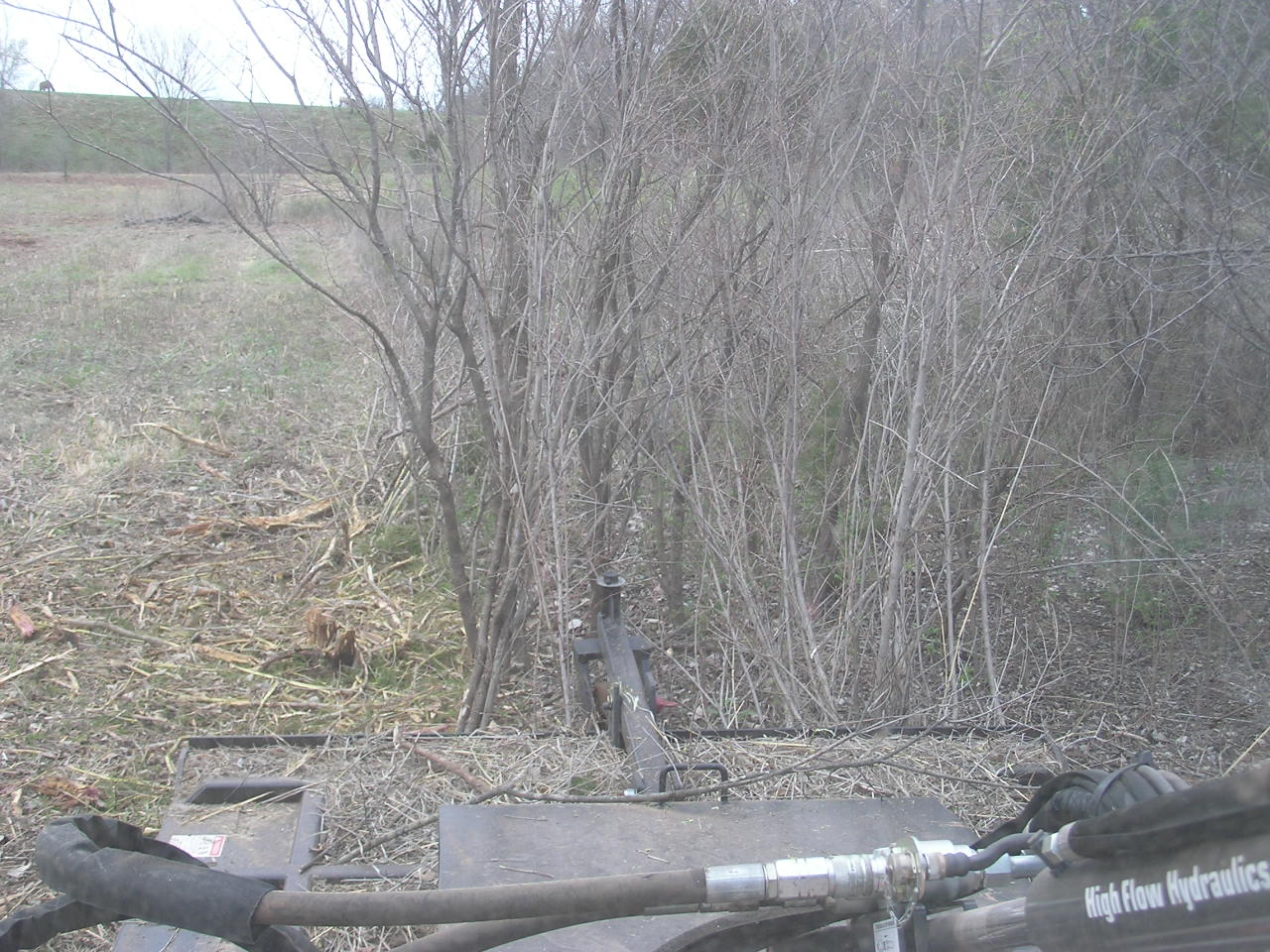

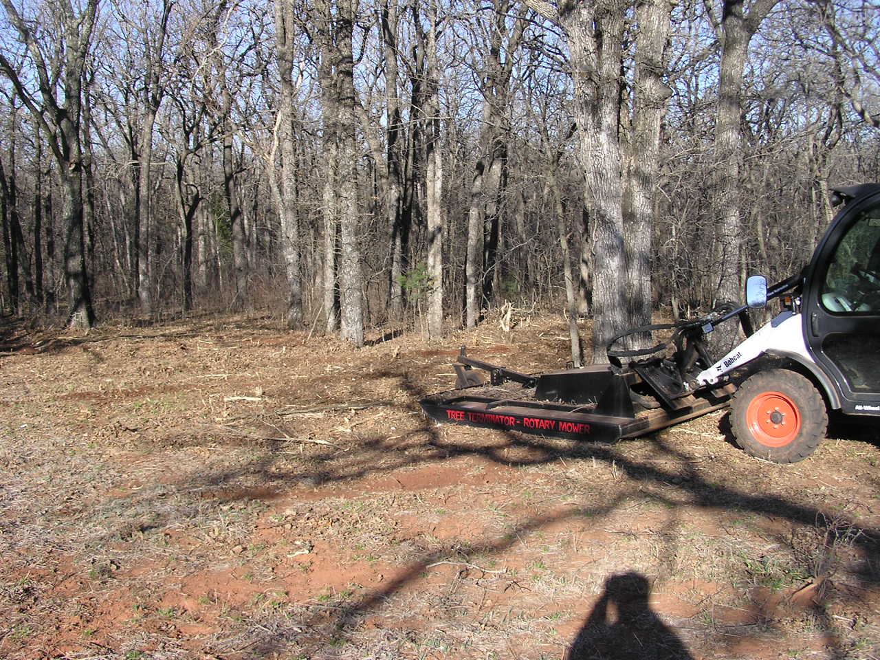

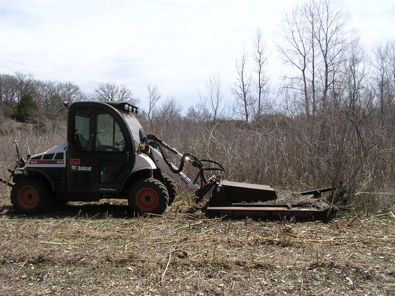

I use a 7' rotary mower that is rated to cut up to 4". Skid Steer Rotary Brush Mower
More of my pictures here: http://www.tractorbynet.com/forums/toolcat/275578-5610-cutting-brush.html

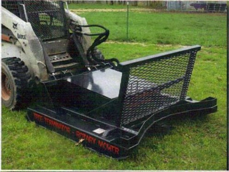

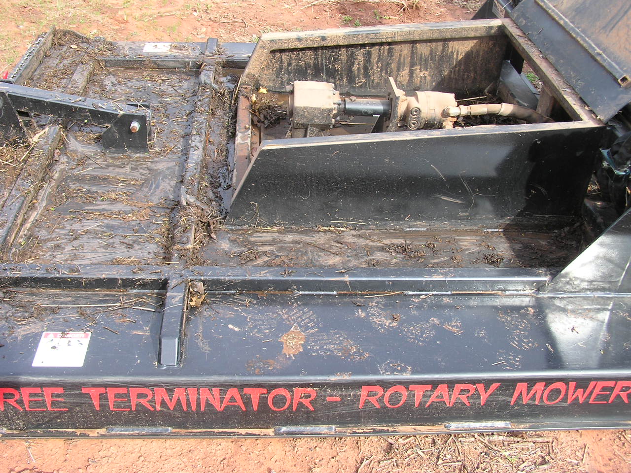

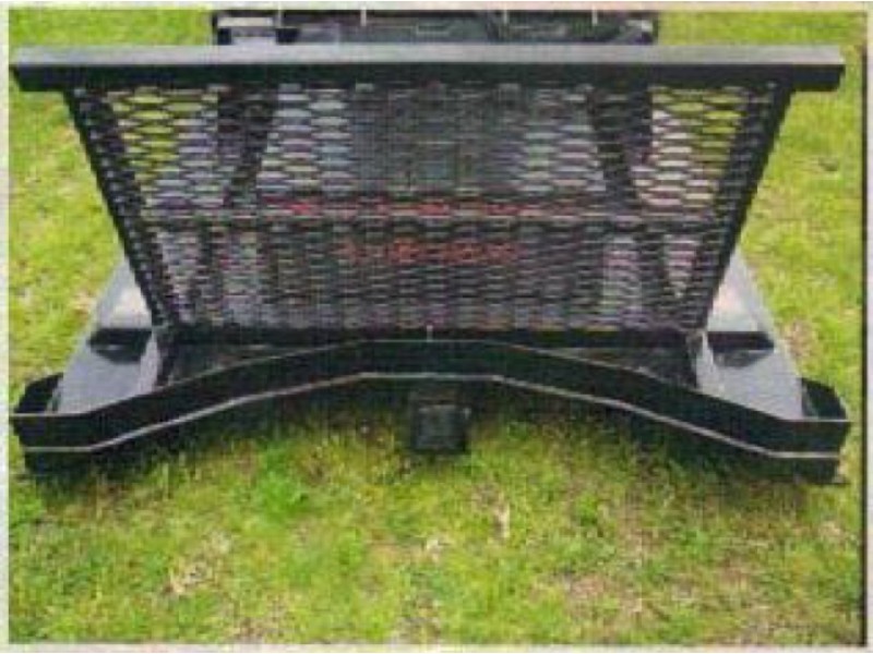

Thanks for the reply and suggestion. How heavy is your mower? 1800 pounds, rated for 3" When I looked up on the company's website, the 6' weighs 2,300 lbs and the 7' weighs 2,500 lbs. it also lists that they cut up to 8" trees (seems) a big claim. Yep, but look at the cutting system, with the 425 pound cutting wheel.
_t2ec16f_zoe9s5nc3o_bry_b6h32q_60_57.jpg _t2ec16n_zue9s389y3-bry_b-_gf_60_57.jpg slasherBottom.jpg
Best TL
That is the "SLASHER skid steer brush mower", I have the "Rotary Brush and Grass Mower".
What I meant to ask is can the Toolcat handle such a weight?
My 5610 handles the 7' Rotary just fine, even with no counter weight on the 3 point. Also when you are mowing, half of the weight is on the front wheel.

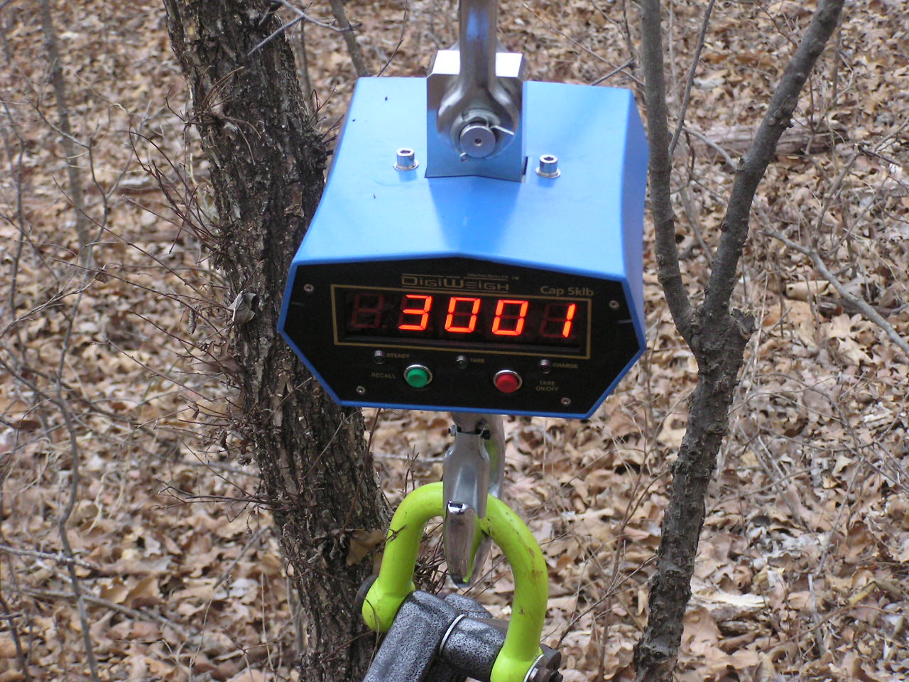

I think the 6' Slasher would pretty much max it out. I have measured 3000 pounds of lift at the SSQA plate, but 2300 pounds extending that far out would be a big strain on the listed (by Bobcat) 1550 ROC
P3220001.JPG.
