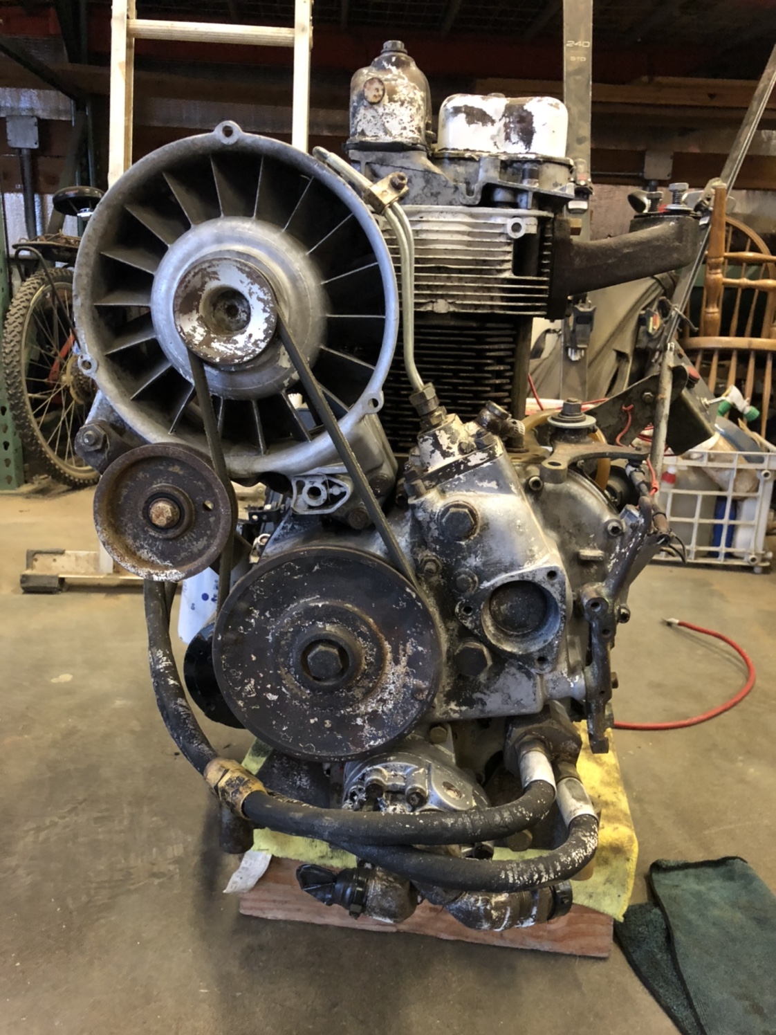

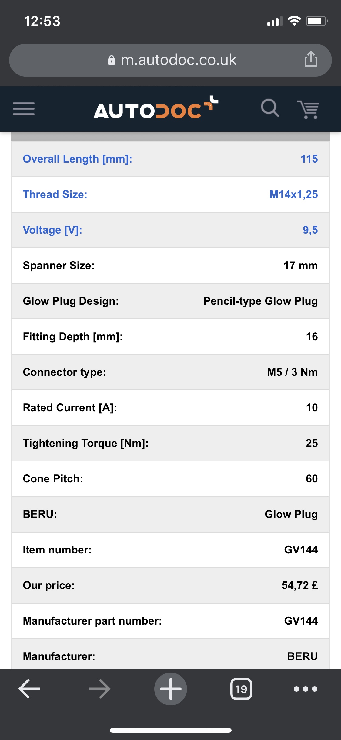

Long time no post but I'm working on gathering information for a project machine. Last week I picked up an old M600 with a bad Wisconsin engine. Having had no luck finding a Wisconsin locally I did manage to find the Duetz F2L410 out of an M600D locally on ebay. So fast forward a few days I managed to pick up this Duetz engine, the only catch is there are no glow plugs. I called Hamilton engines (the local Duetz dealer) and they are having a hard time finding anything. Based on my research the glow plugs are specific to the IDI (in-direct injection) F2L410 as the F2L410D and the F2L411 (found in the M611 and countless other machines) are direct injection and utilize a small intake heater instead of glow plugs. I do have some bobcat part numbers pulled from the bobcat online parts catalog:
Duetz F2L410 Part numbers:
Bobcat #6512584 (glow plug)
Bobcat #6516071 (connector, glow plug)
Bobcat #6516069 (wire, glow plug)
Would anyone have the resources to cross reference these part numbers? I've just about exhausted my resources, aside from maybe finding another engine, any help is much appreciated.

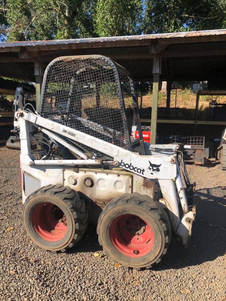

Picture of my project loader for reference:

Making progress! Called bobcat parts and was able to get them to cross reference the bobcat part number to the OE number from Duetz.
Bobcat # 6512584 - Duetz # 117-1352
From there I found the specs on this Beru (Borg Warner) GV144. Hopefully I can cross this number with a domestic glow plug, I’ll post whatever I come up with in case someone ever needs this information on the future since I’ve spent many hours researching this dang glow plug.

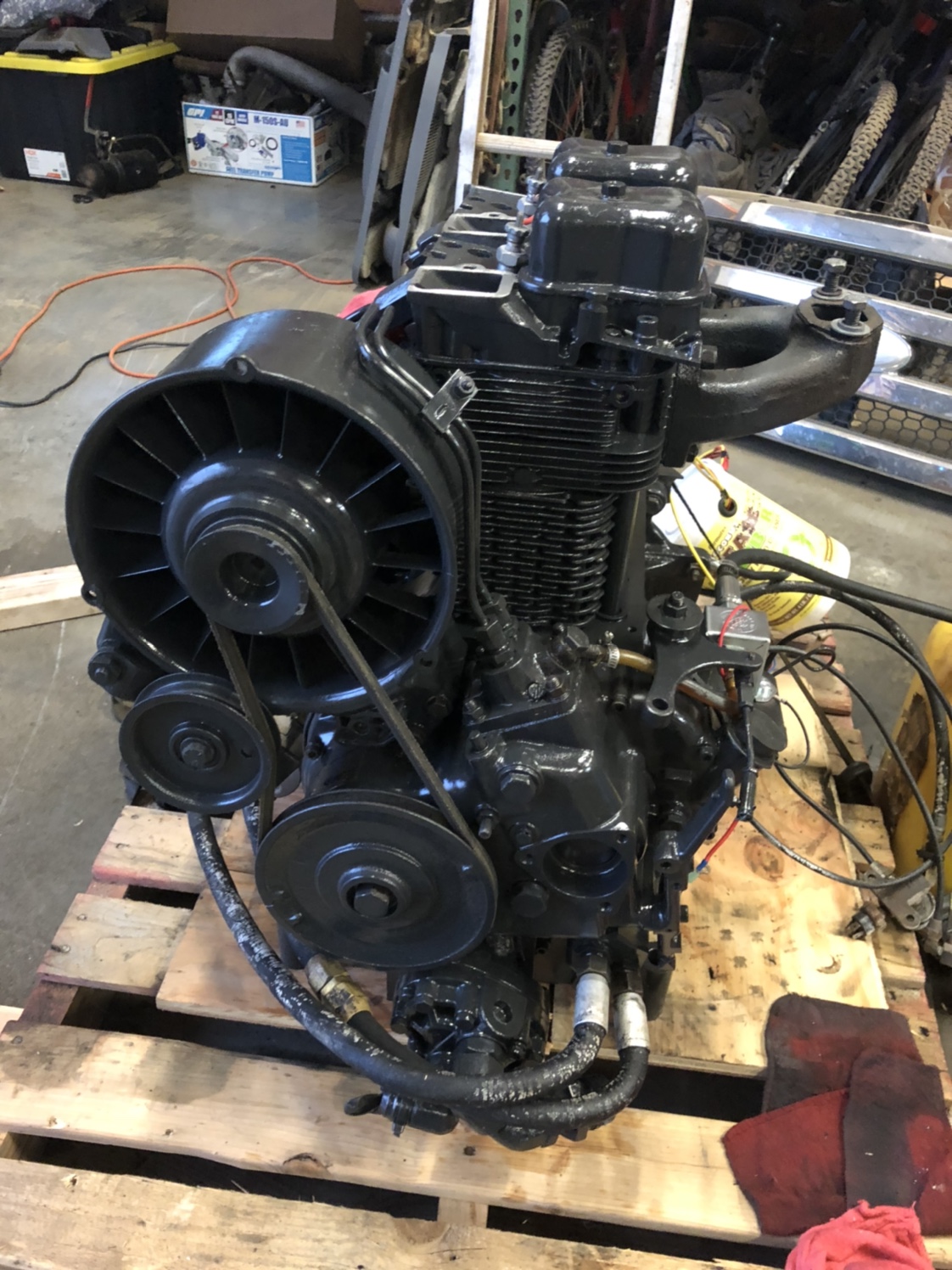

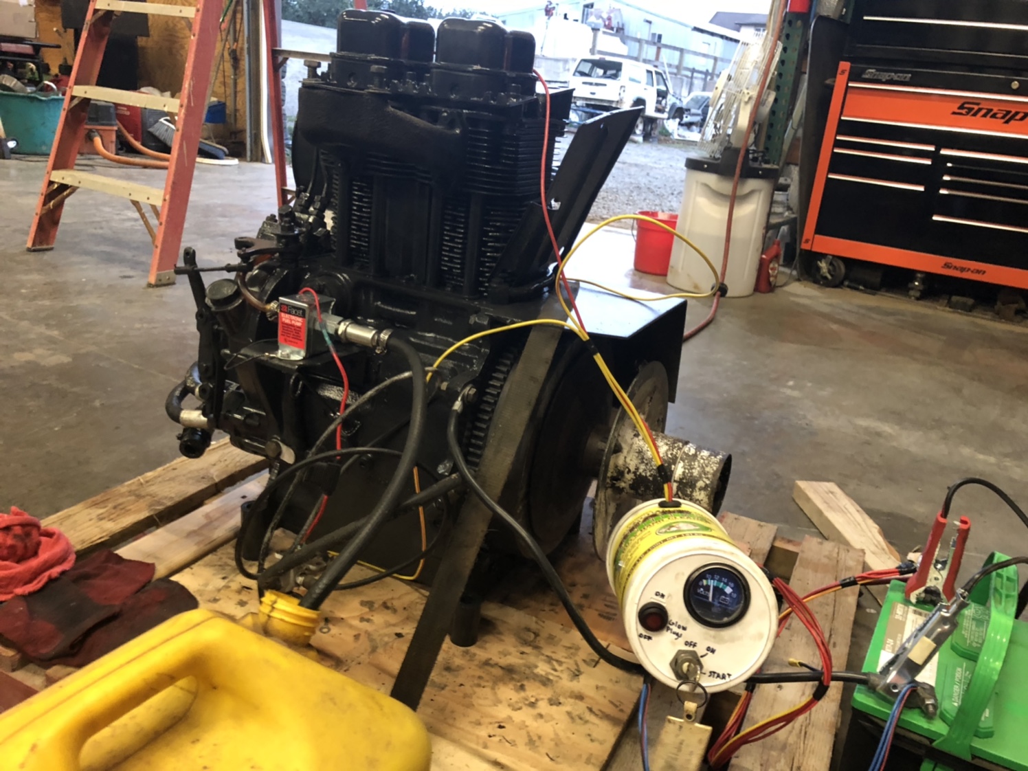

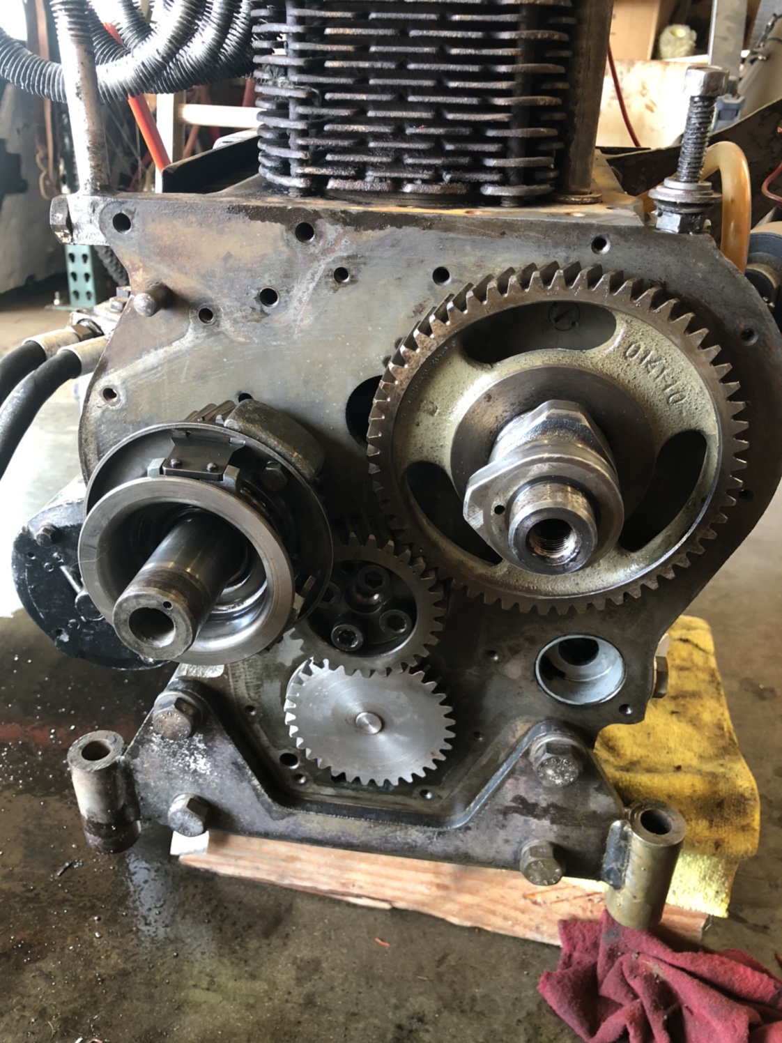

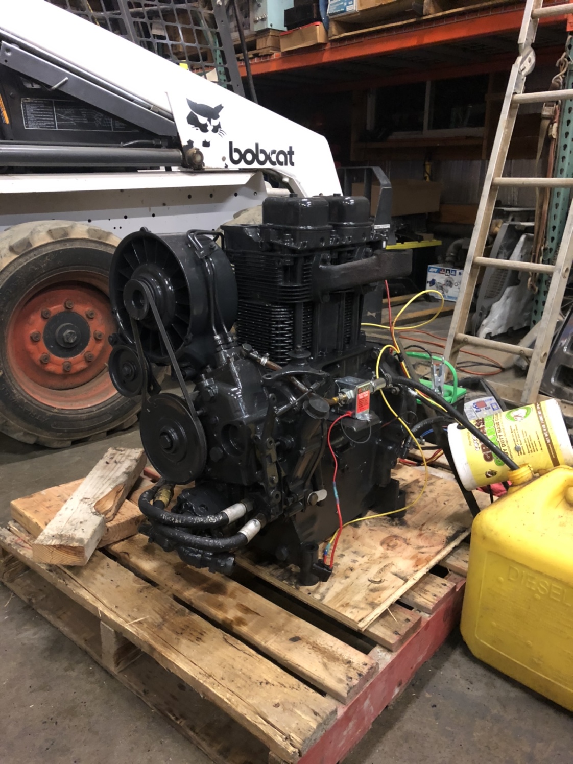

Update time. Got the glow plugs installed and tried to start the Duetz after wiring up a very primitive harness for the glow plugs and lift pump. The starter on it sounded awful but it would get close to starting then kick out the pulley for the governor. Upon this happening he governor would basically shut off the injection pump eliminating the chance of starting the engine.
I originally believed that the retaining bolt for the governor had backed out but after further diagnosis I found the pressed in governor bearing was sliding in and out of the block allowing the governor to slide into the timing cover. One $40 bearing from Napa later as well as a tube of silicone and I finally had the engine on track to start up. While I was at it I also replaced the starter with a used one from a V2003 Kubota engine, installed a Kubota dipstick since mine was broken off at the full line, made a temporary “start box” out of a small plastic tub, an old bobcat ignition switch/volt meter, and a couple relays. Also shot the engine with bobcat grey paint to spruce it up a little.
After bleeding the fuel system and finding that this engine needs a solid 20 seconds with the glow plugs in 60*F weather I finally got the Duetz to fire up. It actually runs pretty good, minimal blow by, although quite loud without a muffler. It has a few minor oil leaks but it’s finally in a state where it can be installed in the M600.
