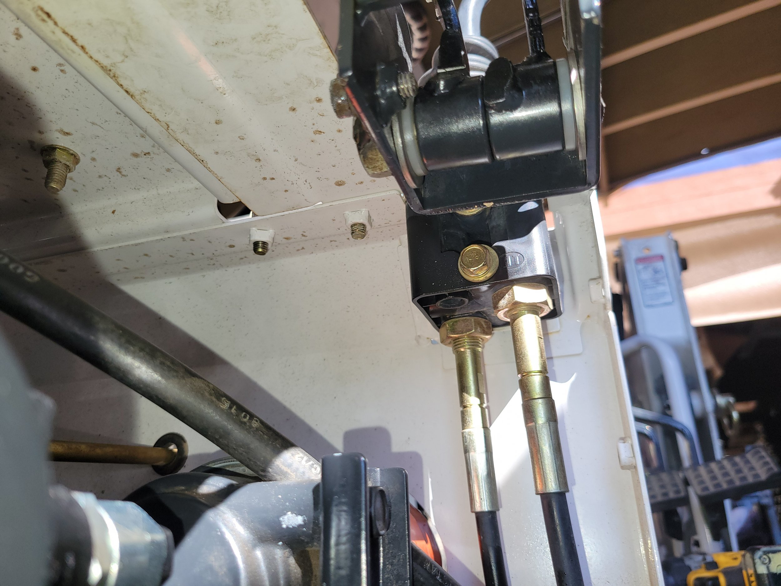

Bobcat ct 230 same as Kioti ck 30

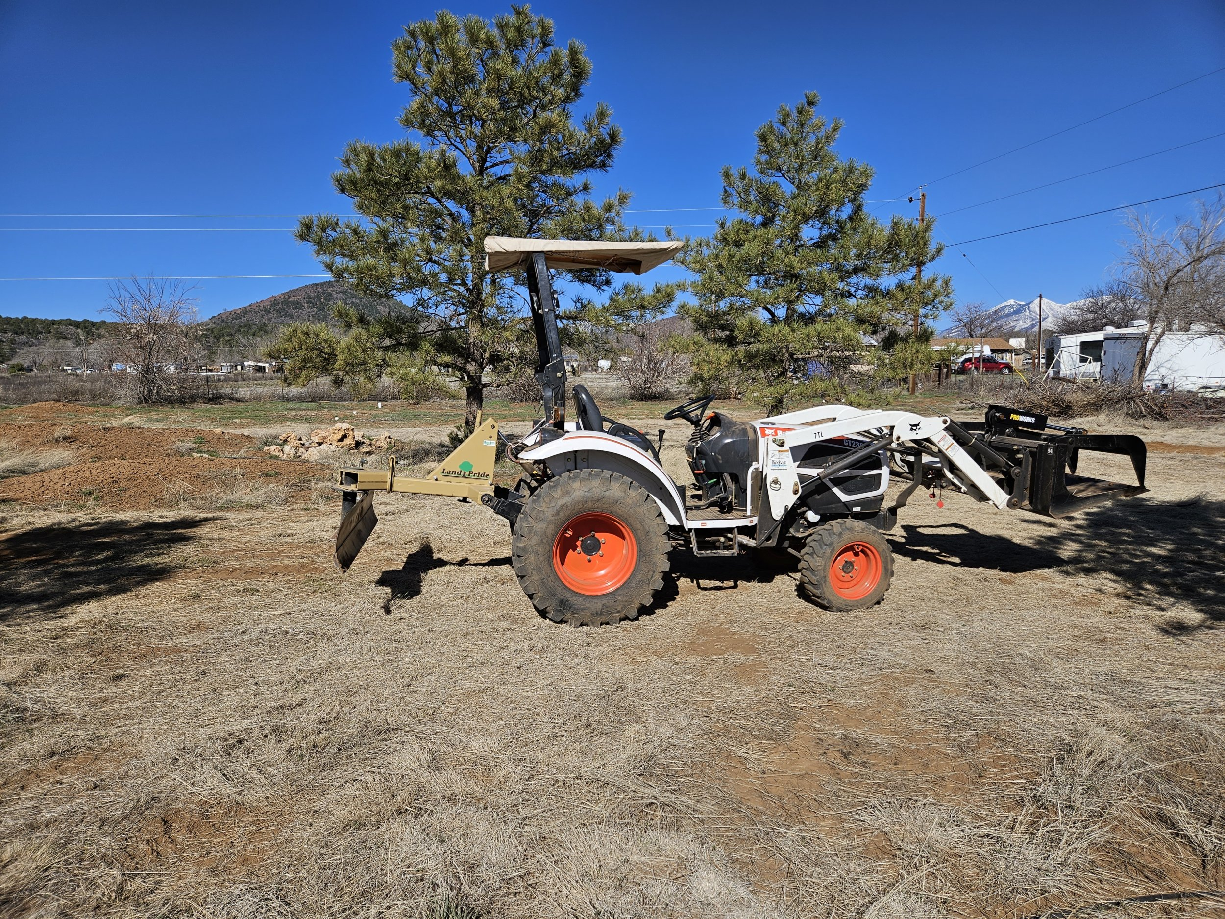

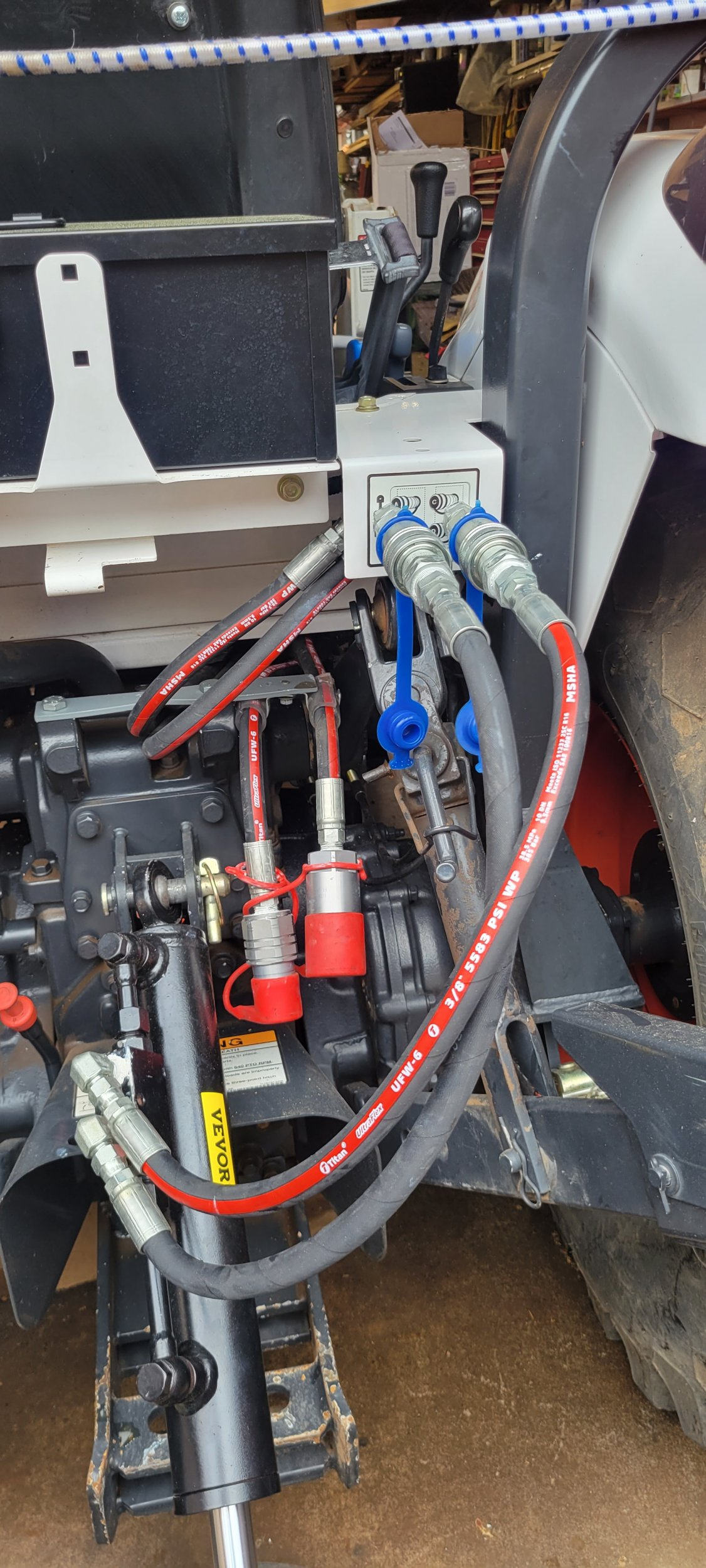

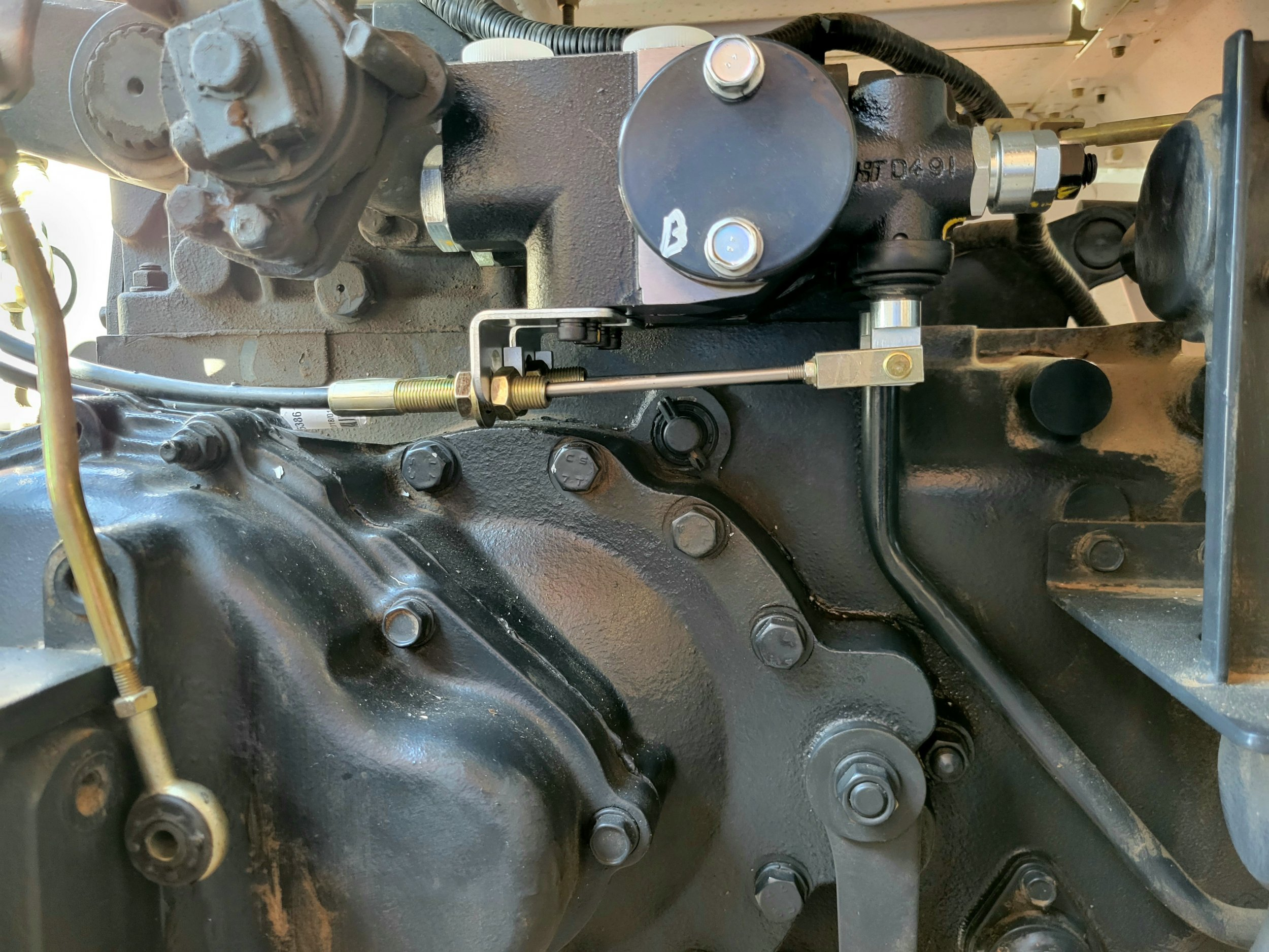

Recently completed additon of factory valve set and controls for my Bobcat tractor, I was able to buy a nice group of parts from ebayer who bought out a Kioti dealerships parts in N.Dak. When the company went under.

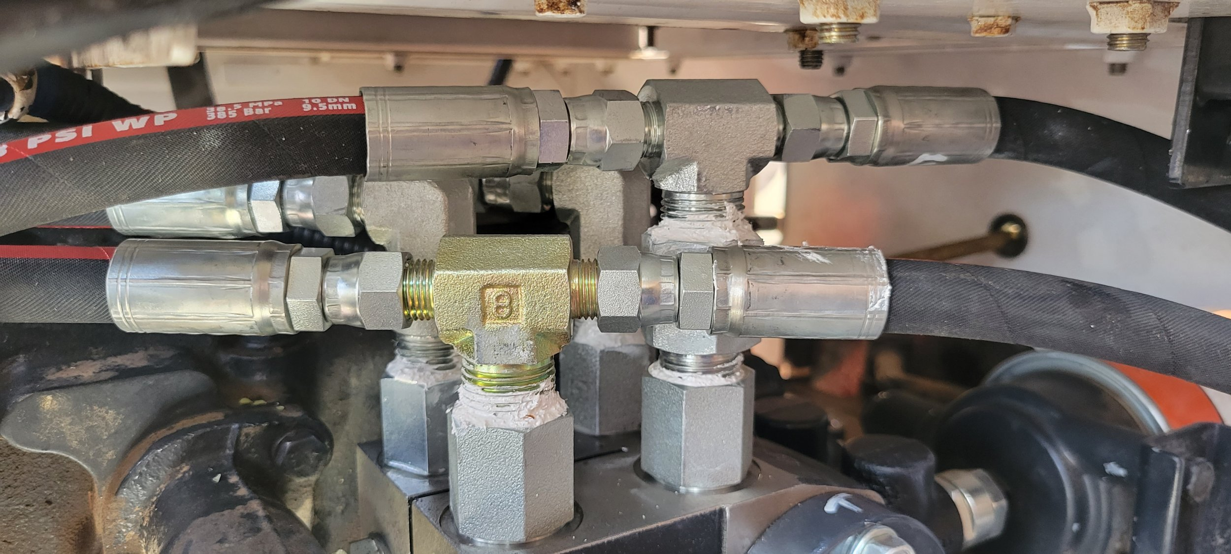

Took me a month of planning and buying and another month of buying and installing. Spent about $12-1500 on parts. Got of the the wrong foot on the output ORB fittings from Kioti, they are 1/2" ORB #8 British pipe thread. Bought all my other parts and hoses from Hydraulics Direct. Except this MOST important starting point:
Adaptall 9035S-08-08 Carbon Steel -08 Male BSPP From Murdock Industrial in OH.
