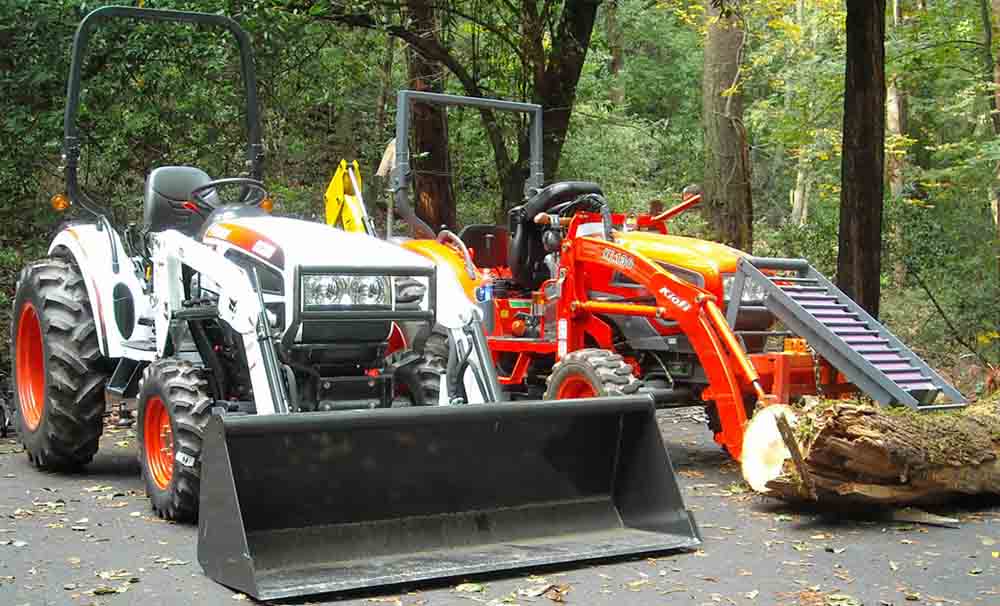

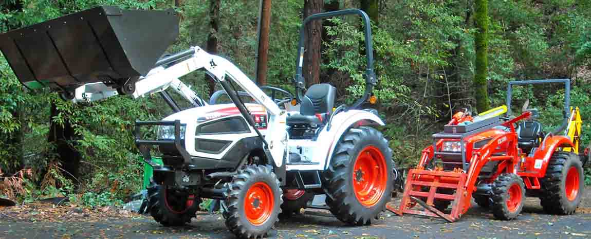

Just received my new CT230. I still can hardly believe the price....
Under $12.5K for tractor, including bobtach 7TL FEL, AG tires, and
single AUX remote valve. Delivered, including 9% sales tax. That is
considerably less than I paid for my 2005 CK30 with more expensive
R4 tires and no QA FEL bkt.
There are some very interesting differences here....some are better on
the Bobcat, some are better on the Kioti.
> The CT comes with 8-ply AG front tires, so they can be pumped up
to 48 psi. The CK has only 6-ply, and my older Kubotas only came with
4-ply AGs.
> The 7TL FEL comes with a massive 68" bucket with a reinforced upper
lip and a cutting edge that is pre-drilled. Kioti says 60" is the widest
bkt you should mount.
> CT has a horn and CK does not
> CK protects the starter switch from water; CT's switch is fully exposed
to rain and wash water. My new CT has water in the switch already.
> You can turn on the CT's lights without the key....not good, IMO
> The CT's engine speed lever works backward (pull toward you for
higher speed)...what's up with that?
> CT has more safety interlocks, incl a seat switch that will kill the engine
if you try to run the PTO off the tractor, as with a mixer, generator, or
chipper. That has to go.
> The CT's front axle has only one fill cap, down from Kioti's 2.
> CT has gone to a Chinese plastic/aluminum radiator vs. Kioti's
all-brass unit from Samsung
> CT uses a dual element air filter, but it has exactly the same
Donaldson outer filter and housing as the CK. You can use the Bobcat
inner filter with the CK if you want.
> The CT's FEL has very exposed hoses....more so than the CK. Some
protection is needed.
More on the 7TL vs. the KL130 loaders coming up......

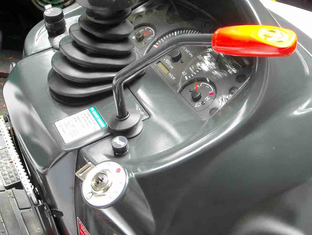

Here is the new cowl. The horn is a great addition....the switch is in
the same place as my custom switch on my CK. Bad news about the starter
switch....no protection from water as with the Kioti. Bobcat changed the
keys and switch from the DaeDong original which has an additional ACC
position.
