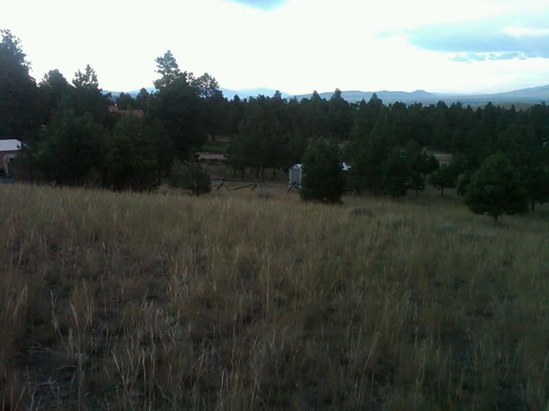

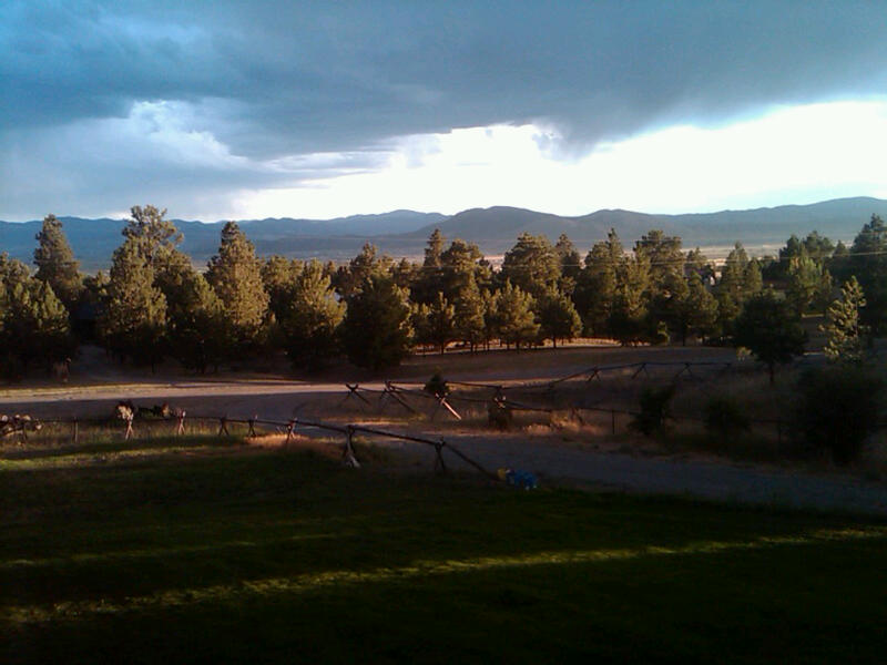

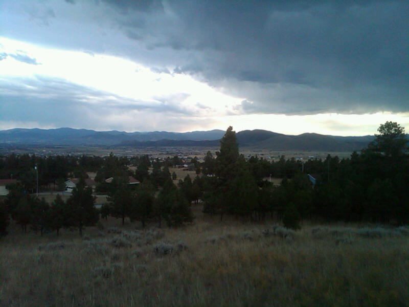

Thanks all for the posts! I probably should point out I am not getting this for a lawn I have a little craftsman rider for that. I will be cutting only brush and natural vegitation as well as spraying for weeds and pine beetle, moving dirt, stone and dead trees, landscaping, snow removal and road maintainance.
I travel and am in most major Montana towns every six weeks. So I know outa town better than in town! I would prefer to support a local business but they need to be competative. I understand the need for a solid distributor more than you can imagine!
