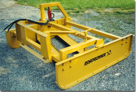

I haven't used the box scraper but I did try out a "roadrunner". It's a bit big at 7' wide and heavy at 1200lbs., but the toolcat handled it fine for grading my road up and downhill. If it was only 6' wide, it would be better, however. I imagine the boxscraper, if it has the wheels out front, will be good.

I have the one without hydraulic tilt though I wish I had bought the tilt unit just to save the time of getting out of the cab but you only have to adjust it a couple of times on a new road and I don't even adjust it on an existing road once it's set, I leave it for the entire road grade.
