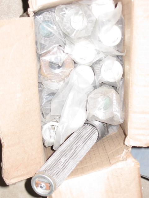

Hi Wayne .. i too have rebuilt many cylinders, the majority on boom/bucket trucks with close mounted holding valve, these are very hard to find internal leaks, the majority will have rod seal leaks long before internal leaks are suspected. We have modified cartridges to help with this problem.
The majority of the cylinders come in with poor lifting power due to the seal leak, some have internal tube noise when being used and some show hot spots on the cylinder tube where the fluid has been leaking by for a while.
Yes i have rebuilt non-holding valve cylinders that drift and the problem goes away, but this doesn't mean that the valve bank wasn't leaking. If the seals are leaking and no valve leak, no drift. if the seals are not leaking and the pressurized side of the valve is, drift. If the seals are leaking and the unpressurized side of the valve is leaking, drift.
hydraulic repair is a black art and if the pot is stirred enough then it's amazing to see just what floats to the top!!!
As far as suction filters we have boxes of them out of new lifts, want some... If you start with a clean system, use a GOOD return filter with a GOOD beta rating and maintain it, then a 100 mesh or large micron suction filter is restriction i can live without. Jim
