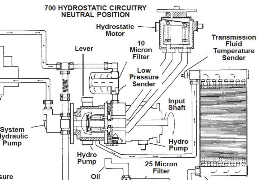

Yeah I bought a basket case and I figured just about every could go wrong. So before I buy the Repower Specialist kit, I need to determine what was the engine rotation and does the drive system work. I guess the engine could be a clockwise or counter-clockwise rotation. I was thinking taking the tires off and rotating the input shaft with a impact driver. Maybe loosen a fitting or two to see if oil is moving in the proper direction. Whats got me worried is the fact that the 720 rolls if you push it. Could be the high pressure relief valves have been removed or maybe it is just low on hydraulic fluid. Just trying to assess the problems before I throw a bunch of money at it. Not normally a lucky guy but I can head off trouble by paying attention.

Still having issues with what is the proper pump shaft direction. Spec sheets show Wisconsin engine as CCW. But that all depends on what side you are on. Found a picture in the service manual and it shows pump rotation as CCW IF you are standing behind the unit. Front (bucket side) it would be CW. So, with direct engine coupling, wouldn't I want a CCW rotation engine (looking from back)?

thats how I see it looking at your diagram

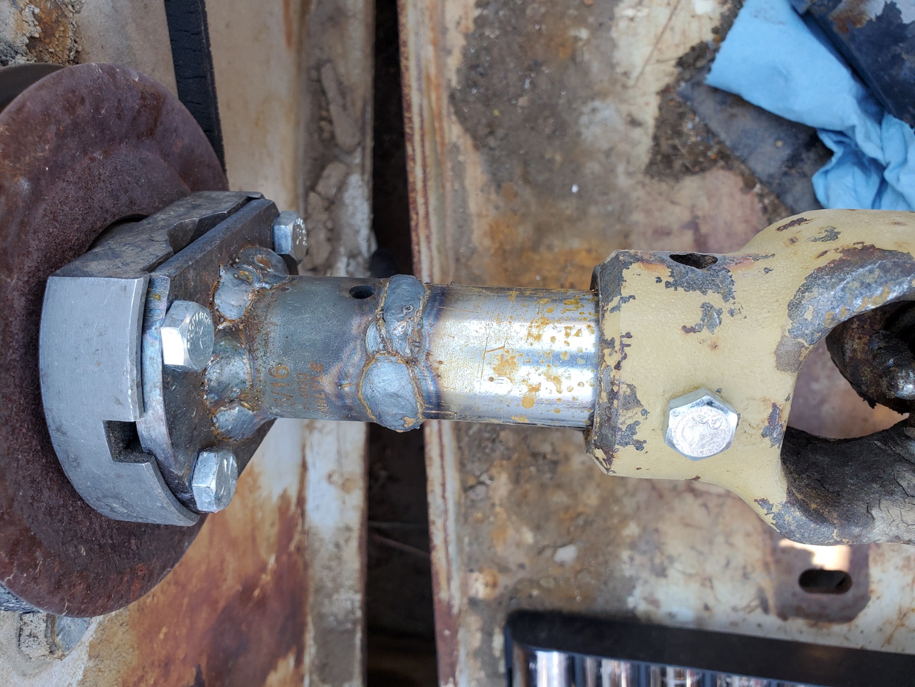

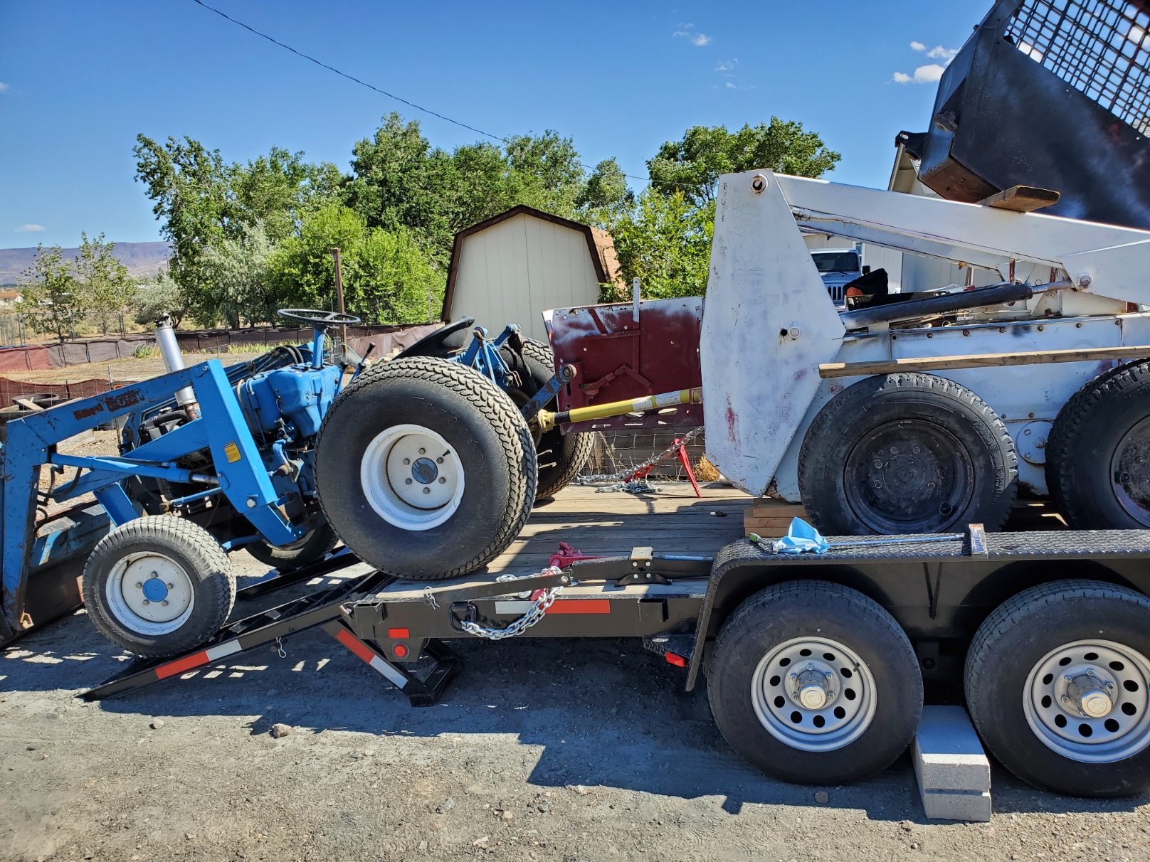

Well, tried the drill and got nuttin. While drilling a few post holes I noticed the pto output rotated the proper direction to drive the pump on the 720. Welded a stub on my adapter and spun it up. Nuttin. Figure the pump lost its prime. Should be able to get to that today or tomorrow. The low pressure hoses on the suction side and oil cooler look pretty punky so I'm sure thats not helping.
