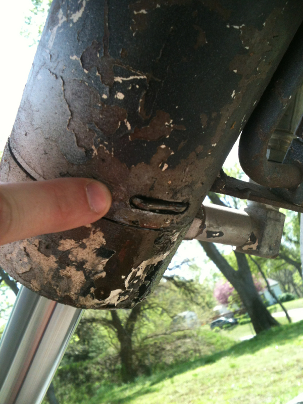

Was using my 85 643 bobcat and my tilt cylinder sprung a leak on the back side by some sort of clip looking thing. What do I do to fix? Pull apart and rebuild or what. Need help fast!!!!!
   / Bobcat 643 cylinder leak
#2
Here's where!
   / Bobcat 643 cylinder leak #3
That is the retainer ring for the cylinder head. Leaking oil from there means you have a seal leaking. Should be able to reseal it with no problem.

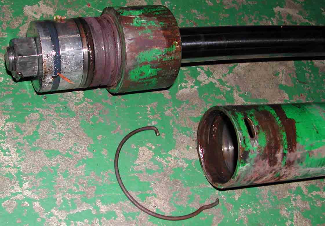

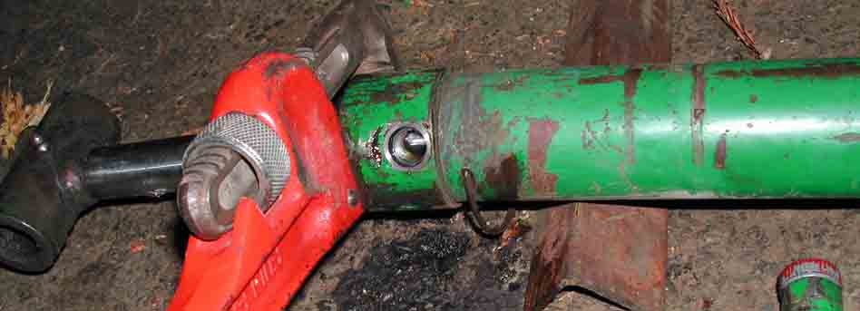

Yeah, there are a few tricks to remove the wire-retained gland:
First, stick a small screwdriver under the the middle of the exposed
piece of wire. This will tell you which end goes into the cylinder, and
which end is free. Use the screw driver to hold the free end up out
of the slot.
Now you are going to rotate the gland (cylinder cap) in the direction
that the free end of the wire points. Do this after removing the hoses,
but not necessarily after removing the whole cylinder. Keeping the
cyl installed on the SS is a good way to hold it. Or, you can use a
vise.
When you rotate the gland, you can use a pipewrench, as I show in
the photo, if you don't care about teeth marks. Or you can use a pin
wrench, or other methods. It will usually not be super hard to turn.
After you rotate the gland about 320 degrees or so, the wire will have
miraculously come out of the slot. When the wire is out, the gland
should come straight off, but you may need to use the rod/piston
as a "slide-hammer".
Go slow and report back.
