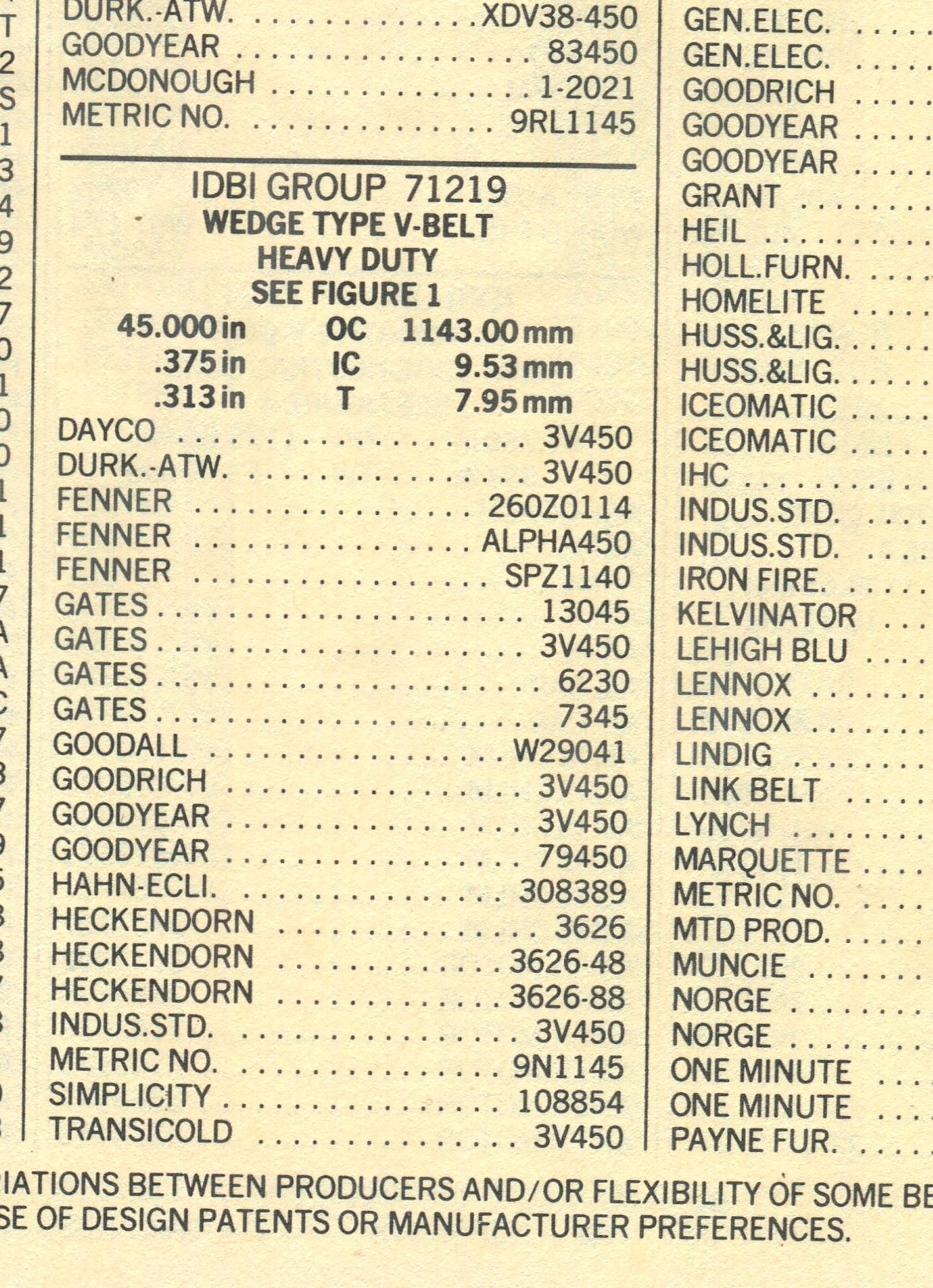

A quick Google search indicates that it crosses to a Gates 7345. Looking that up in my big book of cross reference indicates it's a group 71219.
That gives an extensive list of part numbers that should be available locally. Also Uniroyal 3V450 and Yazoo 205-345 should be on the list, they got lost in the crop.

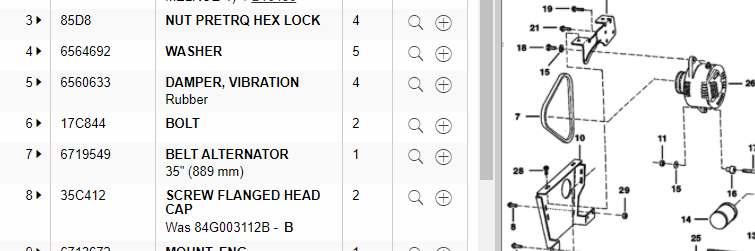

According to Bobcat the belt is 35inch (889mm), but it does not say if that is inside or outside diameter.
   / Bobcat 463 - Alternator Belt Specifications
You are right. I was obviously not paying much attention when I copied the text I received from the local distributor.
