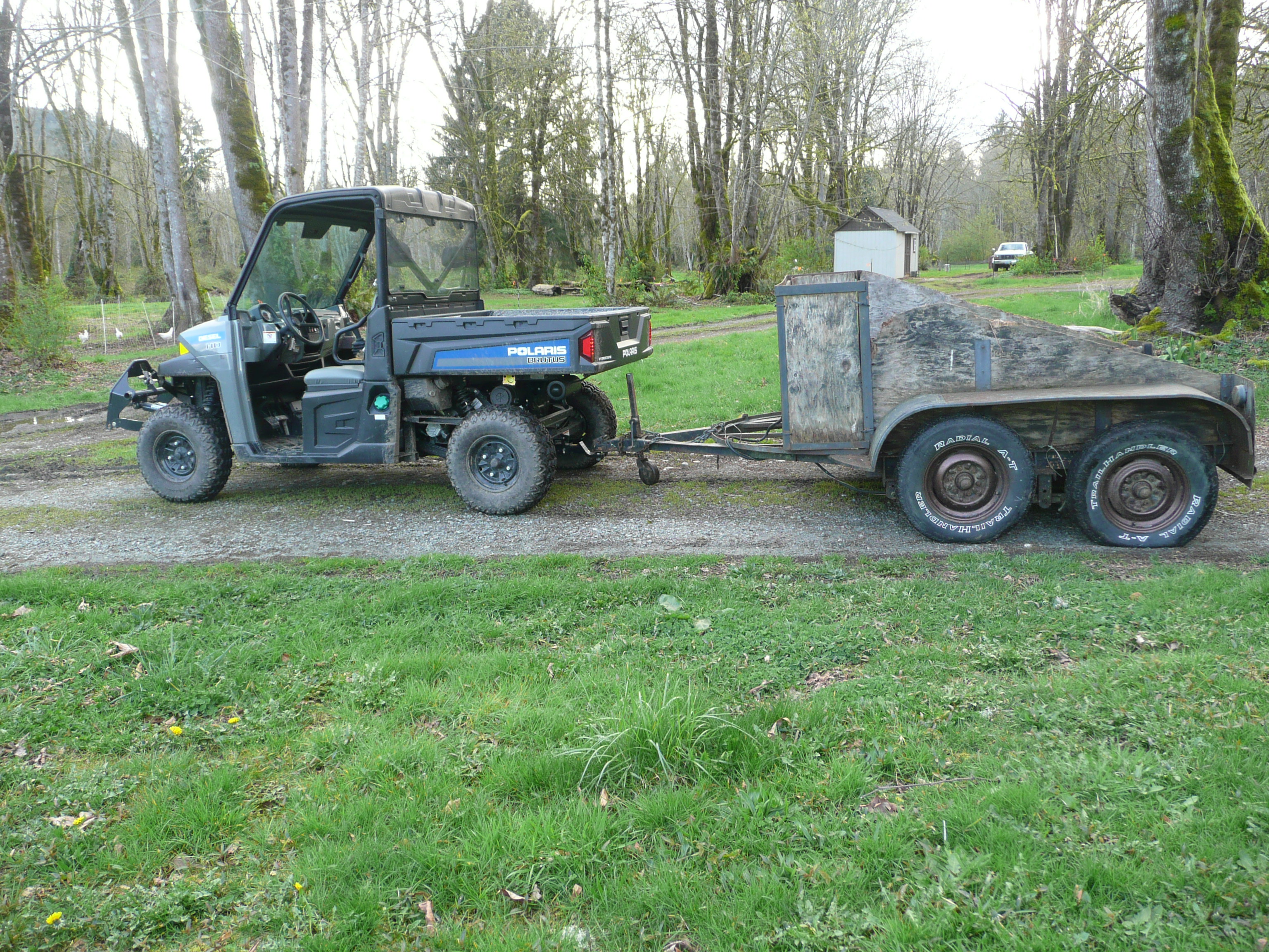

I have a picture around of a crate of wood in the back of my Brutus (chainsaws and all the fixings from an outing cutting firewood). It was a load that no other UTV would likely have been able to handle (and move around on rough/uneven ground). I've also towed a ton (literally). They're mules, not race horses. HST is no different than on a tractor (as far as performance goes): at 24hp my Brutus IS faster than my 30hp Kubota HST B7800, and about the same as my Kioti NX5510.

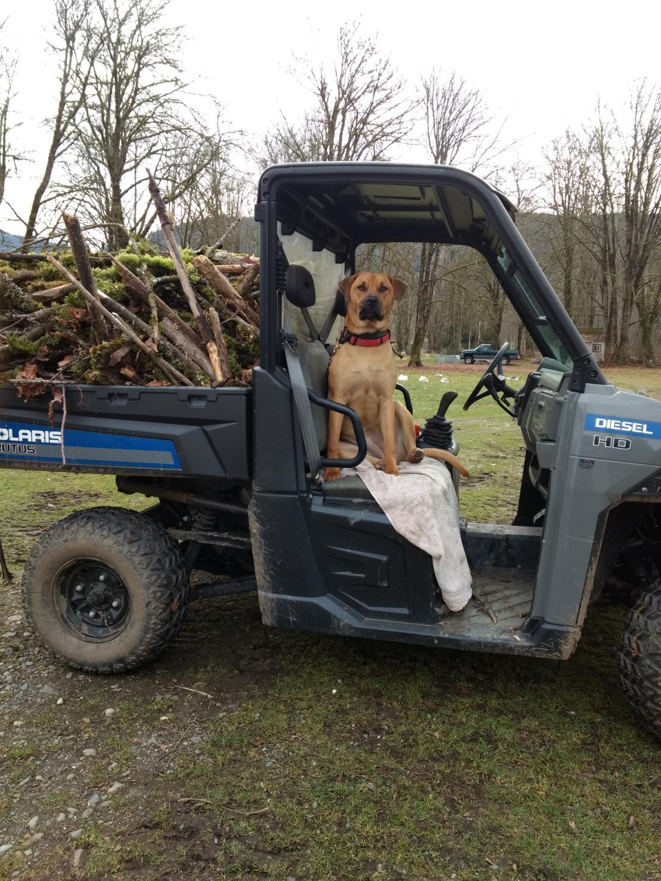

I don't use seatbelts; nor does my dog (so running fast isn't a good idea):
