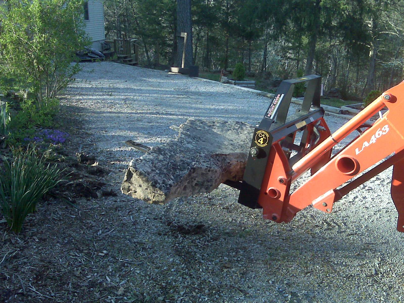

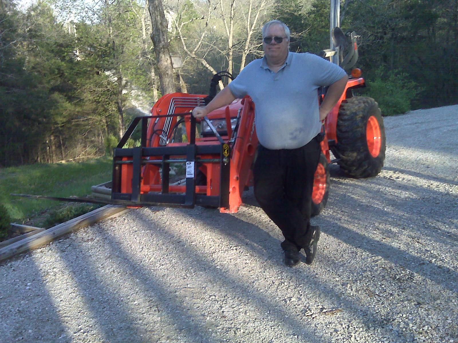

I bought the Construction Attachments Lightweight Compact forks from Everything attachments for my Kubota L3400HST. I really like them. They fit perfectly and work great.
James K0UA
Yeah, I saw those. They look good. Nice and light, too. :thumbsup:
