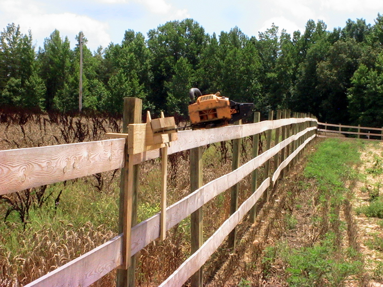

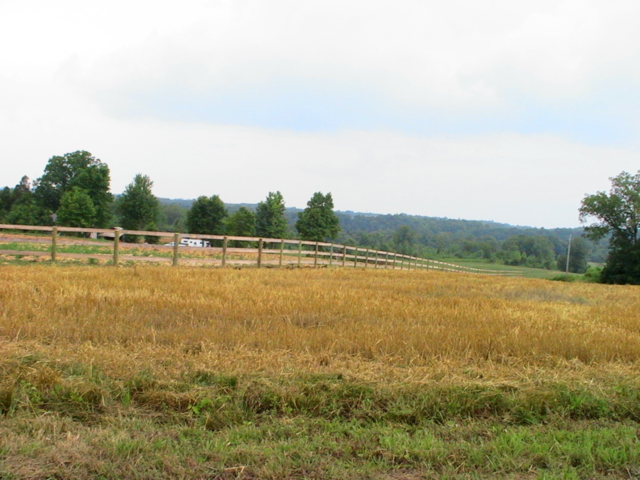

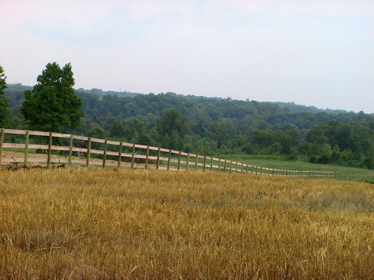

This is pretty much what I did for my horse fence, though I used 1x6x16 pine instead of oak. However, the half-round posts I used were 6-7" x 8'. If Cobra really used 12-14" PT half-round posts, those would be absolutely enormous and way, way, way overkill, not to mention incredibly heavy.
Somebody already mentioned this, but the really "purdy" fences are usually made of vinyl (or solid gold or platinum coated in vinyl judging by the price).

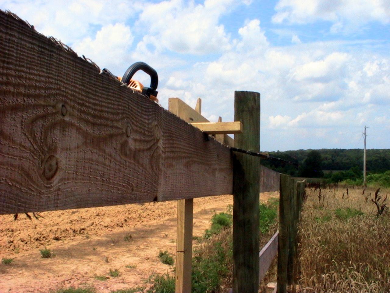

If you go the wood route, here's a quick-and-dirty contraption I made to hold my chainsaw at a consistent angle to cut off the tops of the posts. It clamps onto the middle of the saw bar and slides along the top rail of the fence.

Interesting "contraption", Josh.:D I've never seen that done. And a nice looking fence, too.

You are right - they were mostly 6-8" some maybe 10" max in diameter. I know most were too big for a 6" auger and 9" was even tight sometimes. Some of the ones that were larger in the butt end had a pretty significant taper to them.
Handy contraption for getting the angle consistent. Doesn't look like it would be that much more involved to make one that sits on the other side of the fence so your saw is angled upwards. Having just trimmed a bunch by hand I know it made a big difference for me to be on the other side of the fence cutting up instead of down - you aren't reaching as high. Only seems like a few inches of difference but the different angle wears you out quicker.

You're totally right about angling up rather than down. It was a major pain reaching up that high in the air. Much easier than free-handing it though!

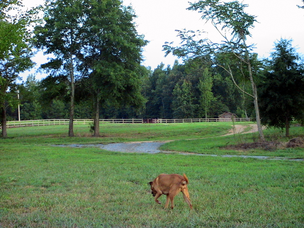

I used PT some 20 years ago. I leave the post higher than the top board for driving the post back down from frost heave, when needed. I also used those purty aluminum post caps. I would leave enough room under the bottom broad for a push mower to fit easily. My wife made the lookout guy.

Gizmo that's the type I'm looking to build when I get the funds.
