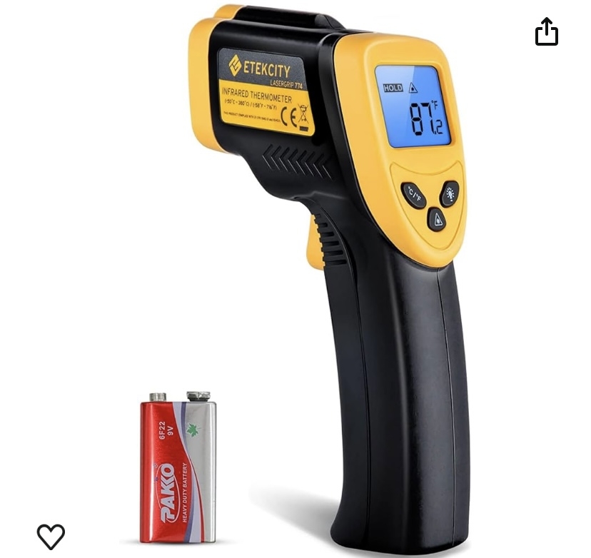

The best time to find the cause would’ve been immediately after shutting it down. Infrared temperature guns are very cheap now, like under $20 if you don’t need high accuracy. When it’s running or after it’s stopped scan everything and look for something hot enough to cause smoke.
If you don’t have one, also great for checking tires, wheel bearings, motors, electrical etc.
As already mentioned, what did it smell like? Only 3 possibilities really; oil, grease or electrical.

Great suggestion ! I've got one of those that I use in the kitchen. As for smell, there's a lot of competition in the barn. Didn't notice anything memorable. Thin smoke that I feared would thicken. Will take another try, better instrumented and prepared for quick response. Noticed that tractor consumed a lot of diesel running stationary under high generator load.
