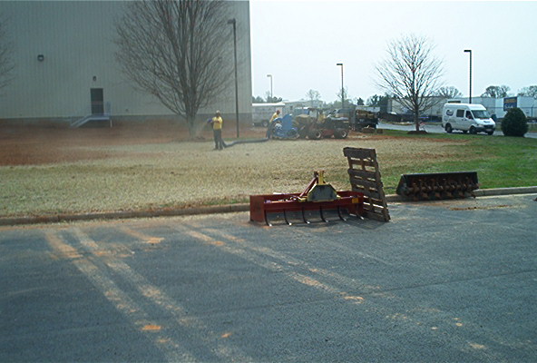

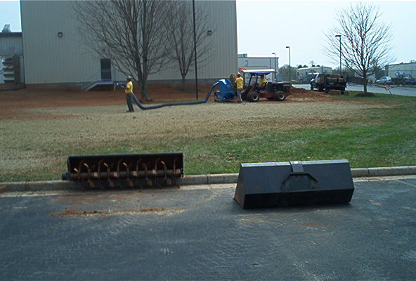

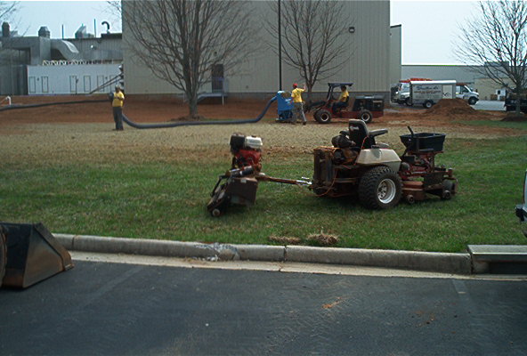

Here is a very cool use for the homemade forks I have. Gas powered straw blower mounted on a pallet, carried around on the pt. We can cover about 30k Sqft in an hour. :D

I'll probably never use a power rake again.
1. finish grade with box blade.
2. deep till with reverse rot. tiller,
3. box blade (lightly) to collect rocks, debris.
4. switch to bucket to pick up debris.
5. Aeravate,
6. seed
7.Aeravate again.
8.Blow straw.
9.Fix sprinkler heads torn up, which were not marked.
10. take pics.
:D

Very original attachment ideas, nice to see the PT in a commercial setting and paying for itself. I will be using mine more and more as time goes on, for commercial use as my business grows. I already have a few small landscaping jobs lined up, I know the PT will make it much easier to deal with. :) On top of that since most people have never seen a PT, I feel it will help give a unique look to my business in the residential sector. Keep the pictures coming.

I've had cars stop in the road and watch me mow banksides!
