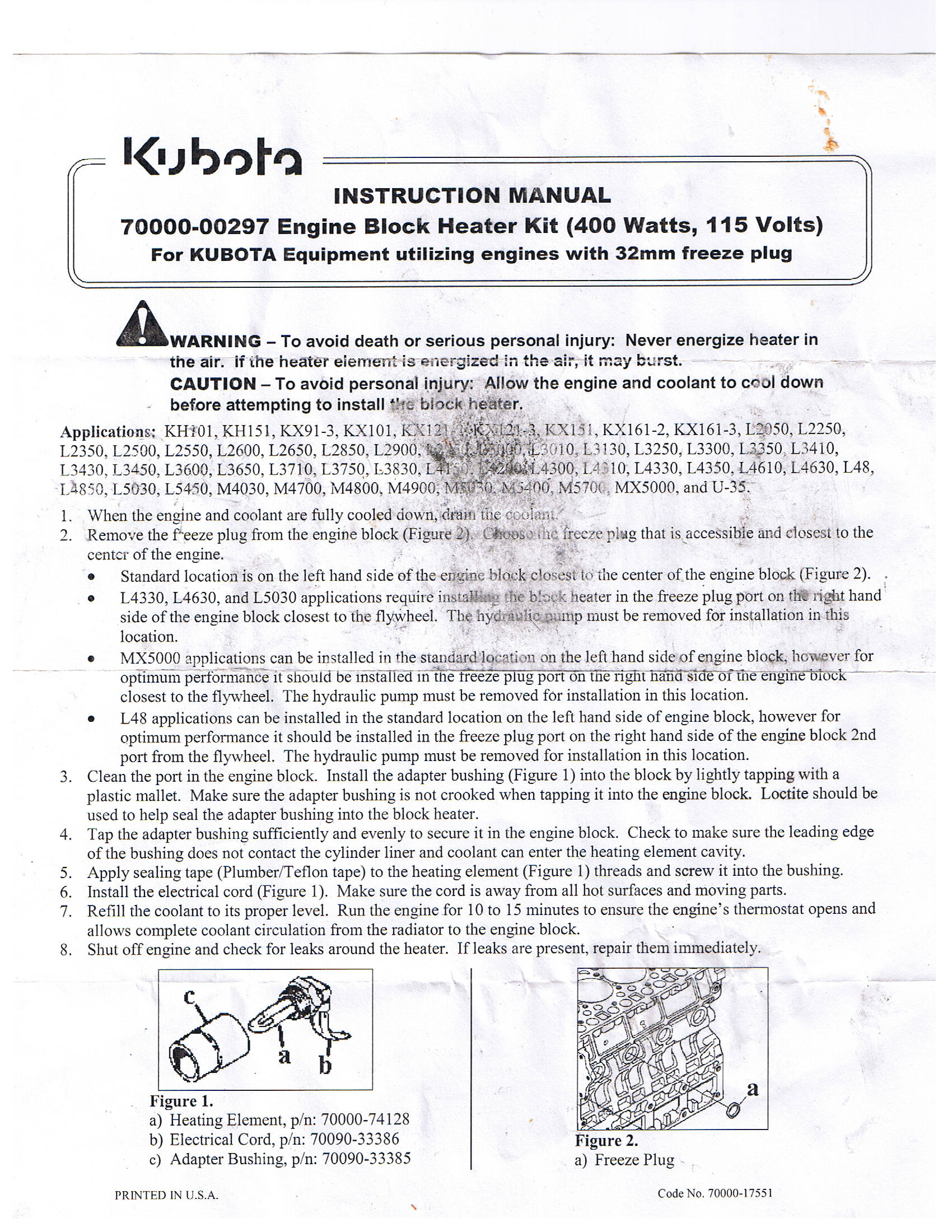

I just found a set of instructions I copied when I installed my freeze plug block htr a couple years back. If someone is planning on getting one here is how they are installed so you know in advance. Hope it helps someone................
