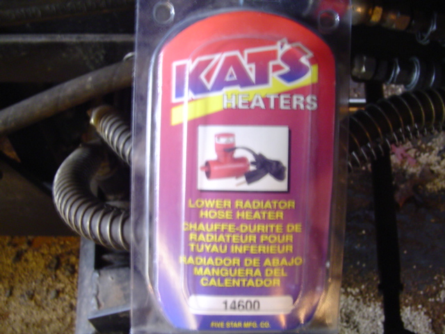

I bought a used 2007 Jinma 284. It has a 3 cylinder diesel. I would like to put a block heater in it. The dealer in Northeastern Washington said that they install a soft plug heater on their units but I'm not sure that's the best way to go. Any suggestions??
   / Block heaters #2
Put in a lower radiator hose heater. I put in a Kats model 14600 in mine and it starts right up at -20 after just being plugged in for a hour. Cost about $25.
Remember though it just heats the engine. Once running you need to let the tractor idle for 15 minutes or so to warm up the hydros and other fluids. Don't forget the diesel fuel anti gel adative also in the winter.
Chris

I did the same thing Diamondpilot did on my jinma 254, no regrets. I started with the magnetic oil pan heaters but was not happy. The lower radiator hose heater works great, picked it up at TSC. I live up in northern NY, and it gets well below -10/-20 for long periods of time.

I will order a lower radiator hose heater and go for it. I do question the hose that is on the tractor now. It looks OK but it has what looks like a armor thread wrap. Maybe I'll replace with a new hose. The tractor had 85 hours on it when I bought it and now it has 106 hours on it.

The hose is 1.5" inside diameter. If you question it I would replace it. Take it into a local auto parts store and find one they have to cut out a piece of. While you are at it do the top one also. I will say though my tractor has 600 hours and still the same hoses and alternator belt.
By the way I got my heater at TSC. Not sure if you have one there but you can also get them online.
