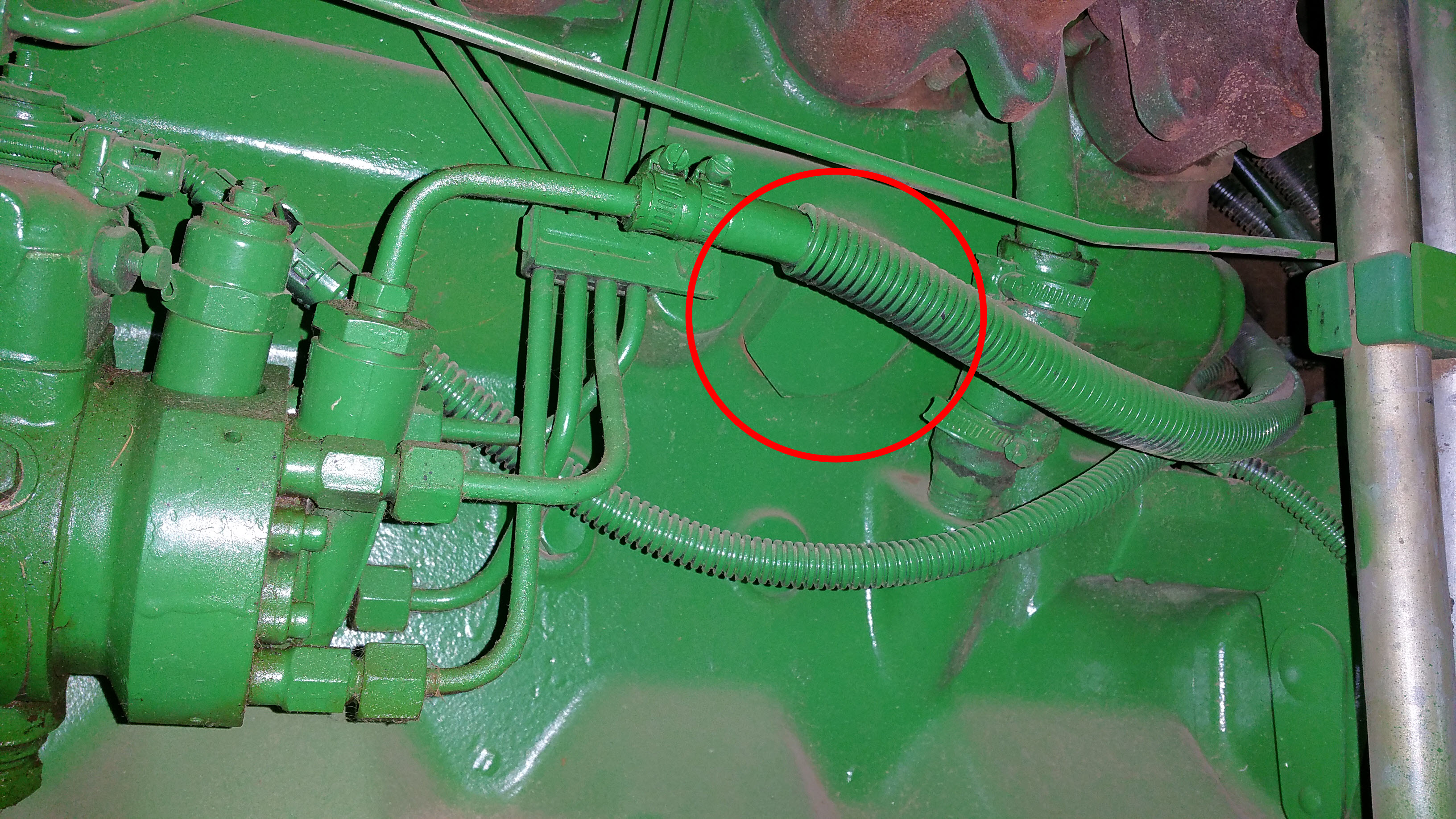

Hi Everyone,
I picked up a JD 6200 a few months ago, and I've been mostly having fun with it until now. The cold weather has brought about the "no start" scenario. Specifically temps < 20F. Between 20 and 30 the start is a little iffy, but less than 20 it's usually a no-go. Sometimes if I hook up to jump from my truck it'll help, but the closer to 0F or even less, the jump start is a no-go as well.
The beast is barned, but the barn is not heated. There are no block heaters installed that I can see. The battery has a mfg sticker showing 7/11 (assuming that's July of 2011).
A few things I'd like to do:
1) new battery -- on order
2) install engine coolant block heater (not sure of correct part number)
3) buy and use a battery maintainer -- on order
Would anyone happen to know of the correct heating element and cord (or kit or assembly) to order, and who sells it? .... besides John Deere? The JD parts and illustration is attached.
Is this the correct plug according to the drawing?

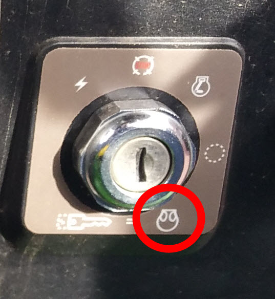

Oh yeah...
I'm not sure if this tractor has glow plugs, and there is no indication or symbols on the dash to indicate that they exist. There is a symbol on the ignition switch that may be it, but I haven't been able to identify it in the manuals. Another pic.... Is this a glow-plug warm up position? It looks a little like a pig-tail, but probably a light bulb.

I would go with a block heater. I would think your local dealer can help you with that.
Looking at the picture you supplied on the switch you need to push the key in for the pre-heater or glow plugs to come on. On my tractor you push the key in when it is in the run position. I do a 10 count let the key out and then start it. I can tell it is working because the lights on the dash dim. The manual also says if after starting if the engine is running rough to push the key in again. Give this a try and see, if it works for you.

Thanks for the ignition key tip; I'll try it out. What you say now makes sense according to the symbols in the picture.

Im not familiar with your model, but I recently went through a similar "upgrade." While I couldn't find a block heater (like whats available for my '05 JD 790) i did find your tractor has a cold weather starting, glow plug option. This may be what you depicted in your original photo: partscatalog.view.servlets.HomePageServlet_Alt?Origin=JDParts#mw_pdp
Again, not familiar with your tractor or accessories but it looks like you've got a coolant/transmission oil pre-heater as an option: John Deere - Parts Catalog
Or, fuel preheat element: John Deere - Parts Catalog

It would be nice to install the other 2 heaters as well as the coolant heater. JD makes a nice harness to incorporate the 3 elements into one plug, but they do like money for their parts.

I attached a page from the 6210 manual on what I was suggesting.
Online manuals for the 6200 are not there, but if you wonder how I got the page here is the site I went to.
John Deere Ag - New Equipment: Technical Publications - Equipment Search
Thanks for this information and how to get to it. I wonder why the info isn't included in the 6200 op manual I have?
