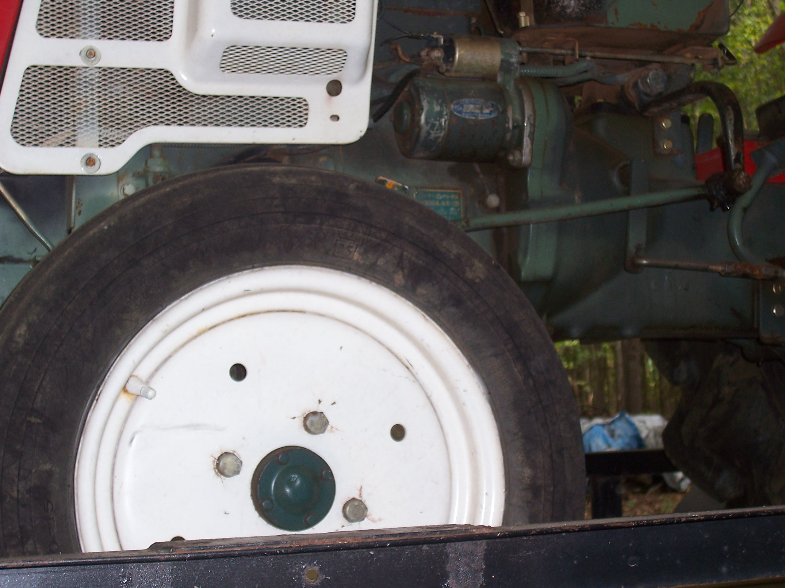

   / Block drain #2
Look and see if it's just under side panel. Drains the radiator and block. Unscrew the bolt at the bottom.

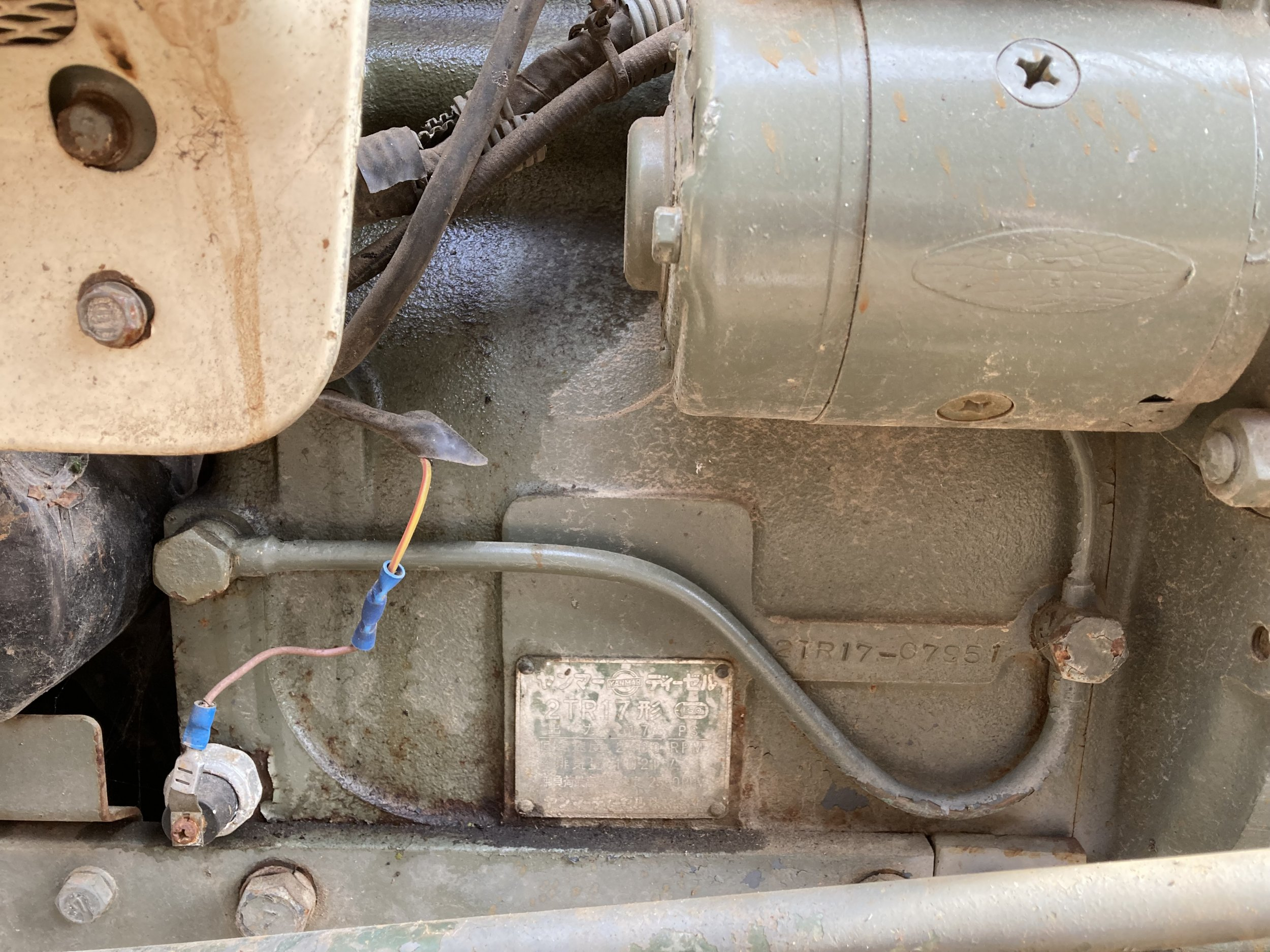

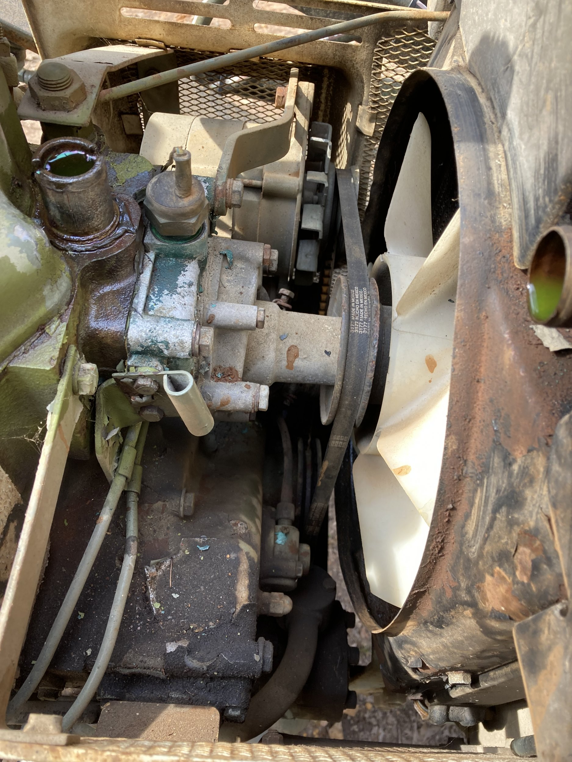

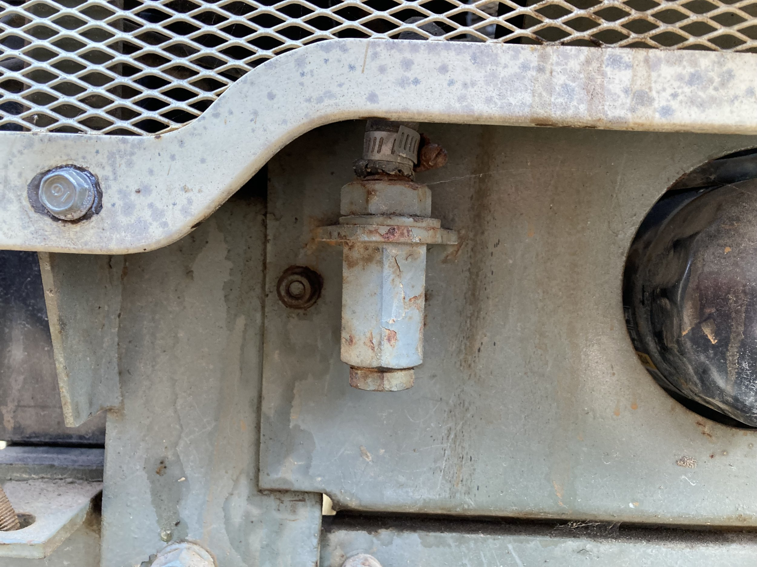

   / Block drain
i did find this and drain it, but only a qt. came out. It did overheat and was shut down fairly quick, i noticed a lil' smell and saw brown water being throwed out of side cover. Didn't notice temp. light either, But i am ordering parts and maybe new radiator from Hoye next wk.. I didn't see two hoses into one before the drain plug, may have to take cover off? What about a flush, will vinegar do or use Preston flush, it had a lot of rusty gunk in btm. of overflow btl.. Seen little on YT.
Thanks jim

   / Block drain #7
That's the drain fitting. Pull the side cover off to verify there's a hose from the block into that fitting, and verify it isn't plugged.
If the first owner just put in ditch water temporarily for the week that he tilled, that block and radiator might have a lot of mud settled to the lowest points.

   / Block drain #9
Finally able to go look and from the Bottom left of the Radiator to the top of the valve. Bottom hose to the Eng. Block. See the hose clamp attached to the outlet of the Block. Just behind the Alt.. Org Radiator for me so if you don't have the outlet there It might have been Rebuilt/Replaced Radiator.

   / Block drain #10
Thanks jim
Vinegar (white) is fully compatible with our old school Yanmars as they were made before the OAT formulas. It's been the main staple for several decades. The Prestone flush would be the 2nd choice or a follow up after the vinegar 1st flushing.
Indeed flush and re-flush. Typical tap water with other impurities lead to this galvanic corrosion in the cooling system. Always use distilled or RO water to refill the cooling system 50/50 with antifreeze. Or just do the Prestone 50/50 pre-mix.
