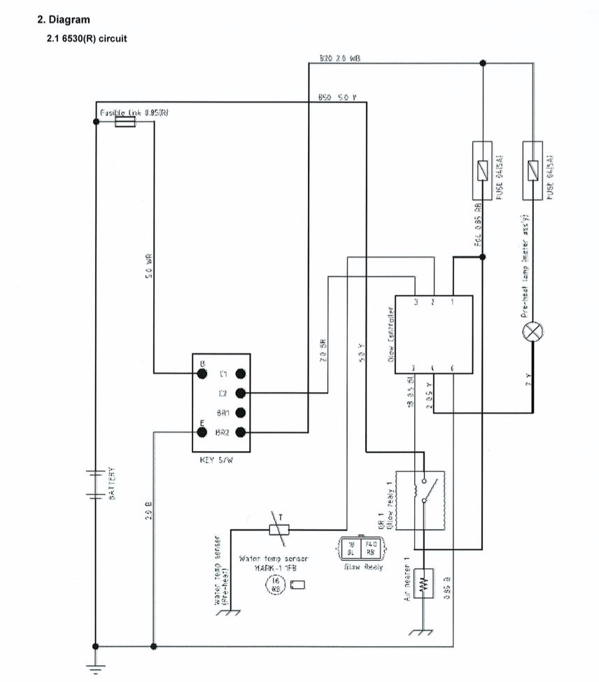

It's just that the thermostat pilot lamp on my Branson 6530 has started to flash after I've been driving it for an hour or so. I don't think it's weather related - it's between about 8C and 18C most days now (in Oz). The manual says it should light up in cold weather when starting which is fine; but says nothing about blinking later. Could it be a warning of some sort?
Anybody got any suggestions please?

I think you mean Thermostart which provides a small flame of hot air into the engine intake when trying to fire up in colder weather for engines that do not have glow plugs.
If you can post a wiring diagram I might be able to make some suggestions.

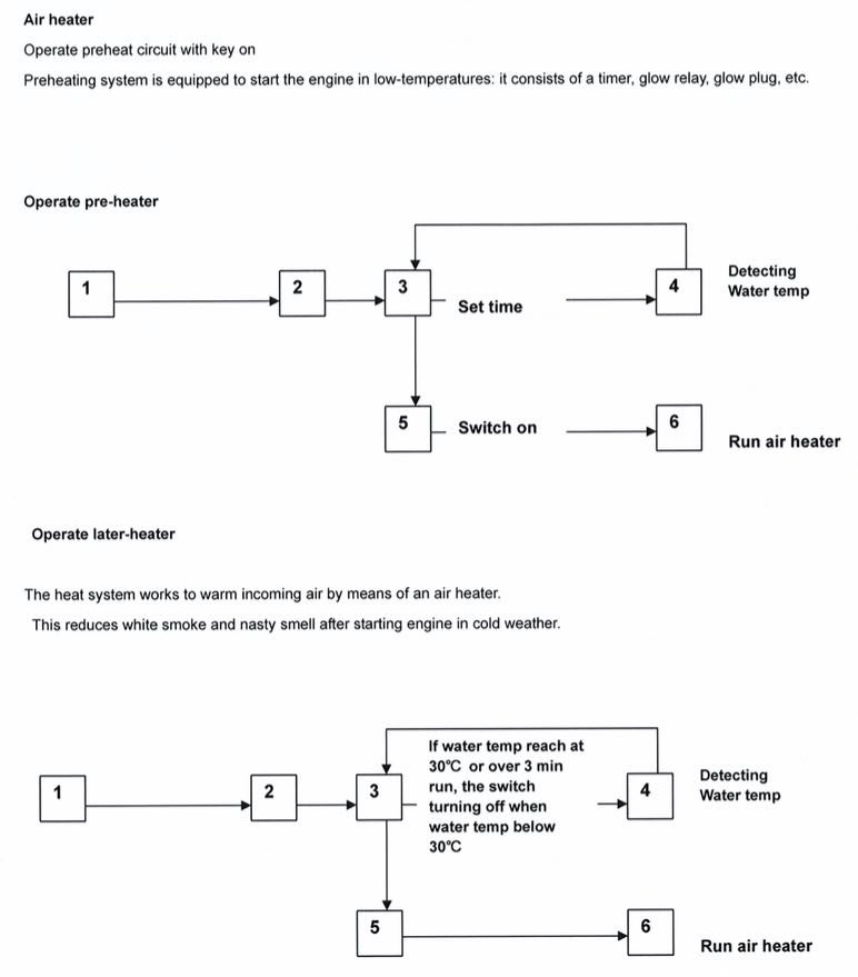

In reply, attached is an extract from the 6530R's Operator's Manual for the the glow plug system which I think covers the thermostat pilot if that's the same as the 'Preheat lamp (meter assembley)' shown on the right of the circuit diagram. Whilst the diagram expands when clicked, unfortunately, my original is quite a low grade picture so the following is as good as it gets.
However, whilst searching for a better copy I did also come across some diagrams (with no real explanation) which suggest that perhaps the hot air blower comes on again - although I wouldn't have thought it gets cold enough here for that. It doesn't specifically say the thermostat pilot light then blinks but maybe that could be part of the answer?

I have printed out and looked over the material you provided. As you note, no explanation of how the system is to work is provided.
The "Glow Controller" seems to be the place where the logic decisions take place.
Can you advise when the pilot lamp also known as the "Pre-heat lamp heater assembly" normally comes on.

My Branson 6530R has a Cummins B3.3 engine - one of the attractions of the brand.
When started from scratch, the key first moves to On, when the Thermostat Pilot Lamp lights up for say 8 seconds in cool weather (also the Charge Pilot Lamp and the other usual ones). Next, when the Thermostat Pilot Lamp goes out, I move the key to Start and the engine fires up ... totally reliable, never failed (- I guess I should touch wood now).
The Thermostat Pilot lamp only started blinking after about an hour's run. I'm next due to use the Branson for a few hours in a few days' time and will then be able to see if it blinks again. Today, for the few minutes it turned over when test starting, there was no blinking. Maybe it is communicating that the air pre-heater has clicked in?

Finding info on the engine glow plug on the Branson web site is next to impossible.
From searching other posts I learned that the temp sensor may be located in the thermostat housing below the thermostat.
Another member said he had had to clean all the terminals in the system to get the light to operate properly.
