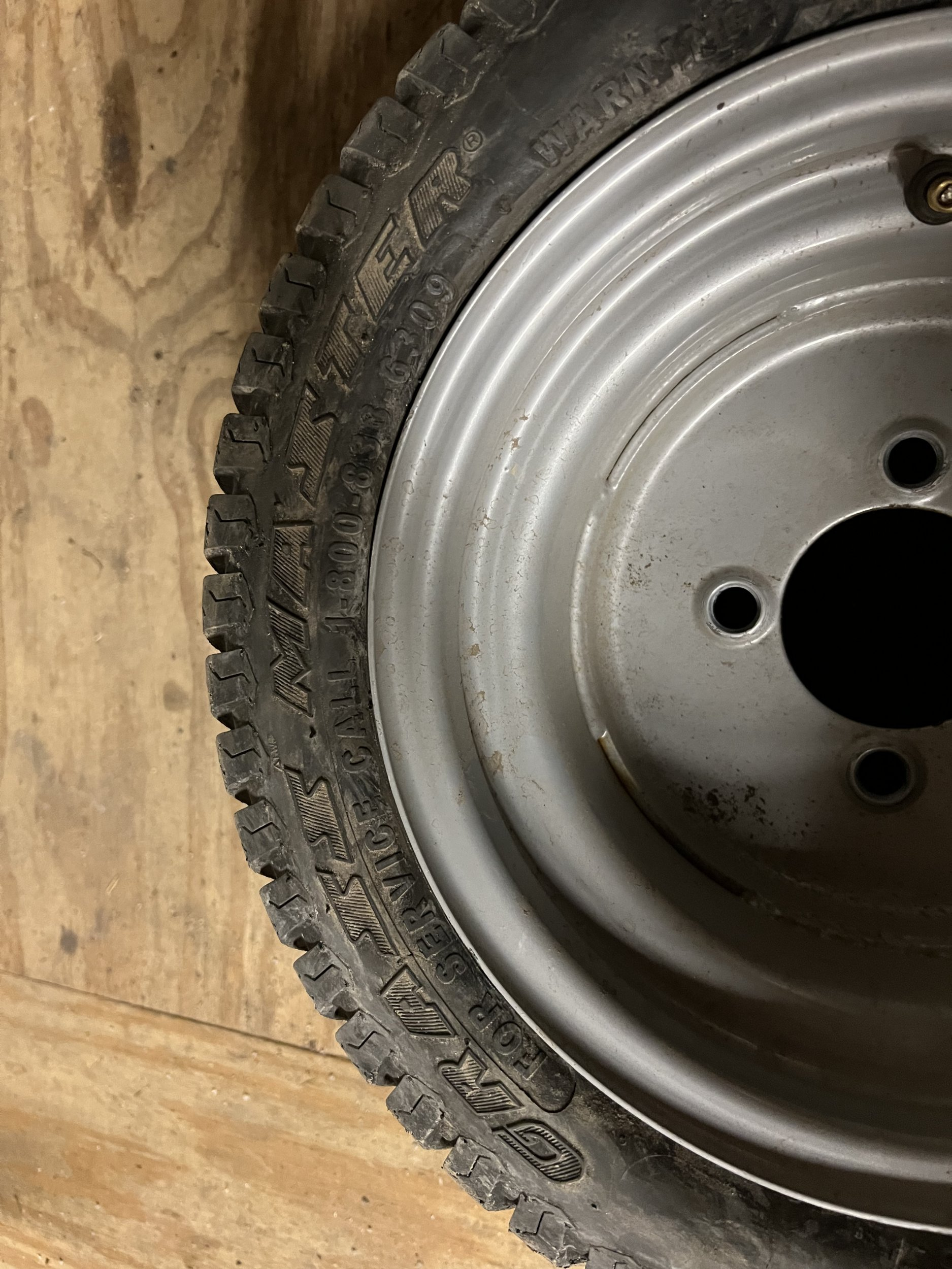

I tried to catch some info on the tire. I’m sure it’s a crappy tire as it’s a factory tire.

On my 4410 I was regularly wreaking turf tires. The tire shop found me a pair of 6 ply rated tires. No problems since.

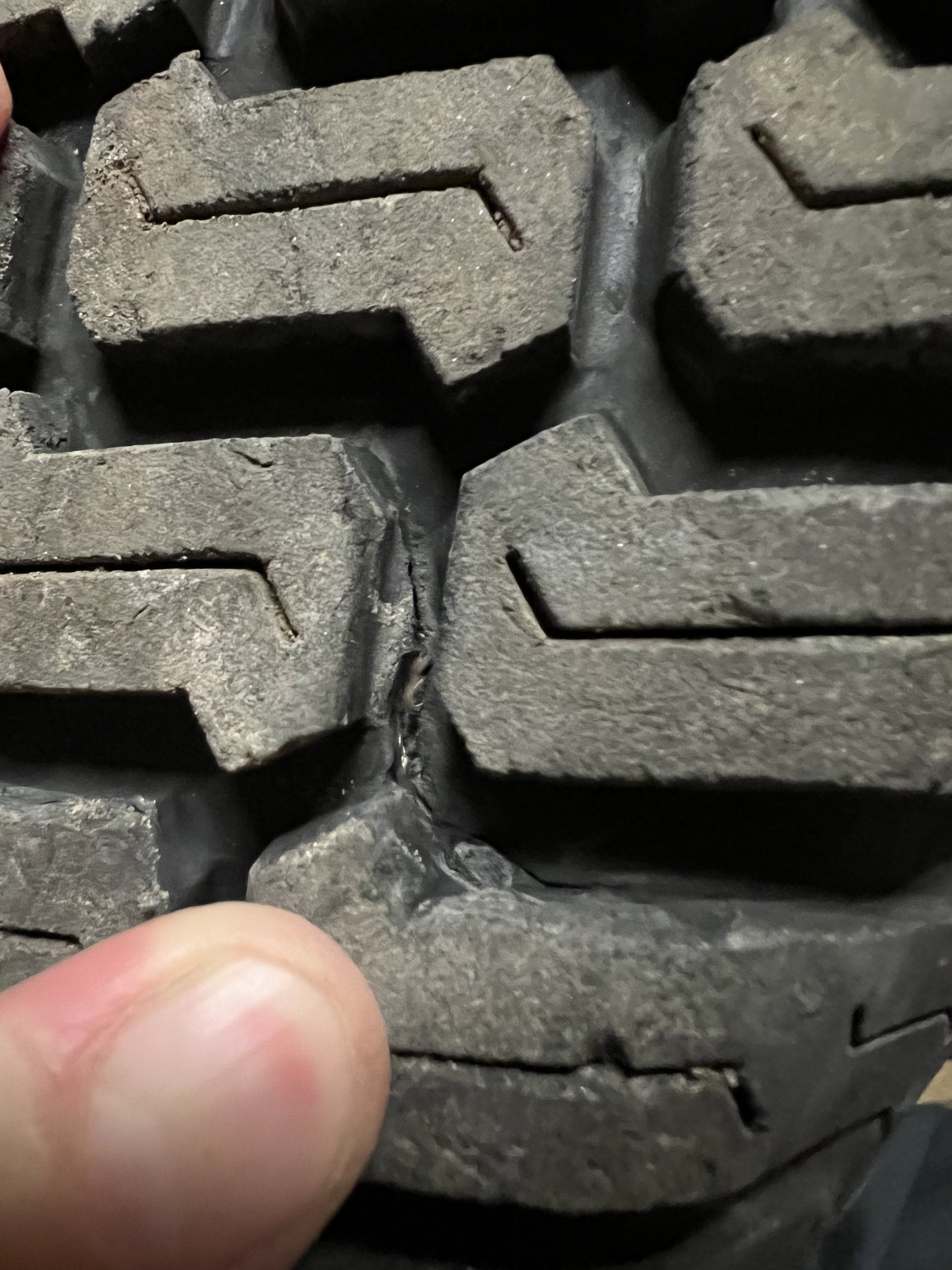

Might be. But the split in the second photo looks to me more like a simple cut from sharp material than it does like a blow out , wear, or defective tire.
But regardless of why the tire got cut, you don't want to go and be changing tire types on a 4wd just because of one failure. One failure doesn't really tell you anything useful.
And its too important to the drive train to stick with the correct front/rear tire ratio. From the photo, there isn't enough wear to make it necessary to be changing both fronts as long as you can get the same replacement tire.
I'd get an exact replacement tire and continue.

I took a pic of the split. It looks like it kjnda got ripped. I see the tire says it’s 4 ply on the side. The machine has 48 hours on it from new. I got it in February. I’ve worked the loader pretty hard.
