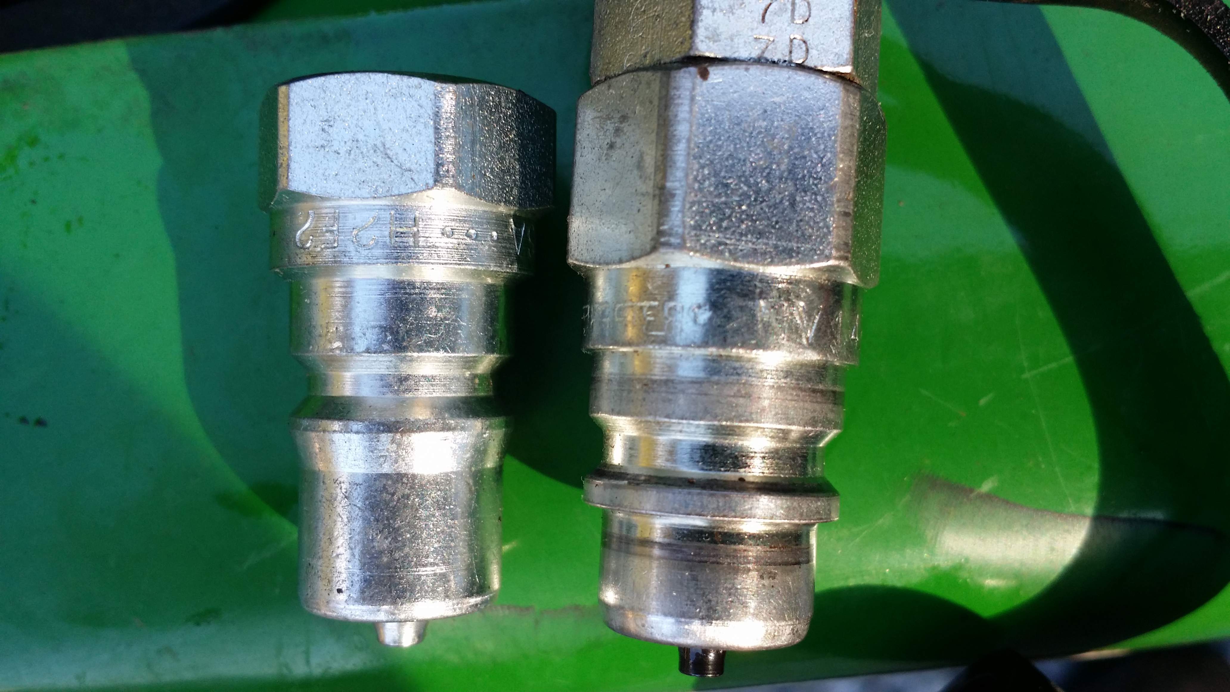

Tried 1/4 inch fittings but they did not fit. Below is a 1/4 inch fitting (which
everyone at the hydraulics shop told me it was) next to the installed fitting.
On the left is a Dixon H2F2, the right is the fitting on the plow.
The other hose has a FM fitting. I assume they are the same type just opposite ***.

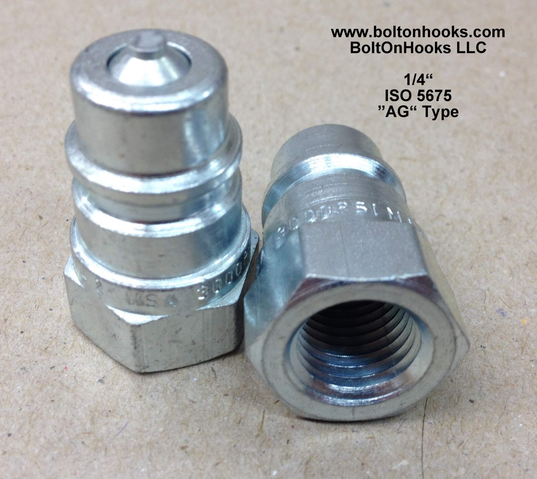

The Dixon H2F2 is an IS7241 "B" type, you can tell by the long snout/tip, I sell them in the 3/8" size, yours appear to be 1/4" size based on a Google Search:
The size hose is irrelevant to this discussion, you only really need 1/4" as I described above.
The one on the right really looks like a ISO5675 "AG" type in 1/4"

Sparc, it's obvious from the side by side pic they're not the same style - you didn't say whether the diameters are the same or not, but regardless they're NOT compatible. I agree with Kenny, best way would be to get more like your other QD's and be done with it... Steve

OK, I guess /I should say that I can certaintly tell that the two fittings are not the same. I knew that before I put them side-by-side. The guy at the shop sayd bring me the hose and I can match it up easy. I said I'm not loading my tractor and plow on the trailer and dragging it over here just for that. I understand the hose size itself is not important, what would matter is what type connection is on the end of the hose. Everyone says 1/4" hose is all I need and I agree this is not a high flow application to just need pressure to operate the two relatively small cylinders and 1/4" should work fine. But then why did Deere use 3/8 hose?
The shop tried to tell me the Dixon H2F2 was what I had. I took the side-by-side photo to show him they were not the same.
