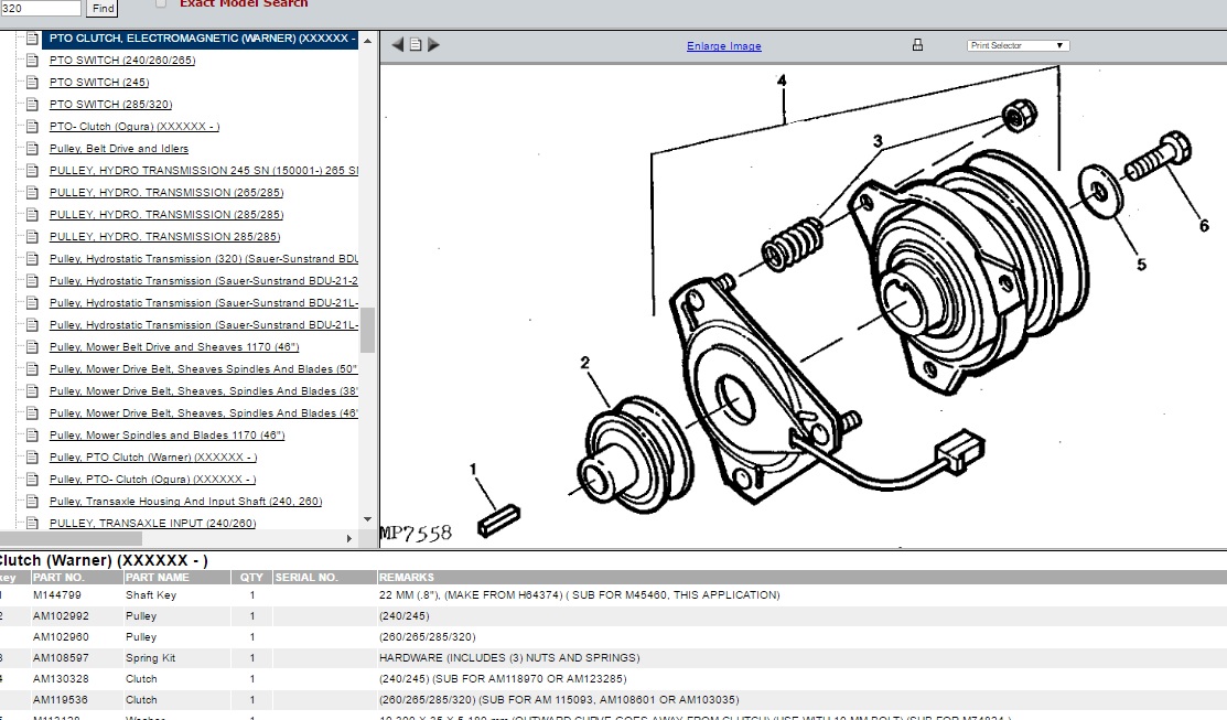

I've already searched the forum and read a few threads, some were never even resolved (or the OP didn't return to share what went wrong) So I'm starting my own with intentions of documenting all results for future reference.
Yesterday my mower blades just stopped turning on when I flip the PTO switch.
Here is what i've done....
I get about 3 ohms when I test the PTO clutch itself....from what the internet says, that means its good.
If I sit on the seat, start the engine and stand up, the mower continues to run. If I sit on the seat engage the PTO and stand up from the seat, the engine shuts off. So I assume the safety switch is functioning properly.
I tried to test the switch with my ohm meter, but there are like 5 prongs/probes/whatever on it and I'm not sure which one is which.....If i sit on the mower, turn the key to the on position, and engage the PTO i distinctively hear the PTO clutch "click" on.
I'm not sure what to do next....I read something about adjusting the airgap or perhaps something mechanical/physical is wrong with the clutch. Please advise :) oh yeah, and, thanks for having me again :D

If your hearing a click with the key on and operator on the seat, I would think it should engage the clutch. I would check the air gap adjustment. Do you have a service manual to guide through the steps?

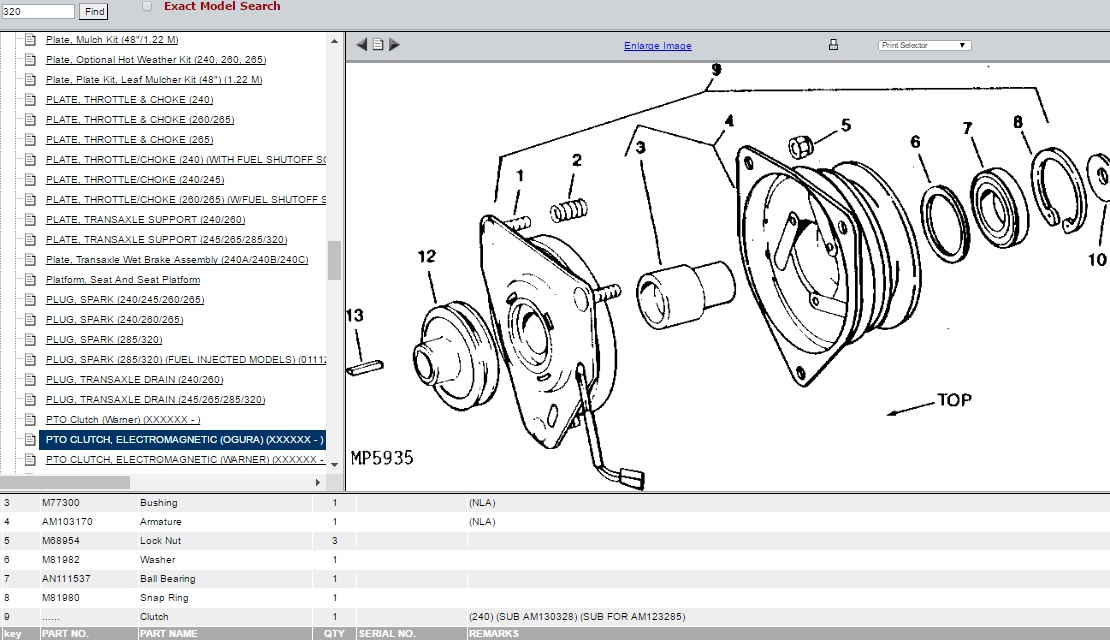

Looks like the 320 will have the Warner clutch. And the s/n with a trip to your Deere dealer for more info may be in order. The smaller models apparently have the Ogura clutch.
Schematics of each..
I have the owners manual, but not the service manual. Would this guide work?

If the procedure you have is for the Warner clutch it should work fine. I have the Ogura clutch and the adjustment procedure is the same. It doesn't matter what machine the clutch is on, the adjustment is specific to that clutch. If adjusting the air gap fixes your issue, try it out under normal running conditions ( engine at operating temp) to see if it holds the clutch engaged, or if you can start and stop the clutch. If it fails again the next step is to disassemble the clutch.
