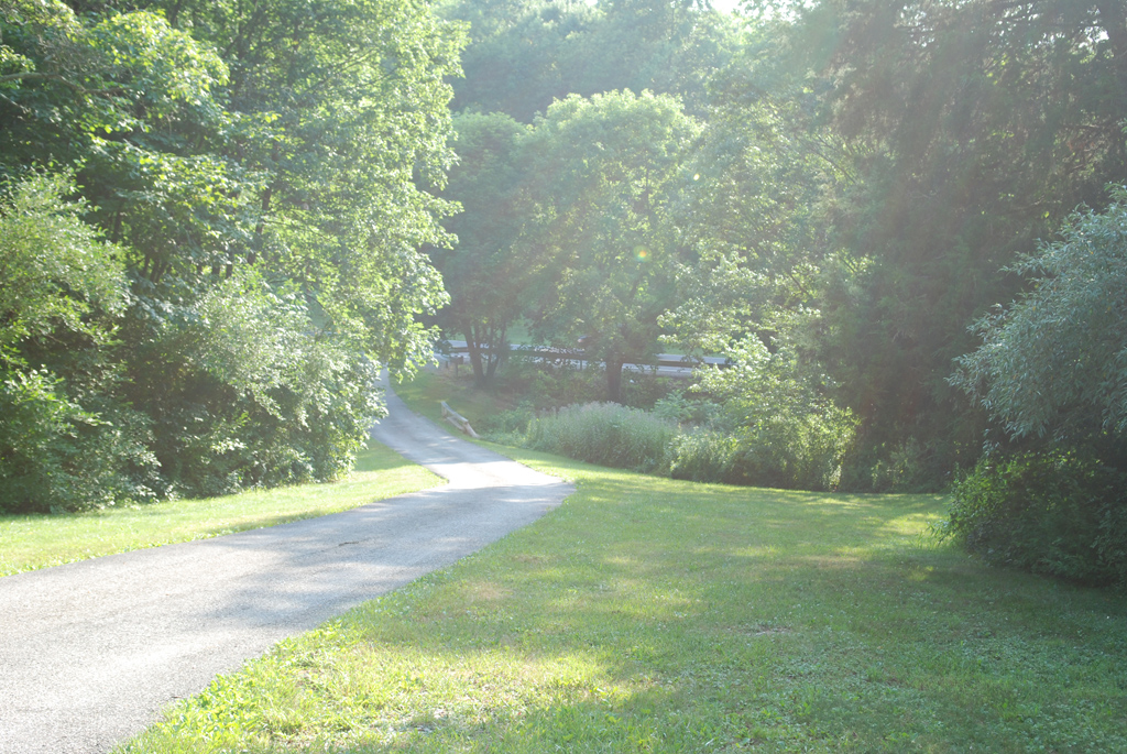

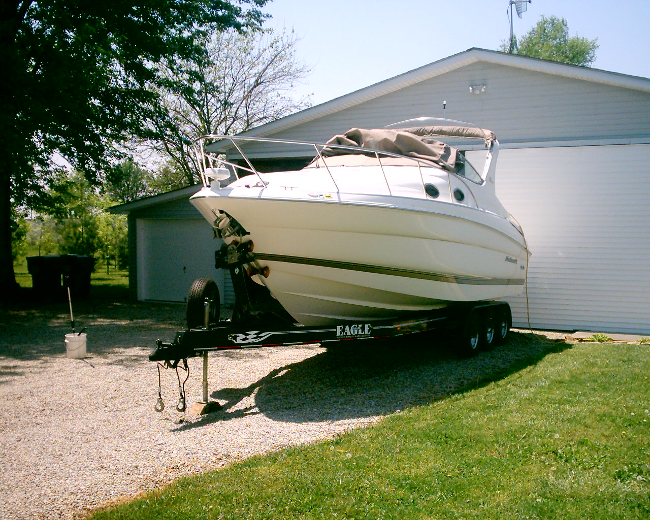

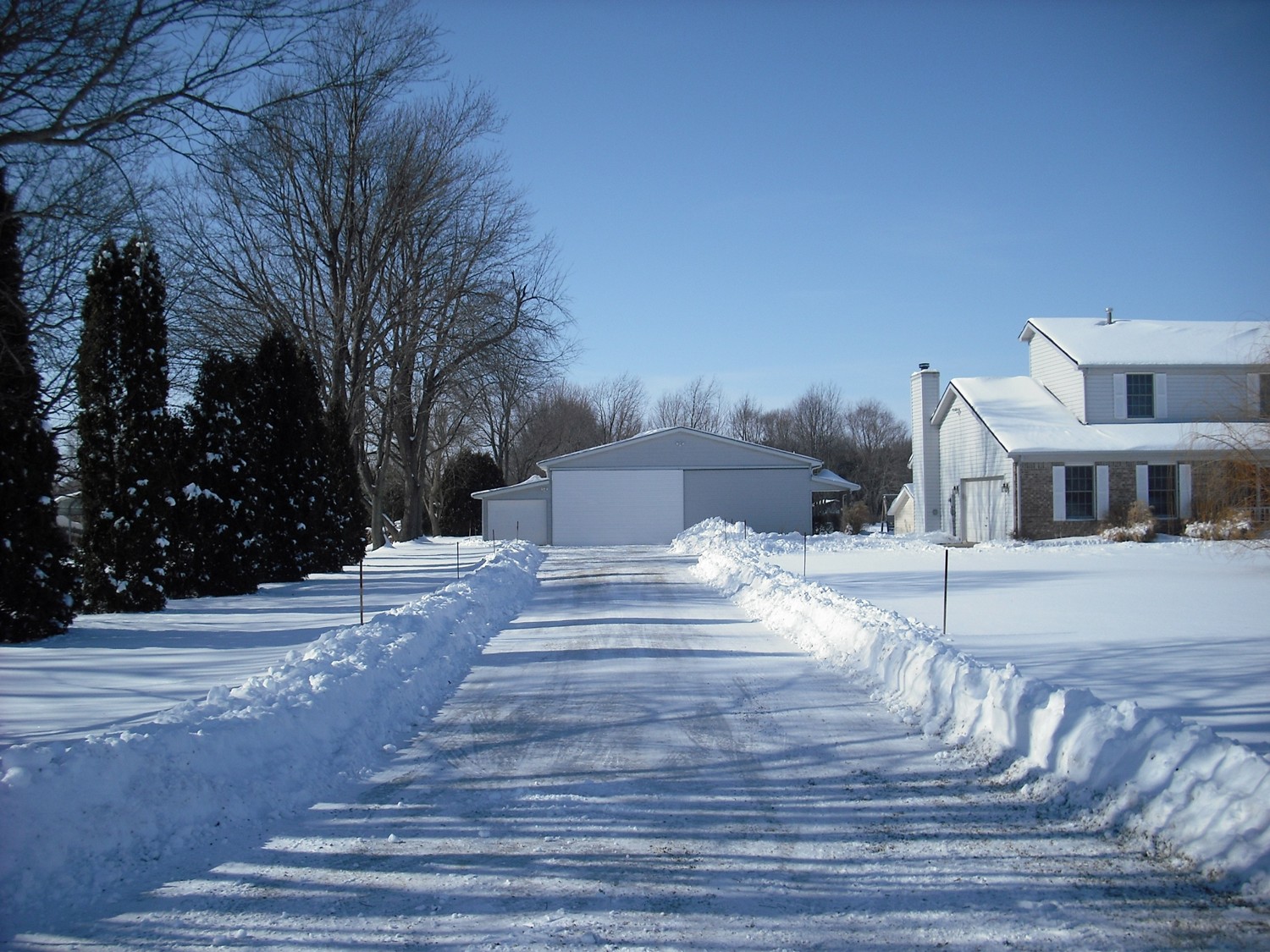

By the way here is a picture of my drive. Its 280' long and is 25' at the road and 40' at the barn. I think its 8,500 SQ FT give or take.
The drive is as wide as the stakes in the snow picture but I only plow X wide to keep the gravel out of my yard.
Chris
