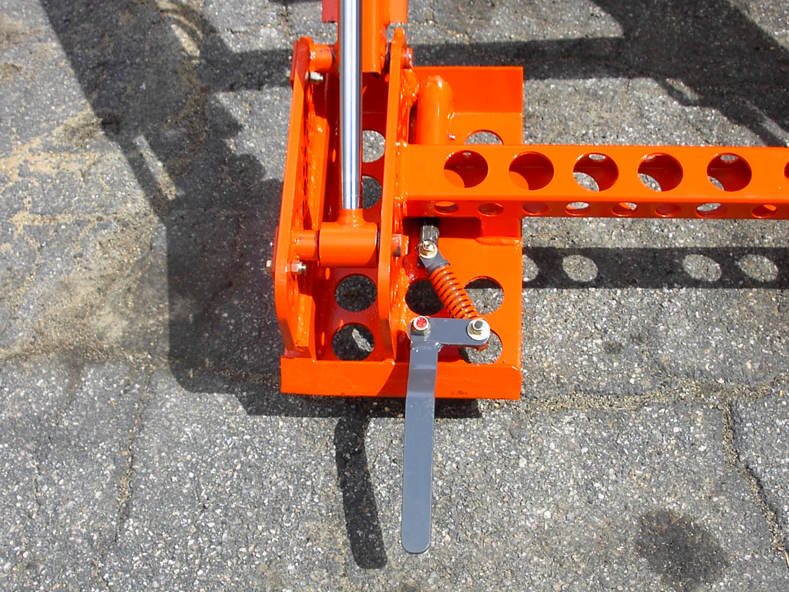

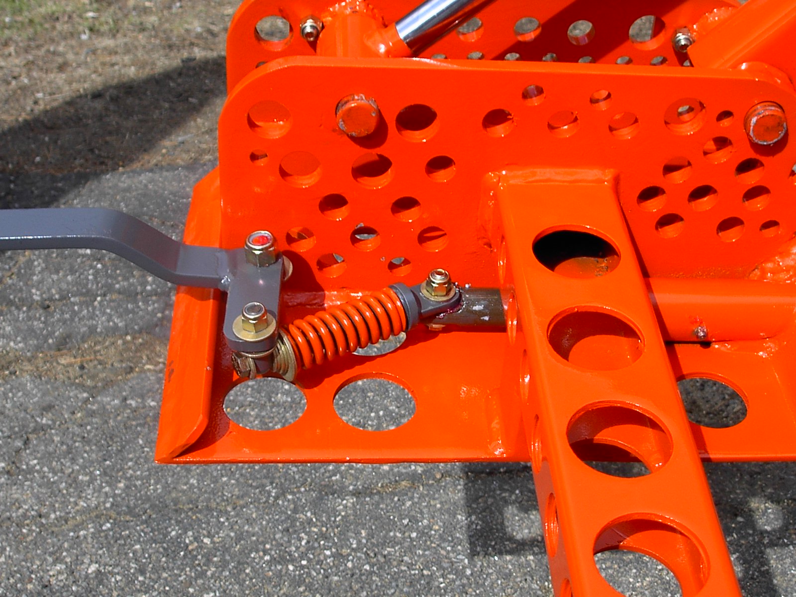

   / Black Bull drill press #4
I bought the floor model at my local store. They knocked it over and dented the belt cover. I beat them down to $125, and honestly, I'm impressed with it considering the price. It drilled / cut holes like nobody's business. Oh...... almost forgot, the laser doesn't work, but I don't care.

Why so many holes especially the cross tube, isn't the cross tube weak enough as it comes from the factory?
I bought a TSC drill press, and it too seems to orbit the bit around the intended hole.
