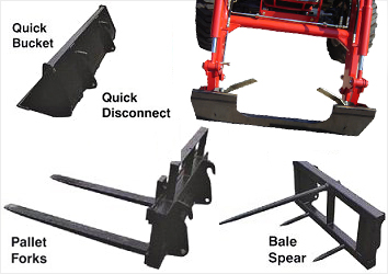

Attached is a picture of the loader's quick disconnect. I got the impression this is compatible with skid steer attachments. Is that right?

The BL10 quick attach is different than the bobcat. The BL10 has a single lever in the middle to throw to hook and unhook to the bucket. At least my 2005 works that way.

I was told by my dealer when I bought my 3510, that any skid steer attachment would hook up to the BL-10S. I took that for true, although I haven't had an opportunity to try it.

BL10S Loaders use a universal skid-steer QA Plate. I've got one, and I just bought a 6' SS utility bucket for it - Fits like a glove. 2-Levers, very smooth.

Score one for Branson :) Thanks for the info.

I have the BL10S with the Skid steer quick disconnect. It has two levers. The Branson 10A QD has ONE lever. You can get either type but have to specify when ordering. I felt the Skid Steer option was better due to more items available and you can get it anywhere.

See, ya never get too old to learn something new. I had no idea that they offered that now. Sure wish they had that option available when I got my tractor.
