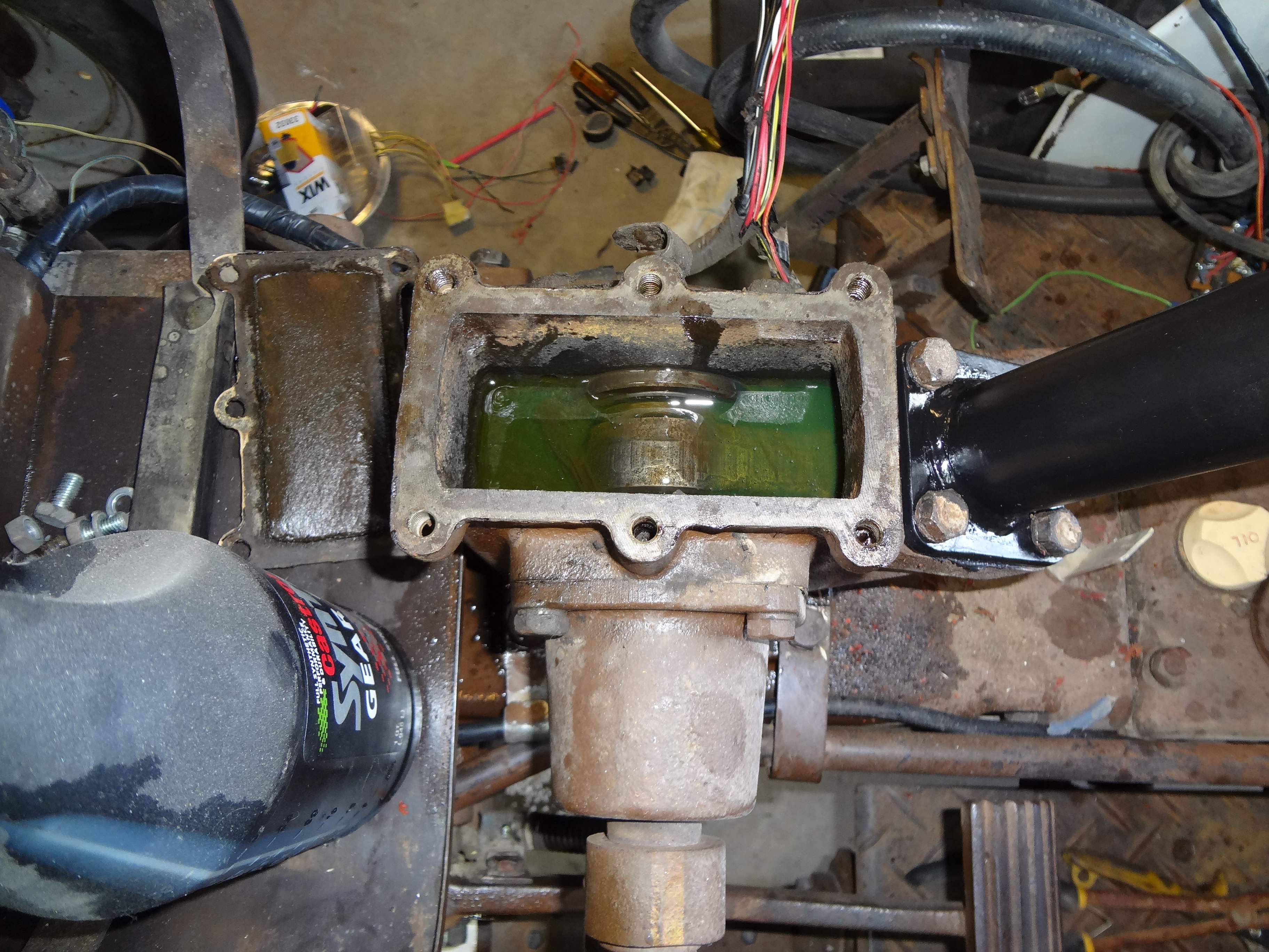

Well while waiting for the water pump i figured i should check out the steering box.
First visual inspection the oil appeared nice and clean......But come to find out it was 1/2 of
oil on 3 inches of water. Plus the upper rubber bushing in the column was worn making the
steering wheel slop side to side some,and up and down. The bearings and gears all survived
there water bath just needed a good cleaning and reassembly. I added a .005 shim on the upper sector shaft race to tighten it's bearings a bit. On the upper steering column

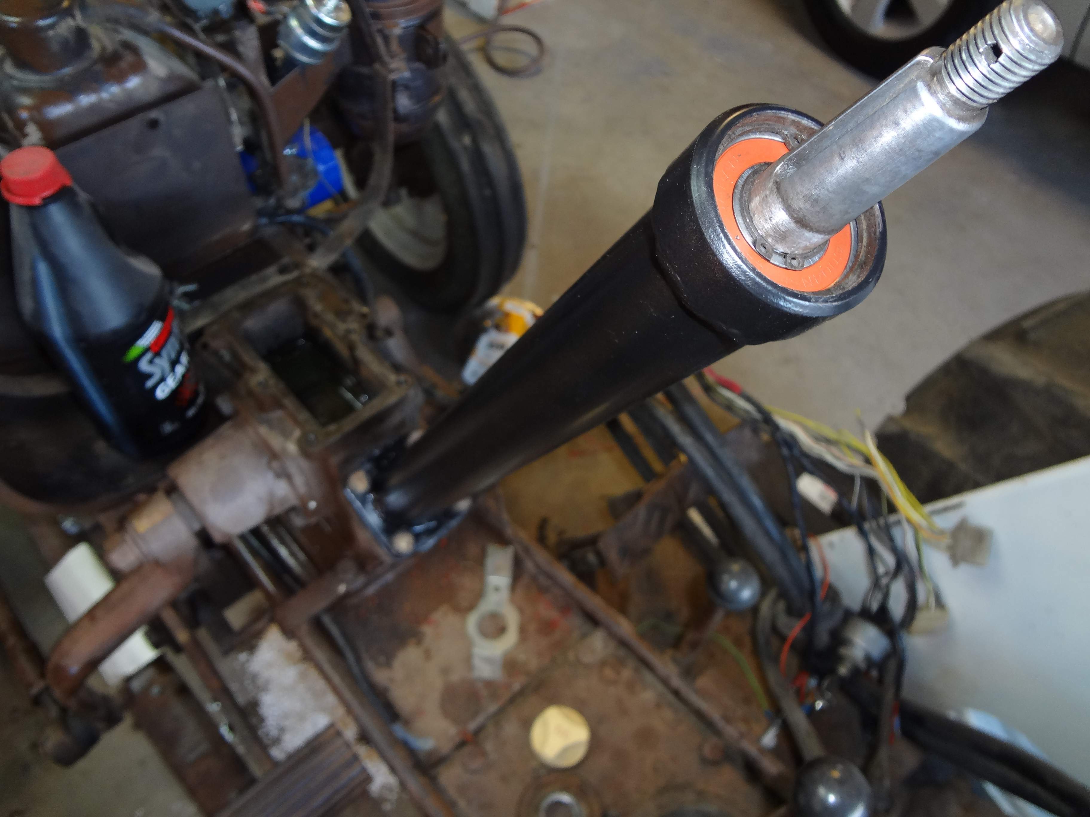

I decided to use a sealed bearing instead of a rubber bushing. 42mm OD 20mm ID 12mm thick
was a perfect fit and took all vertical and horizontal movement out of the steering wheel and
rotates smooth as silk. Glad I checked into this and have it finished so I can move on since the water pump came today.
The new steering shaft bearing

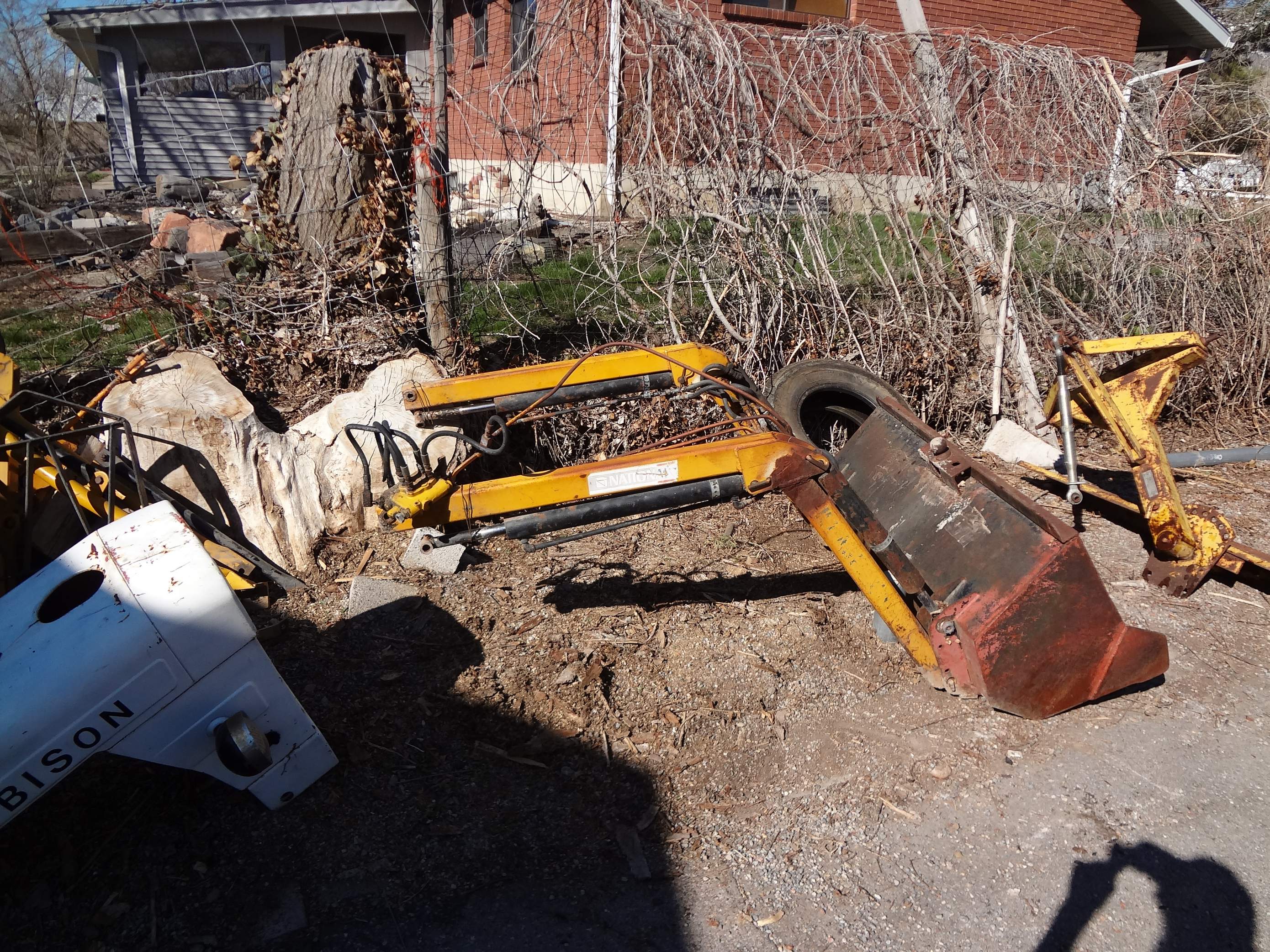

Who made the loader for that Bison? Kind of reminds me of the Blackhawk on my Beaver.
/ Bison in a box
It's a National loader. Got my new hydro lines for it today. Also got all my sheet metal back from
getting powdercoated. Shes gonna be purdy.:thumbsup:
Lee
/ Bison in a box #8
Interesting on the loader.
They are connected it seems. "Black Hawk" is a name that appears on my loader and hoe. However the manuals have Johnson "Work Horse" on them. Bottom of each manual references the ARPS division of Chromalloy. Your loader was built by Johnson Hydraulics of MN who was purchased by ARPS.
So they are from the same company.
Found a brochure on eBay too. 1967 National Loader Model 16 for Satoh S650 Tractor Brochure MX5088 4Z8N2U | eBay

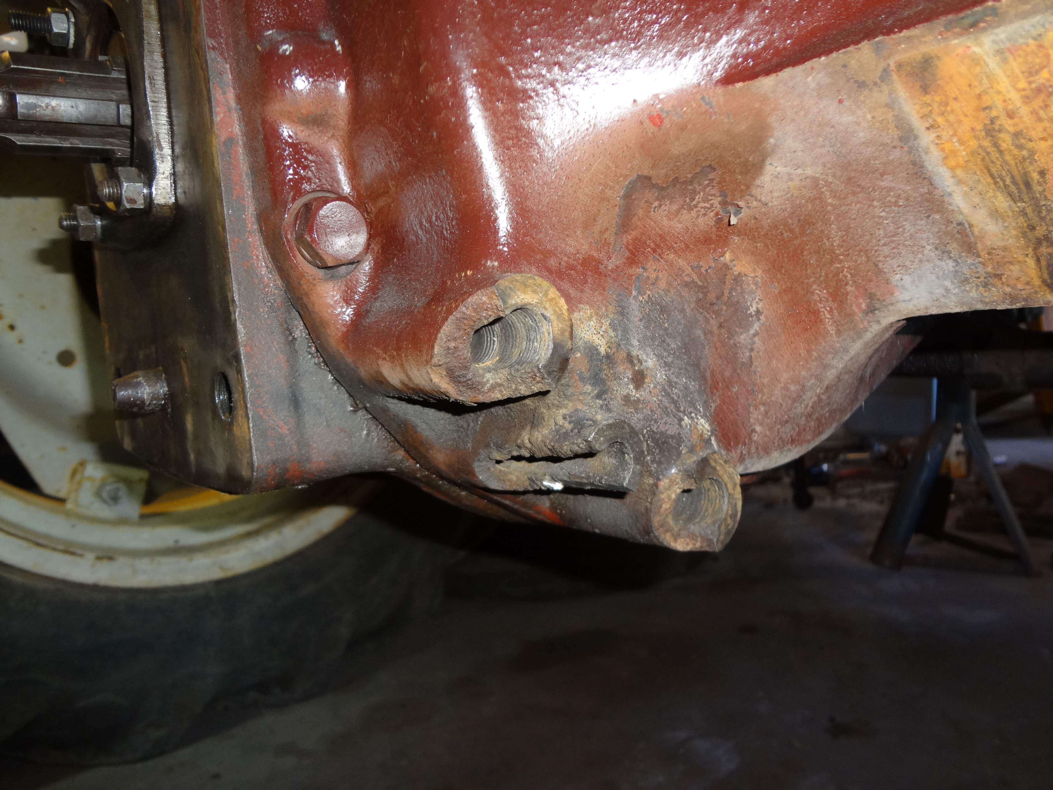

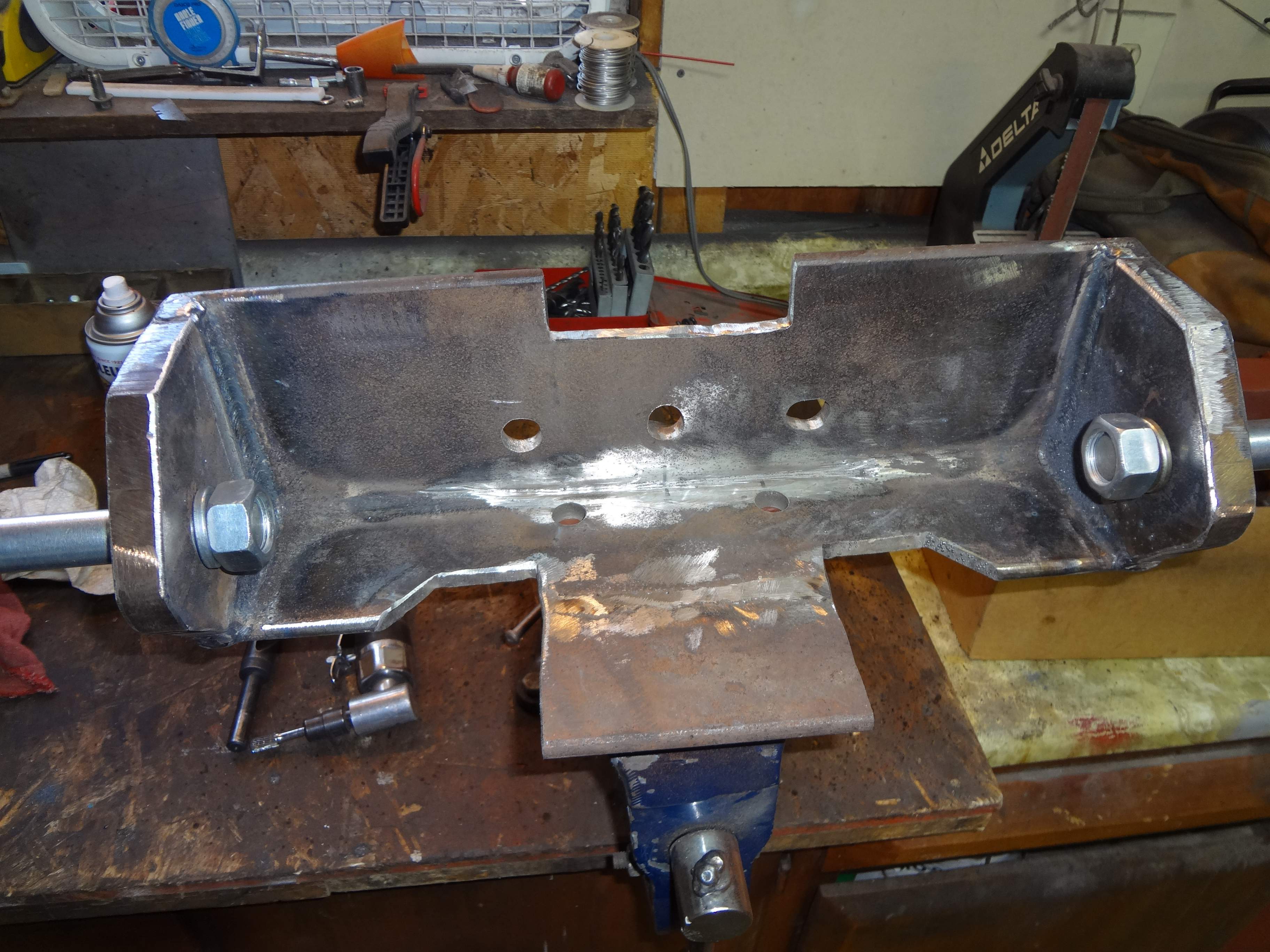

Well I found a serious problem with the Bison.
The 3 point hitch mounting pins had been ripped out of the cast iron mounting,cracking the castings.
Then somewhere some one attempted to fix it. Welding bolts to cast iron is never a strong option.
And his welding skills were below 7th grade level anyway.

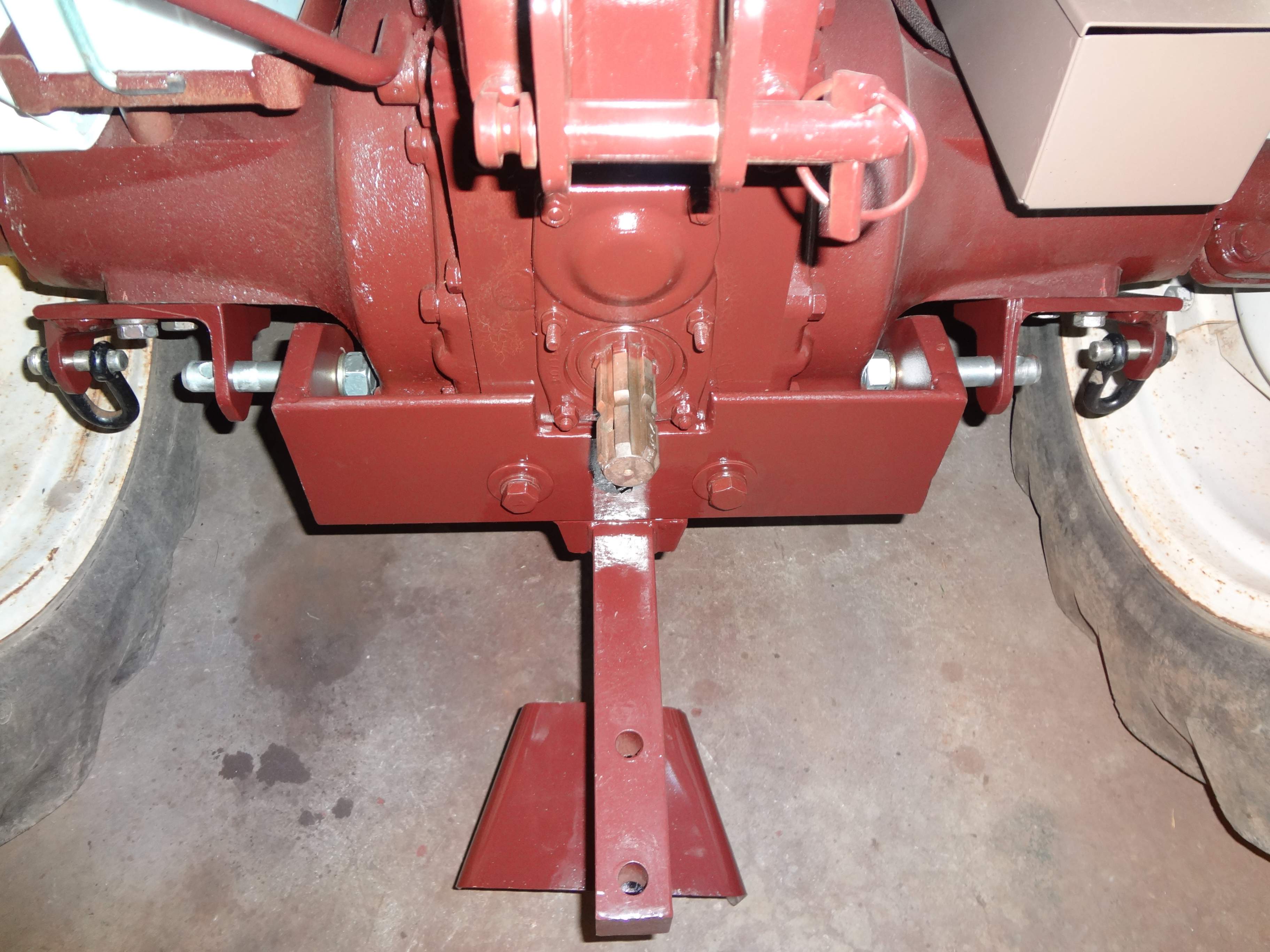

So I dreamed up a plan and started drilling, cutting and welding some heavy metal.
This is what I came up with. Do you think it will hold? 6 bolts on the main mount 2-16mm in the back
and 4-14mm up the bottom holding the plate and draw bar. Then extra support on the ends of the pins
from the chain mounts. I also had to extract 2 broken helicoiled bolts in the left axle housing and grind out the coils. Then rethreaded the housing to 9/16 course for some big bolts.
I'm pretty happy with it and it added a extra 45 pounds of weight in a good spot.
The carnage
The plan

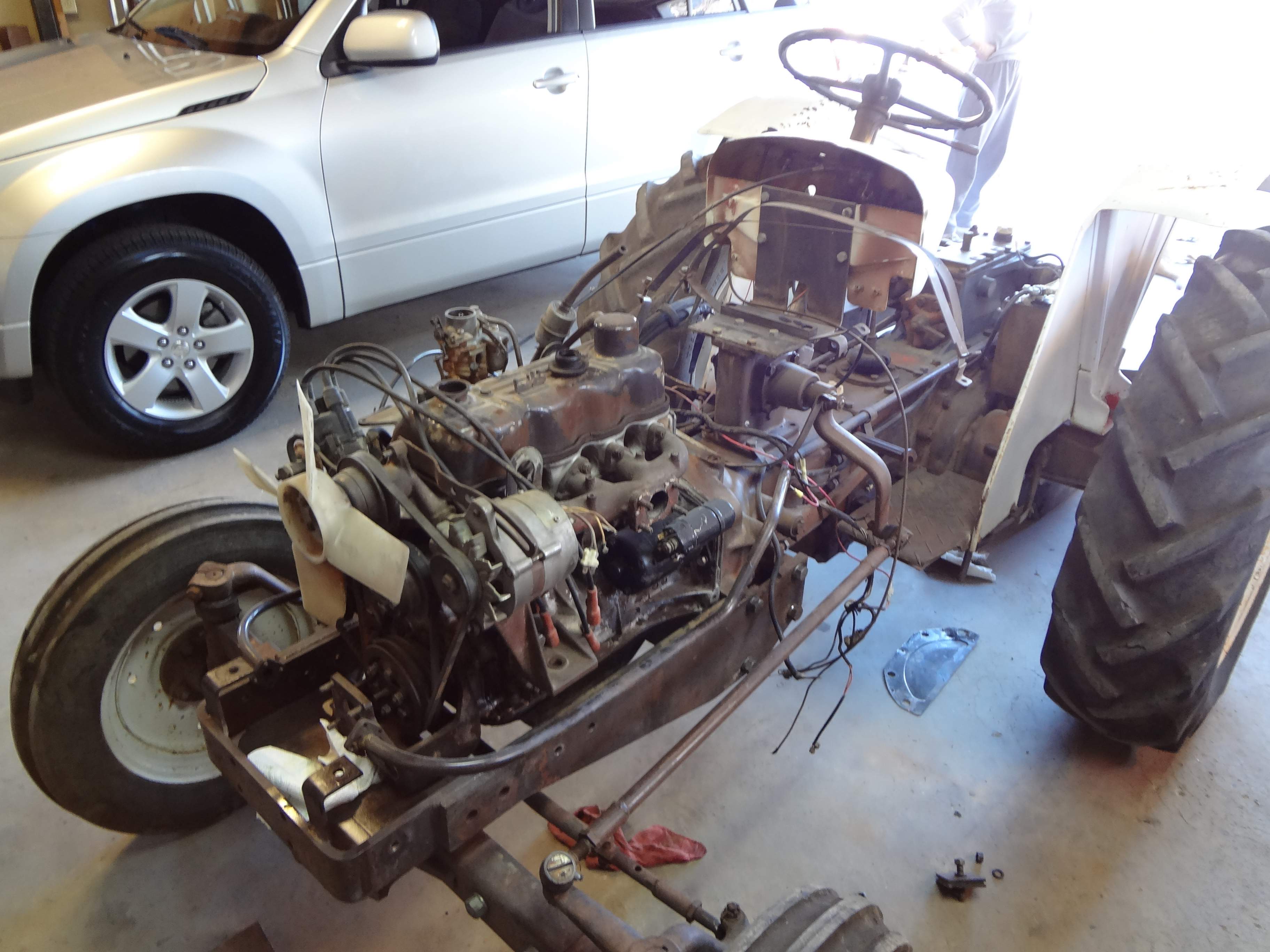

I started on this tractor in the front and the back is almost done.
A wheel is on order from Town&Country (I found a bent cracked one on front) hope to see it this week.
Then I want to get it out and raise **** in one of my fields. Why? because I can is a good enough reason for me.
