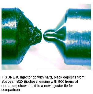

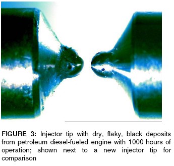

Yanmar liquid cooled, 4 cylinder Direct injection diesel.
NOT GOOD.
Here is the programmed cycle and loading for the engines in the test:
5 minutes at 2200 rpm and 21hp (which is 62% of rated load at 2200 rpm), then 44 minutes at 1450 rpm and 10 hp (which is 37% of rated load at 1450 rpm), then 1 minute shutdown, restart at high speed and repeat.
The photos and weight percent analysis are interesting but did not give enough clues about the deposits. The two most likely sources for these deposits are thermal decomposition of the methyl ester molecule or thermal decomposition of the glycerin molecule. At temperatures of 430ºC to 480ºC, decomposition of Soybean Biodiesel occurs [1], therefore the possibility exists for the Biodiesel to decompose during the ignition delay period, resulting in injector tip deposits.

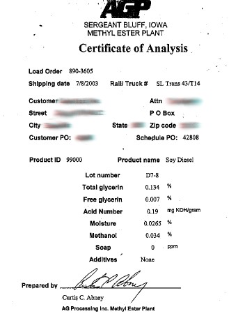

Some have had very good luck on B-100, depends who is making it, what kind of quality control is going on.
I think if one is going to go B-100 you should try straight vegtable oil instead. Much easier.
</font><font color="blue" class="small">( Use of B-100 is entirely experimental and will lead to injector coking and fouling as well as water contamination (BD is very hydroscopic) which is not good in any diesel engine. )</font>
   / Biodiesel #9
You are correct that the quality or lack thereof of the BD product is very important, however here is the BD-100 fuel quality analysis sheet for the fuel used in this test, and as you can see it is high quality BD-100 without excessive glycerin, methanol, soap, or water.
