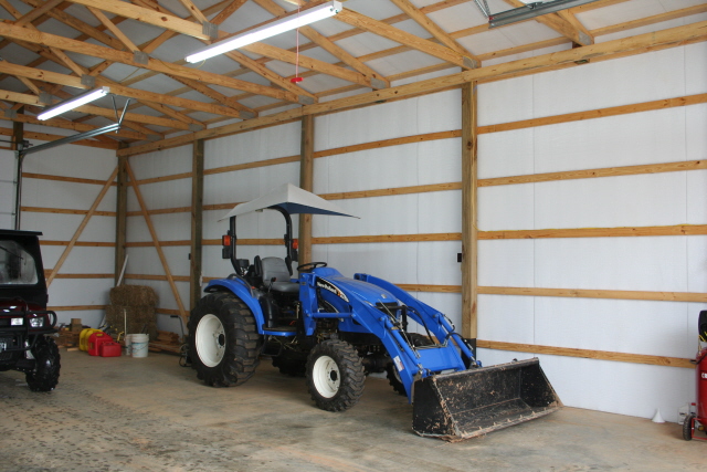

I currently have a New Holland TC45DA with 17LA loader. This past summer was about all I could stand without a cab. I'm tired of being swarmed by angry hornets, wasps, and other biting insects. The wife after last summer of having allergies from the dust and pollen as well has decided that a cab tractor isn't a bad ideal either.
We have 123 acres. In 2004, we planted about 40 acres in pine. We roughly have about 3-4 acres that we finish mow. Also, we have about 20 acres that we keep bush hogged. The rest is in hardwoods. We have to trailer the current tractor to my parent’s house to till their garden at the beggining of planting season. Based on our needs we need something that is easy to trailer and a HST. This knocks out that M9540 I've been wanting.:rolleyes: We've decided on the Kubota L5740.
I'm having trouble deciding on which bush hog to choose. I'd really like to go up from the Woods BB72 that I've got. Our land is mostly flat and what isn't ; you couldn't mow anyway. I think I could easily go up to a Land Pride RCR3596 (8 foot 3pt lift) based on Land Pride's posted specs on this cutter. It weighs about 1613 lbs and has a pto hp rating of 50-120. The other option is to go with a pull version. I might could evern get by with a 10 foot pull, but not sure on this. All of the Kubota dealers in our area carry bush hog and/or Land Pride. I know I'll have to keep the loader on the front for weight when bush hogging.
What do you all think? I don't want to go too big on the L5740. I'm also going to trade in my Woods RD84 for the Land Pride FDR35 90" rear discharge mower.
I'm just waiting on several of the dealerships to come out in our area next week and see what type of trade they are going to give me on my TC45DA with supersteer, 17LA loader with quick attach and HD bucket with replaceable cutting edge. Tractor has 200 hours and is in excellent condition. It's paid for and if it wasn't for them darn allergies and biting insects I'd just keep it.
Here's a pic of the current toy.

Our pine is growing so well that after this year we will not be able to get the current tractor down the rows. Your right about backing a pull type though. My wife does great with the 3pt hog, but I'm not sure how she would do with a pull type. :confused:
