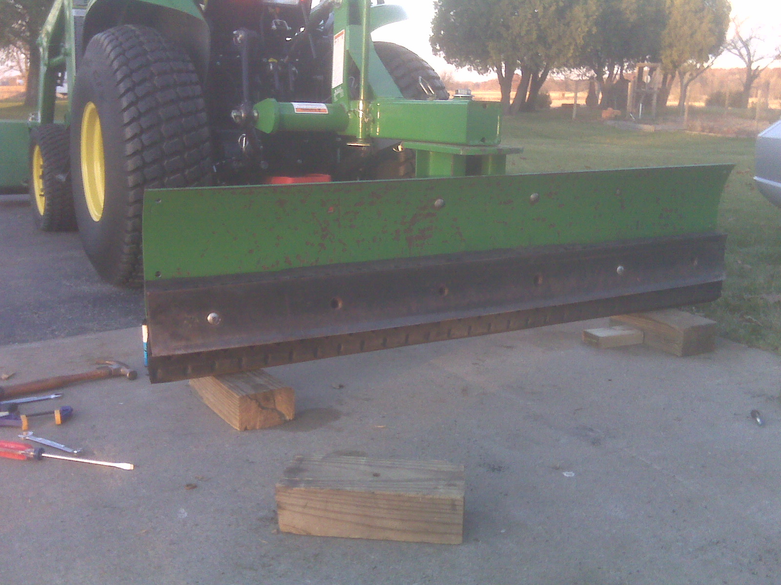

It will work well, mine sure does. I don't know how to post a link here on TBN but if you go to the thread titled "Snow Plowing Gravel Driveway--problem solved" that was started on 2/1/11 in this forum it will show you and explain what I did with the tire tread I found. Think mine was the second or third post in the thread.

Thanks JDG .. Am I correct you made a sandwich with the tread as the meat? How much rubber is exposed below metal? Can you see it flex, etc?
Anything you can say about how you would do it a second time would be useful. I am thinking about trying a Skilsaw rather than Sawzall ..bet I have to lube the **** out of it .. and wear a respirator.

Yup, it is a sandwich...had to buy much longer carriage bolts to get it all together. Tread hangs down about 5-6 inches from metal, is very thick, has hardly any flex. Sawzall with coarse tooth blade is best for cutting, a Skilsaw blade if you use one has to have very big, wide spaced teeth as they will plug with melted rubber fast. Didn't use any respirator as surprisingly little smoke was created. Would not have done anything differently except perhaps used a brand new drill bit to drill the holes, that brass wire in the tread is tough to get thru...had a whole bunch of old drill bits, used them instead then threw away afterwards. I don't know if using lube (oil or water) on blade and/or bits would make cutting and drilling easier, you try it out. Happy Independence Day.

Nice, new looking freebie, but I don't understand why you want to narrow it? As you can see in the picture of my RB, the tread sticks out from the metal wear strip both top and bottom, I did think about narrowing mine, but that would be just for cosmetics. Not worth the effort to me.
