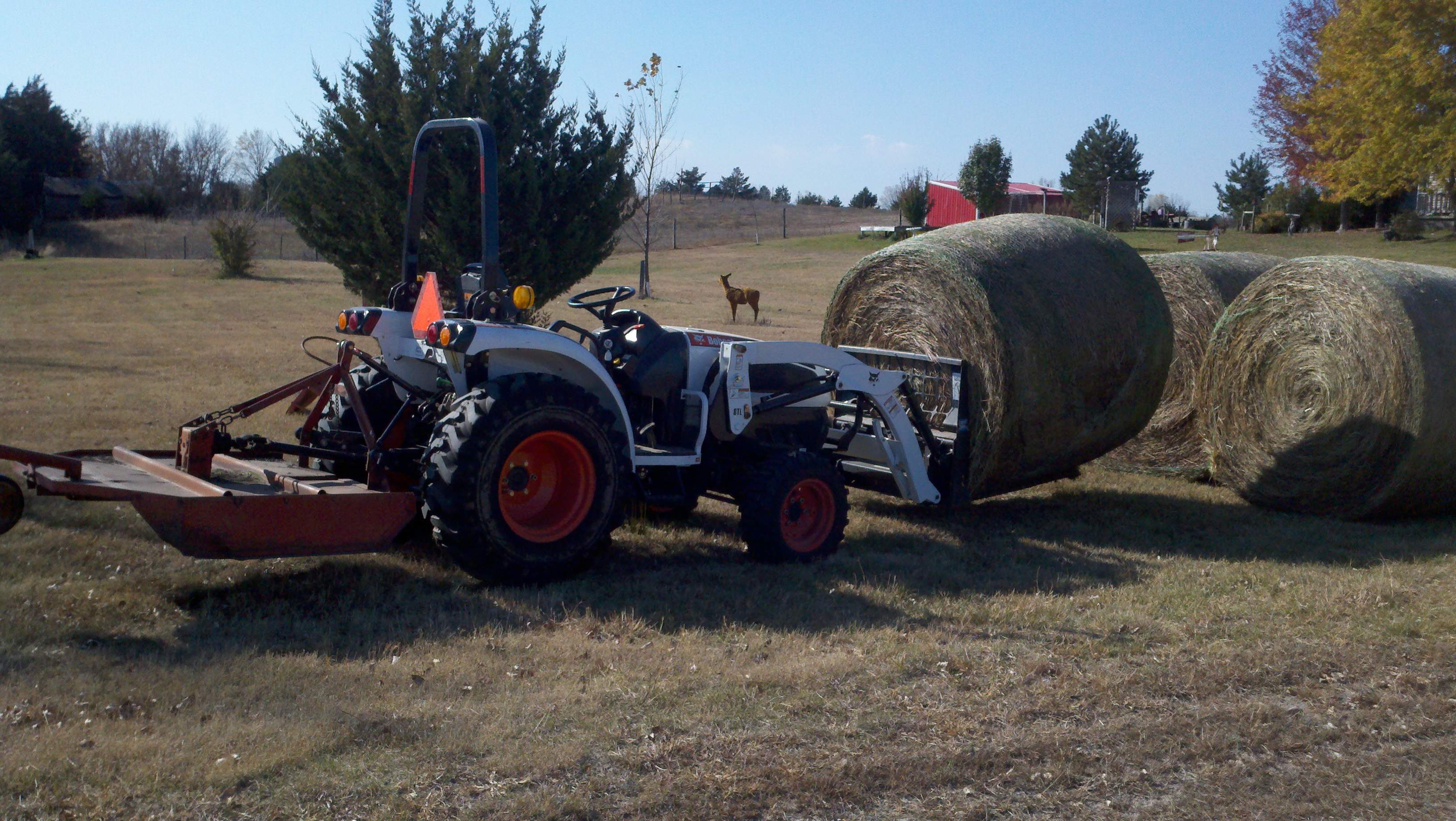

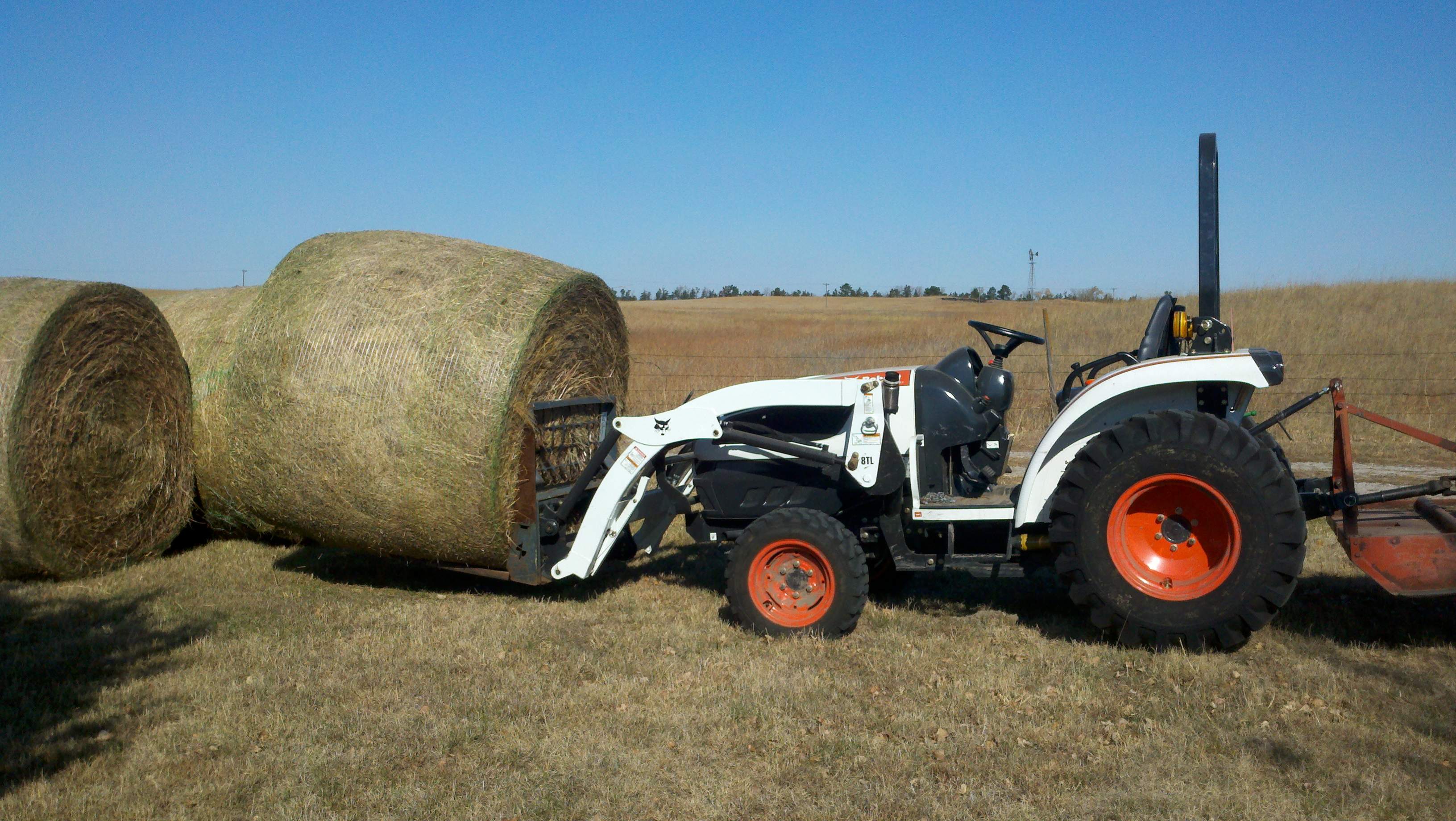

Moved big round bales with my ct 335 and my pallet forks worked great.

Are those 5'x5' bales? Around here it seems 4x5 is the common round size and then they go to big squares for larger bales.
I'm impressed your tractor could pick them up. I have to go down a bit of slope to feed my bales and 4x5 is as heavy as I want on spear!

Yes they are 5x5 . And i had to put my bush hog on the back. I tried picking them with out it and rear tires came up. I was surpriced how stable my tractor was with one on forks although i carried them about 6 inches off the ground as i had uneven ground and about 1/4 mile to move them.
