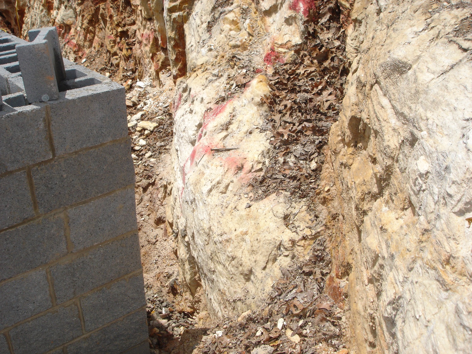

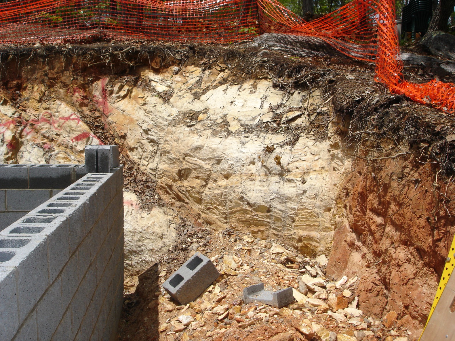

I have been excavating into the side of the mountaintop in my part time for the last several months for the house I am building. My little JD 790 was doing a great job excavating the first 100 or so cubic yards of material. Mostly 6"-12" of topsoil, stumps, rocks the size of a 35" TV and smaller. I had to clear a flat level spot about 55' long into the side of the hill to accomodate the house footprint. All went well for the first 45' or so. Then I hit solid rock. If you look close, you will see that it was hidden just under 12" of topsoil. No one around here knows what type of rock it is, but it is the hardest stuff to break up.
We broke a huge rental skidsteer one weekend. Then we got it back the following weekend and broke the 2.5" thick bit on the hydraulic breaker!!! Then we hired a 12,000# excavator with another hydraulic bit. He worked 2.5 days and finally gave up. He charged me essentially for mileage and diesel only. We then tried to take it out by hand with a 90# electic jackhammer. That worked for 4 weekends until we broke the jackhammer. I then threw in the towel and decided to move the house 5' to one side and 5' farther out from the hill. That necessitated using step down footers and another set of delays.
The rock is bright white, extremely fine grained, has few seams and when you do find a seam, it will curve erratically. It tends to powder, not split when pounded hard even with a pointy hydraulic bit. Granite is common around here and this stuff is several times harder to work than granite.

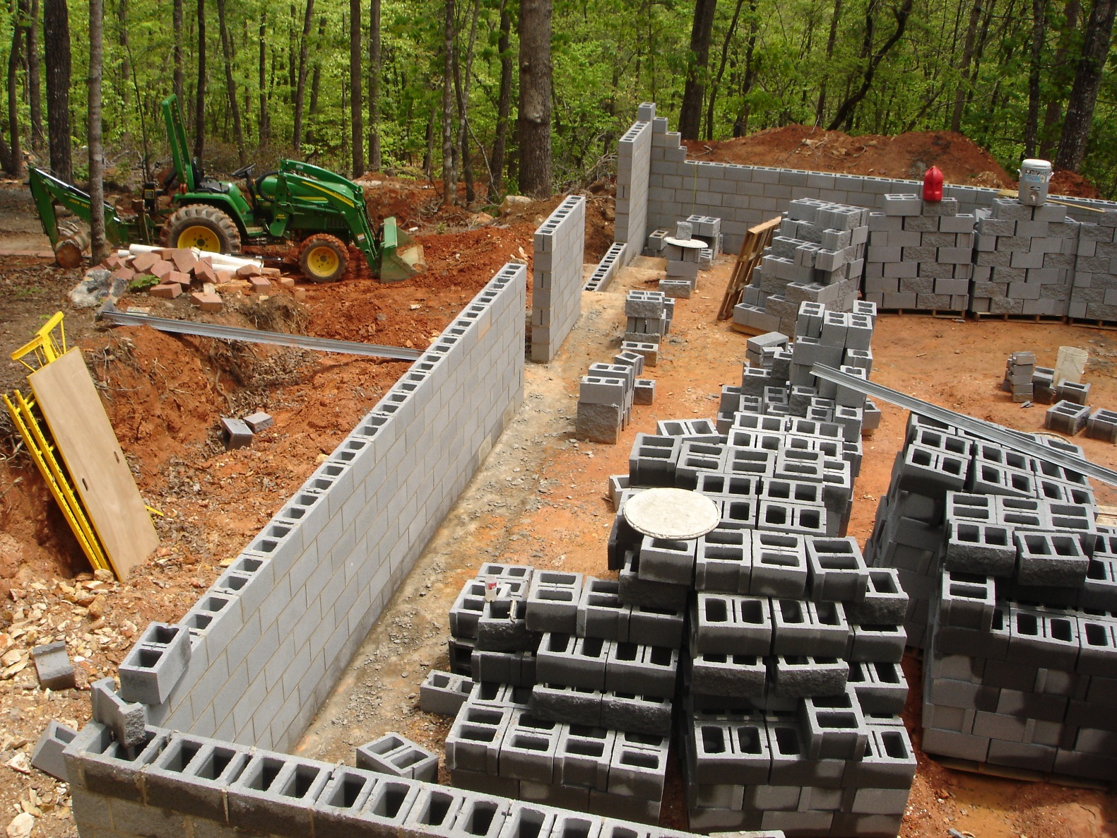

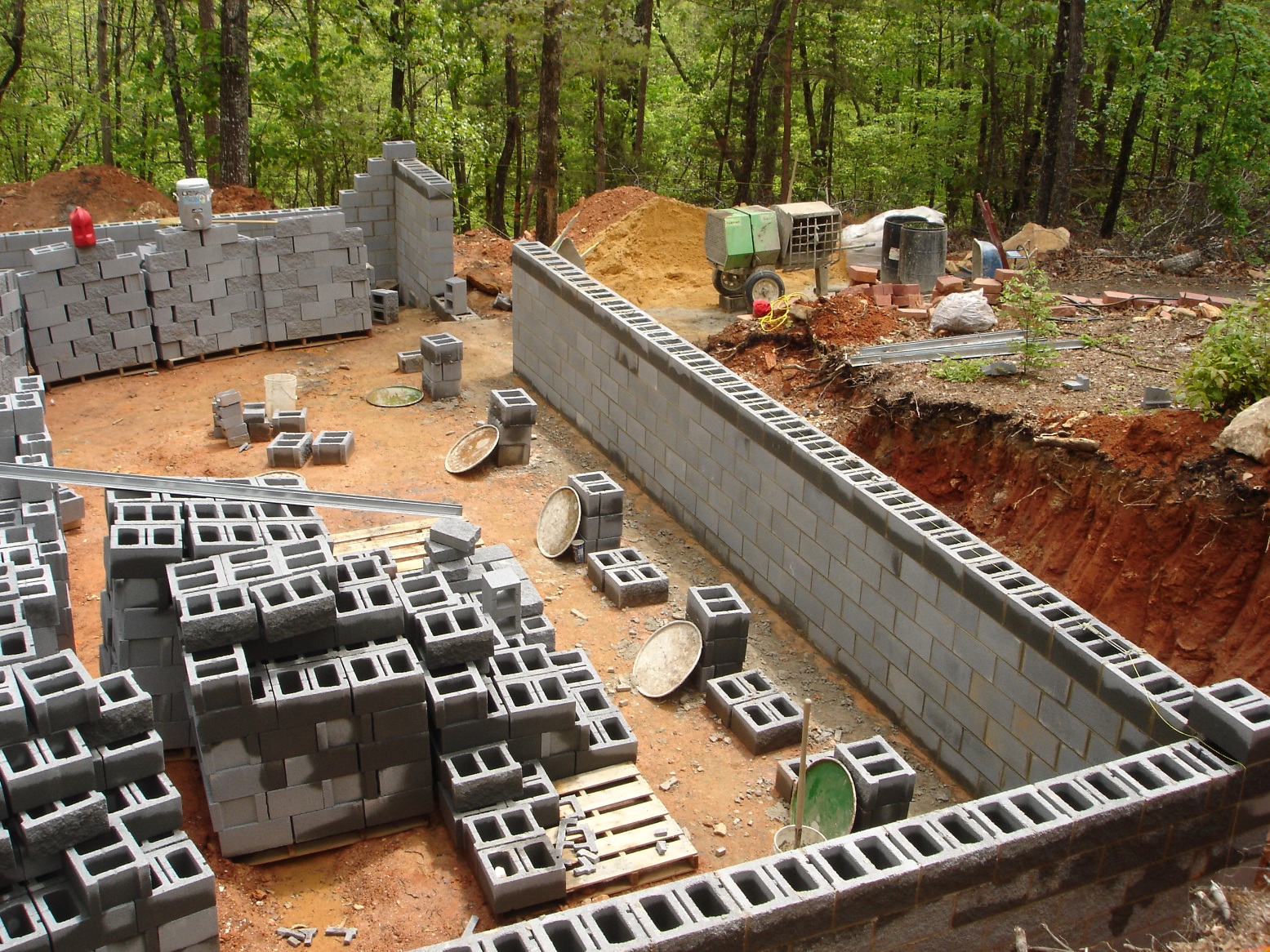

The attached pix show what a 790 will do in removing the side of a mountain. The walls in the pix are only half done. You can see the massive rock we encountered on the back wall of the house. The rear footers had to be dug down into solid rock. The rear wall had to be 12" thick because it will have over 7' of fill up against it when done. The top of the 10' basement walls will stick up about 2' higher than the top of the rock. The rock wall is about 9' high from the bottom of the footers to the top of the rock.

That looks alot like what I call sandrock. It's a pain in the butt. I sunk 24x36 footers into it for my hunting cabin. I dug two footers in a week then hired a 3 man crew for the others. Try this method:
Buy a bucket of rapid expanding cement. It's used to secure bolts into concrete. When its mixed with water it gets HOT. Drill a hole and fill it. The expanding action may crack the rock for you. I'd give it a shot if the alternative was moving a house. Small rock blasting isn't a risk to your well if done correctly.
   / Big rock---I give up----I'll just move my new house instead #6
Similar suggestion: look up "Dexpan non-explosive demolition agent." Basically super-expanding cement. Only works if you can drill holes in the rock though.
I tried Dexpan. All it did was break off little pieces. Dexpan works best if the rock has seams or a grain or will split along a string of Dexpan filled holes. It didn't work. This rock is so hard it powders before it will split.
On other rock that can be drilled, Dexpan works great.
