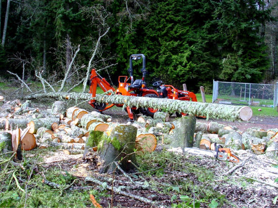

If you are planning on doing firewood with your tractor, I would seriously consider a backhoe. I have really enjoyed mine when working with logs. I'll attach a pic.

Greg, nice to have the extra "hands" while cutting up wood. I just got a Woods 6500BH for my 7500 and some trees are going down this weekend. Great Photo

In that picture, that is the top half of one of 14 trees that I dropped in a cluster. It was actually about 50 feet away from that pile. With the BH I was able to lift it at a balance point, raise my stablizers about 6 inches and slowly move back so I was directly over my row of rounds. That way I was able to cut the rounds and they would drop neatly into a row. Then I just worked my way down the row with my splitter and palletized as I went. It turned weeks of backbreaking labor into a couple of days of fun.
Greg
