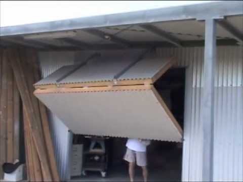

Several farmers in my area have built their own bi-fold doors. They just use a flat piece of steel for the track and then weld an angle iron over where the roller runs. The roller is usually just a fairly large bearing in about a 2-3" od size.
I'm planning on building one for my shop. My door is the same size as yours. I'm just going to buy some light angle iron say 2" and weld up a frame and cover it with tin. The neighbour here has the ability to spray foam. I'm just going to get him spray the insulation on and I'm done.
I'm thinking of using a small rubber tire for my rollers and just make a pocket top and bottom for the tire to fit into. That way I can just run the tire against my door frame and I don't have to build a track. My yard is well sheltered from the wind so I don't have to worry about the wind grabbing the door while it's going up or down.
I'm either going to use counter weights to help me open the door or set up a winch system. I haven't decided yet.
The concrete under the door is uneven so I'm thinking of getting some plastic that doesn't freeze and wrapping it around some foam to seal the bottom. A piece of uv resistant rubber would do the job too.

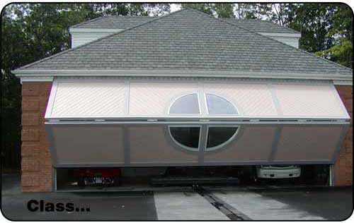

My uncle needed every inch of head room and went with many fold door on tracks... picture a roll top desk top turned 90 degrees...
The downside is it takes up interior wall space when open...
His garage is like a walk out basement with retaining walls on both side so a convention side rolling barn door would have nowhere to go when open...
I think you are looking for something like this?
http://www.eggeth.com/wp-content/uploads/2014/09/side-opening-garage-doors.jpg
My uncle has this door:
http://3.bp.blogspot.com/-3-ArHw7vY...Gb1P3G_zWA/s1600/nustumiami+is+vidaus+ssd.jpg

That was interesting. Have never seen one go sideways before. Yea the first pic is sort of what I had in mind, except I would just have a 2-2 split. I have a walk-in door at one end of the shop already. Wish I had gone this route in the beginning.

I thought of this type: https://www.google.com/search?q=fol...gC#tbm=isch&q=horizontal+folding+garage+doors
You could probably use the existing door with new overhead bi-fold hardware.

I've mentioned before about those types of bi-fold doors. We had them at the airport. They are sails in a wind. Lets say someone has the back door open and there's a good breeze on the back door side of the house. Now start opening that bi-fold door and that lets the air come through the back door and it blows the bi-fold off its tacks at the bottom, then it flaps around denting the siding near the bottom of both sides of the door. They really need very robust hardware to be safe and reliable.
