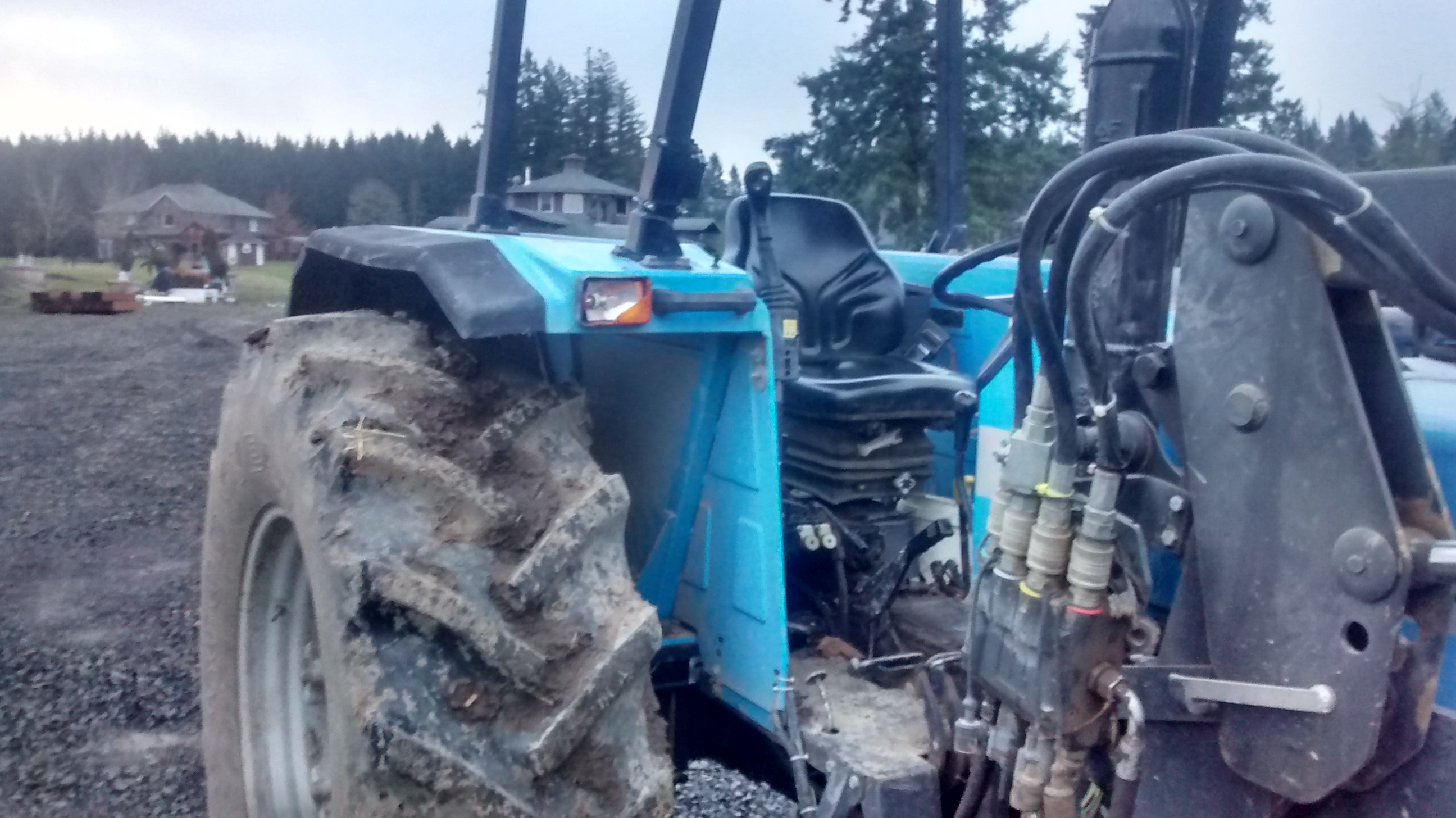

Well folks my BHT-2 moisture meter is on its way. I need to figure out how to mount it on the right fender/handle location on my tractor. I would rather not drill holes and would like to remove it when not used. Any thoughts on ways to mount. I have been looking at RAM mounts, but not found on that will work.
Could folks please post pictures as to how you mounted yours, or something similar?

On our Landini I clamped a female SMV mount to the ROPS near the fender then mount the readout on a male SMV mount. Quick connector to the power from the tractor. It's mounted with the controls for the bale accumulator.

Interesting. Is you ROPS beside the seat, or do you turn around to see it. MY ROPS is about 2' behind the seat. Thanks for the help
   / BHT-2 Monitor mounting on tractor #4
Our ROPS is a 4 post so front post is in the center of the fender near the front. In the attached picture if you look close at the front post you can see where it is.

Thanks - the photo really helped.
