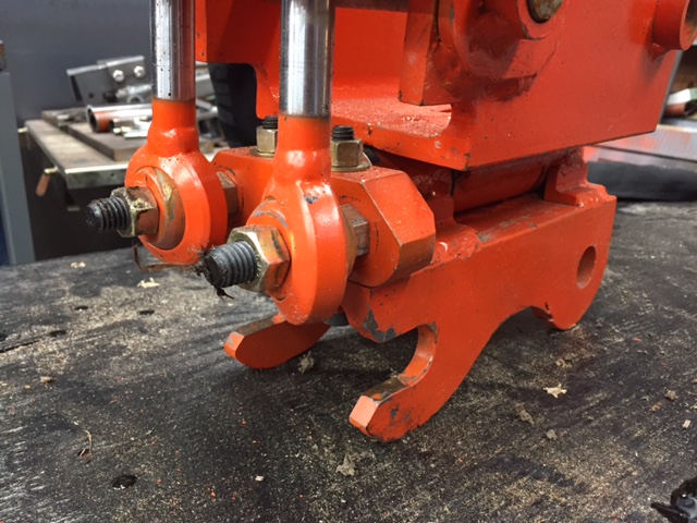

If you can weld, it is straightforward to make a pin-grabber type quick coupler, as shown on the bottom of the photo. This is a common accessory on excavators and larger backhoes. It is true you lose some breakout force, but you gain a lot of utility, and can also use standard pin-on buckets and other attachments.
I can weld fairly well, but I wouldn't be able to properly cut that thickness of steel. I could have a local machine shop do it easily though. I'd have to get my hands on some exact measurements though, any ideas on that? I'm surprised nobody makes a quick coupler, to me, the versatility would outweigh the decreased breakout force.

I had to figure out the measurements to make the coupler in the photo. Turns out pretty easy. The lower or pin grabber part fits in between your bucket ears, so the inside width of bucket ears = outside width of the pin grabber. pin spacing is the same. The upper part just duplicates your bucket ears, very simple.
A company called bXpanded makes one for the B76 backhoe, you can see from their photos how it is designed to be as compact as possible.
One thing to take note of, adding a quick coupler will screw up the relationship between thumb and bucket. So I would not buy that Kubota thumb unless you are sure you will not do the quick coupler. If you do the quick coupler you will have to make a custom thumb.
Folks on this forum will have lots of good ideas about cutting out the metal parts if you decide to do that.
Very good point on the quick coupler making a factory thumb inoperable, thanks for that. I'm sure I could have a coupler built locally, I have a local machine shop with very reasonable rates.
What have you mounted on your coupler? I'm envisioning different sized buckets, and a ripper. I have a current need for some type of rake to clean overgrown watercress out of my stream. I was contemplating bolting a receiver hitch to the bucket, and attaching a lightweight pine straw rake I have to the hitch. It wouldn't be elegant, but I'm thinking it would work as I wouldn't be applying much force at all to the attachment. I'm trying to think through other useful attachments that could use the quick coupler, in order to justify it.

I switch between a 24" landscaping bucket, a 12" digging bucket, a 6" trenching bucket, and a ripper. The ripper I would say is pretty much a must-have item if you deal with stumps and roots.
I used to do it by removing and re-installing the two bucket pins. But after adding the thumb (which shares a bucket pin) that became quite a bit more difficult. The quick coupler makes it about a 3 minute chore depending on how good you are at snagging the fixed bucket pin.
