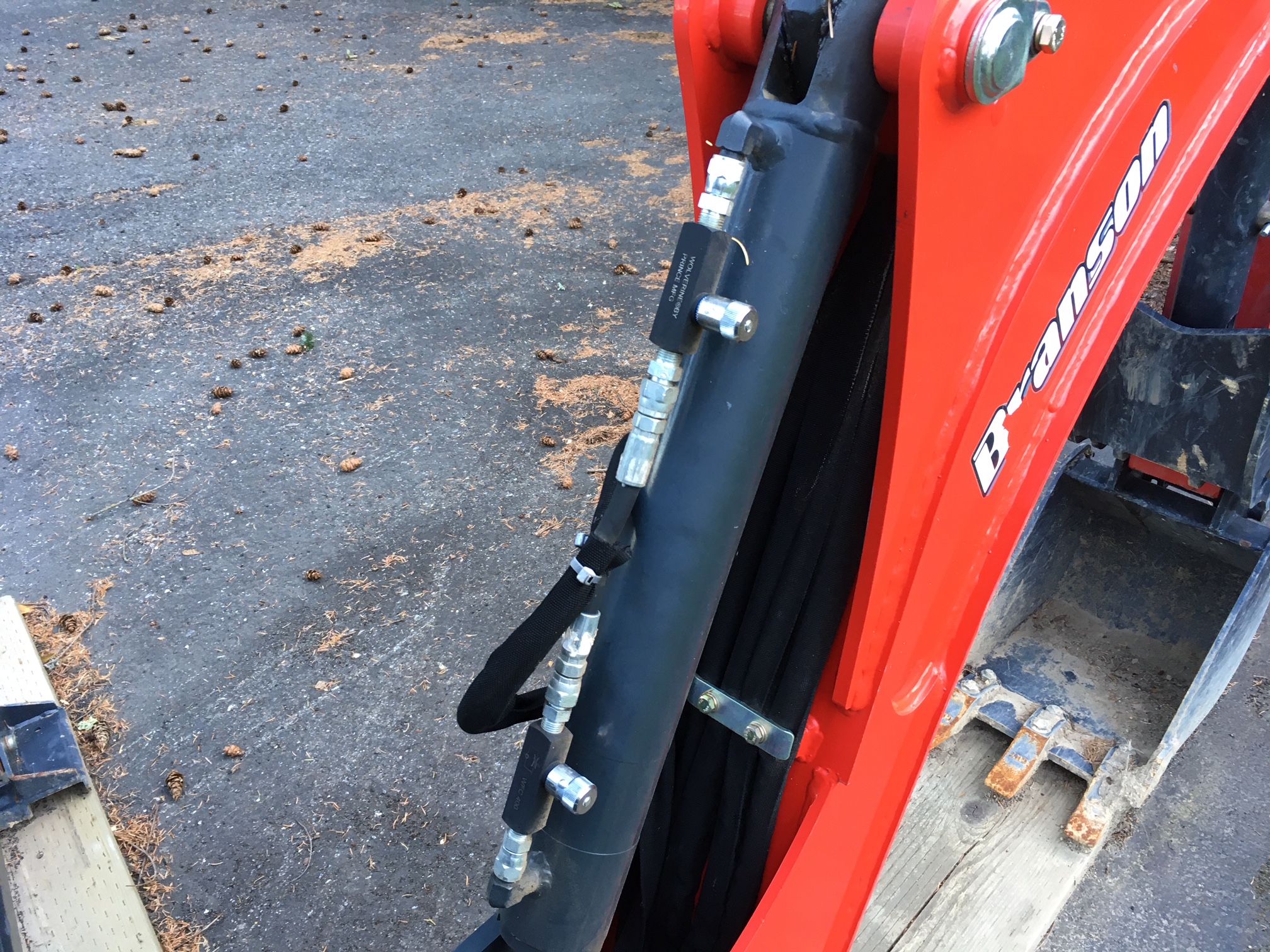

Here's the parts list from Surpluscenter:
2 9-7960-4 1/4 NPT 5 GPM PRINCE WFC-400 IN-LINE FLOW CONTROL
2 9-2404-6-4 JIC 6M x 1/4 NPTM CONNECTOR
2 9-6505-6-4 JIC 6F TO 1/4 NPTM SWIVEL
and here's a pic

Nice and clean install. :thumbsup:
I think the "problem" is due to the geometry of the curved boom. Curved booms are very sensitive on the max height position do to the way the cylinder has to be placed.

I wish I could say the clean install was due to my planning but it's just the lazy way to do it. Also it puts the restrictors where you can reach them from the operator's station for fine tuning. As I put hours on the BH I found I could back them off a little. Hopefully the restrictors are light enough that they don't stress the fittings on the cylinder and crack them. They look fairly strong.
When running the un modified BH it feels like the boom cylinder's valve is oversized. The sweet spot in the travel is very narrow. The other valves don't have that feeling nearly so much. A cylinder geometry problem would make sense.
