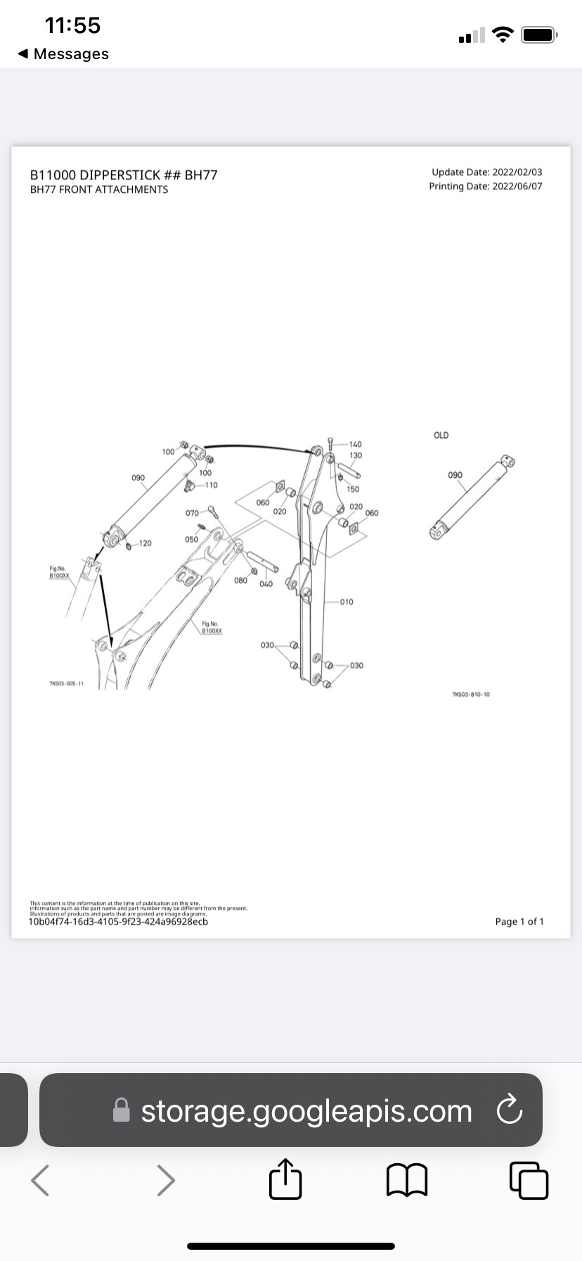

I’m searching for advice on the square boom spacers maybe called spring washers they are between the two main booms
I have about 1/2 of play when swinging left to right
will this solve problem or is there more I need to do bushings?
much thanks all
g
i will attach a pic from the tractor view as soon as I get back to the farm
below is the dealers pic #060

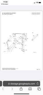

I’m searching for the square boom spacers maybe called spring washers they are between the two main booms
much thanks all
g
i will attach a pic as soon as I get back to the farm
ps I have searched diligently on messicks and others and cannot find this part and #
It’s # 060 got this from dealer but he is not sure if these are concave shaped ( to fill the gap)

If I am understanding what your saying I would think #20 would be the problem, or maybe just order both.
   / BH77 boom (square) spacer washer ?
Was thinking that as well the bushings hold it in place I’m guessing with a good grease seal ?
