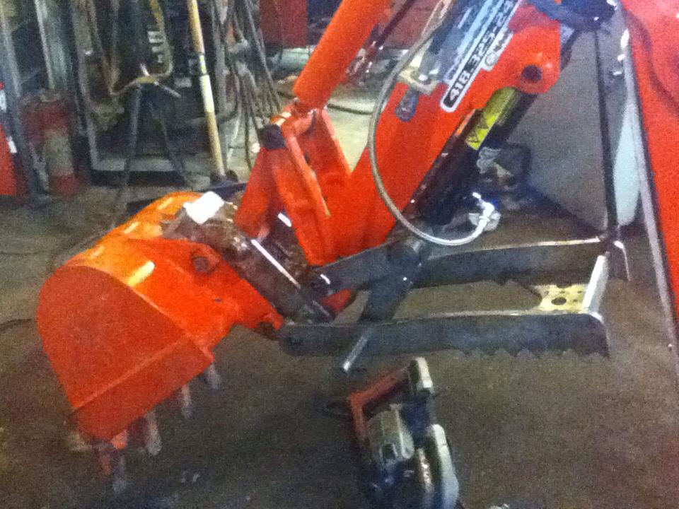

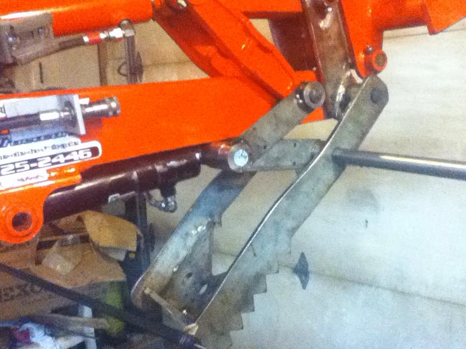

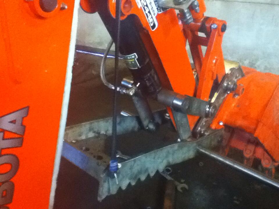

i had the same problem with mine.. i used the same valve body as you...
i put a power beyond into it... placed before the backhoe valve body... i also plumbed a 3rd return line for the thumb cylinder
and ajusted the line releif a little lower than the bucket this way if i close the bucket the thumb retract ;)
here is a few pictures of my hydraulic full rotation thumb on this pictures it is not finished...
64538_10151335674293851_1365529516_n.jpg66460_10151335672403851_480140096_n.jpg537382_10151335672468851_883450282_n.jpg
i made myself also a quick coupler...

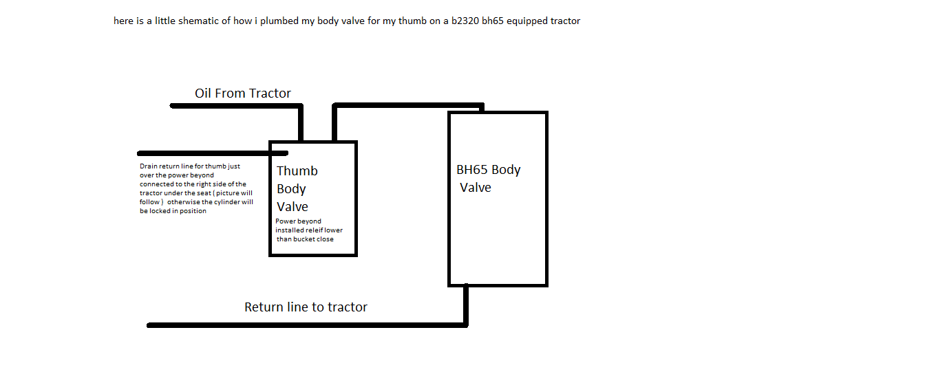

   / BH65 Thumb Conversion Help #8
here is a basic ms paint shematic hope this will help...
this valve body is mounted in serial before the bh65 valve body
a power beyond needs to be installed.. to avoid pressure buildup in the thumb valve body by operating the backhoe
an aditionnal drain line for the thumb needs to be installed otherwise your thumb will not work properly

If you install the thumb valve before the BH valve, you will limit the BH pressure to the pressure that is set on the thumb valve relief valve.
I think you should install the thumb valve after the BH valve.
You want the BH bucket to always override the thumb , you will need to figure the relief pressure for the thumb valve to relieve.
Depending on the size of cyl and mechanical setup, you will have to figure out the relief pressure to allow the thumb to recede when the bucket force is greater.
All return/out lines should go to tank.
The BH relief valve should be set the same as the tractor relief valve.
   / BH65 Thumb Conversion Help #10
if i install the thumb after the backhoe if i do any action on the backhoe the thumb wouldnt work no more because there is a parrallel feeder into the bh65 valve body
normally the Actions Releif on en excavator are generally higher than the main releif.... thats mainly because the line releif are not full flow the main releif is full flow
