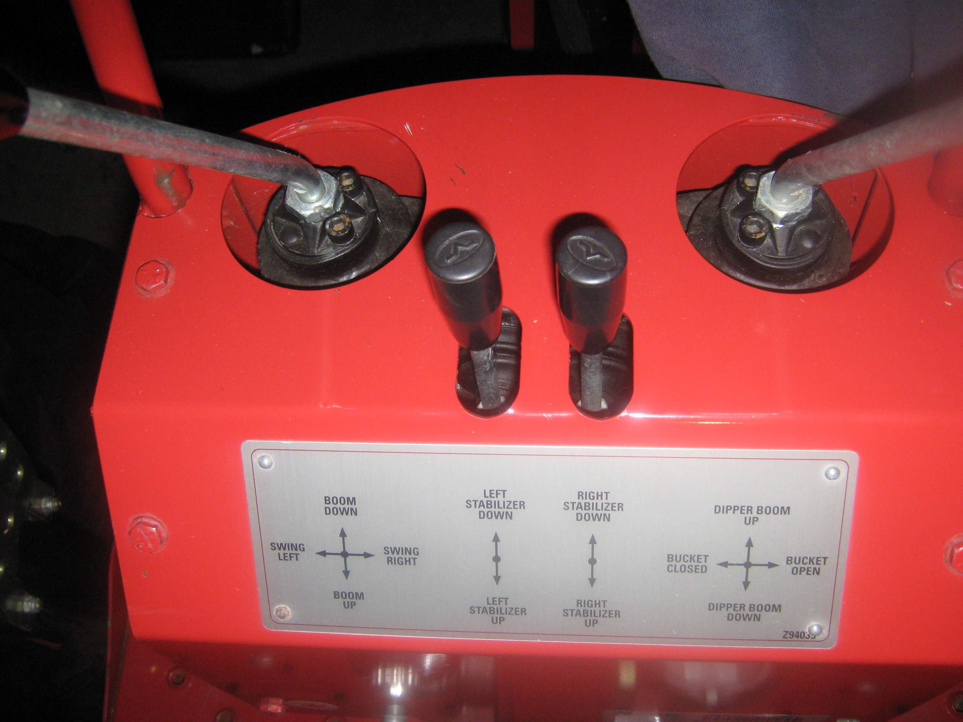

Hello,
I am getting ready to purchase a used (43hrs) Max 28XL TLB.
Dealer is too far for me operate the unit and I do not have any other dealers close to me.
What I need to know is what lever does what ?
I am use to,the left lever controlling the first part of the boom, in out left right, and the right lever controlling the outer boom, in out and the bucket.
Also, when you are drawing the BH bucket in and want to keep the bottom level can you draw back on both levers and get a level bottom to a trench ?
Also, does the FEL have a float position ?
Thanks up front, any comments welcome, just remember I am still a newbie when it comes to tractors.
Info: I have used a Yanmar SC2450 for fours years, which operates similar to what I am asking about and would like to keep the operation the same.

It's pretty easy to re-learn the different configurations. It is also fairly easy to swap hoses around to get the configuration that you like
What may be more of a problem is that small back hoes are quick & weak as opposed to big ones that are slow & strong

controls.jpgI don't think the max 28 hoe would look any different then my Wallenstein.
   / BH Operation - Lever Control #4
View attachment 397347I don't think the max 28 hoe would look any different then my Wallenstein.
that's what it is on the 3016 as well.
To the OP, yes to everything. There should be a sticker on yours like there is on mquitas machine, and mine.

Thanks to all for the comments.
I am really interested in knowing the operation of the levers more than "I can learn a new operating system".
I just wanted an idea of what to,expect before I buy the tractor.
If the controls are different and I want them similar to my Yanmar controls, is it possible to re-plumb the controls ?
Thanks to,all again, I appreciate your comments, makes me think outside of my own blinders.
