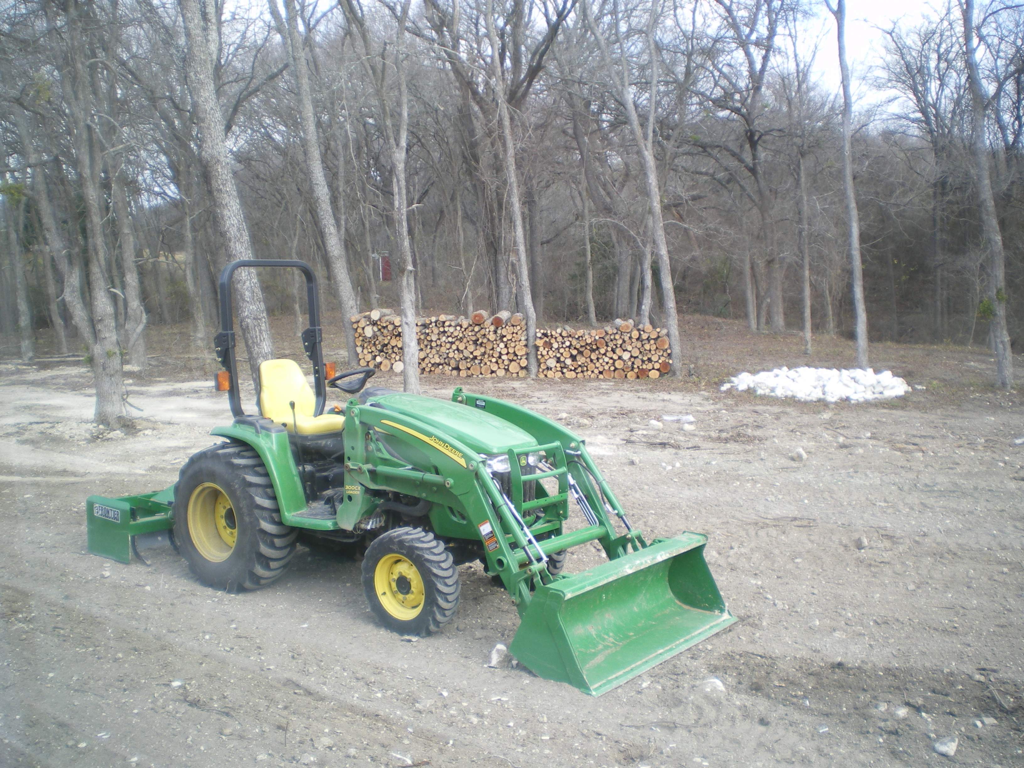

Hello All! After months of enjoying all the forum has to offer I finally joined in on the fun. I'm currently in Iraq where I have been contracting for the last 6 years, so getting a morning or two down at the JD dealer drinking coffee and staying up to speed with all things "tractor" hasn't been an option. I could really use some input from all you guys....
I have a 2008 JD 3520 E-Hydro OS with a CX300 FEL and an assortment of 3 point goodies. Right now I am in the market for a backhoe and I have located a nice very lightly used 447. The JD website lists the 375 or 485 to be used on the 3520 but I have seen many others using the 447/448. It is my understanding that the hoes are almost identical with the 447/448 being predecessor to the 375/385. I have the OS model so I was opting for the 447 as it sits closer to the rear of the tractor (no extra space needed for a cab). I have to say that in my search for one of these hoes I have found myself salivating :licking: over the 110TLB and considering a trade in/up....but the reality of the months in the doghouse that would surely follow have kept me at the salivating only stage...:D You have to love the "Creep to position" and the SS adapting FEL with additional hydraulics...not to mention the 310 inspired hoe...:thumbsup:!!!
What I wanted to ask was if anyone could share their experience with one of these hoes? I am worried about dropping several thousand $$'s for something that would end up not being good for much more than "scratching" around the backyard. I use my CUT for everything on my 3 acre tract short of finish mowing (I got a ZTrak 820A 48" for that!). I just built a new home and shop and I have plenty of trenching, tree/shrub planting, flower beds, garden construction, drainage cuts to make, etc.....and maybe even some light stuff around my pond project. (I use a local rental company for heavier jobs ---dozers etc.) There is a wide range of soil conditions for such a small tract as well. From caliche at the hill top to a sediment and root filled creek bottom....there seems to be a bit of everything. I don't have delusional expectations of digging basements in solid granite or anything...but I would like to hear first hand opinions from users on the hoes capabilities and value. Any input you guys could lend about the best model for my rig and experience you've had with your hoes would be greatly appreciated. Thanks everyone for all the useful and entertaining info in all your threads here----best forum I have seen by far! I'm not sure if I attached my photo correctly but I included a shot of my "baby" as well...Great Day to you all!
