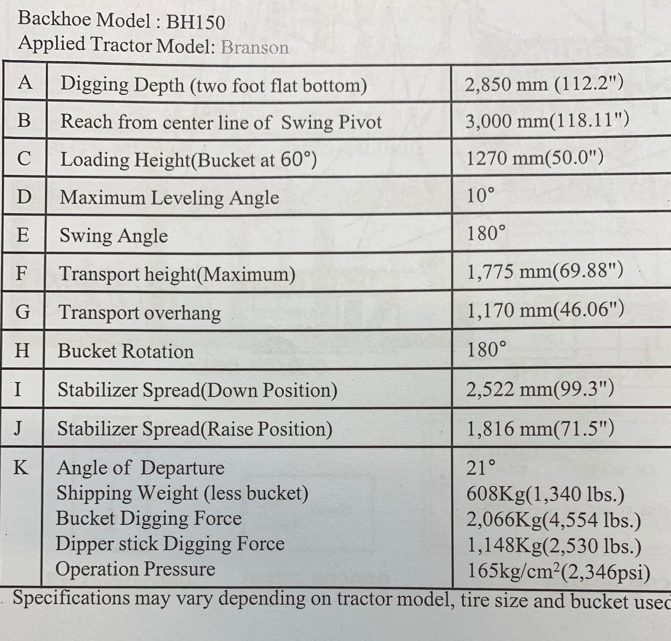

Take a look at these 2 "spec" sheets on the BH 150 and you'll see why I am always suspicious of Branson specs.
The spec sheet that is plain white/black is taken from the BH 150 owners manual that I got last Friday with the purchase of the tractor/loader/backhoe.
The other spec sheet with the red on top is taken directly from the Branson 15 series sales brochure.
Notice any differences?
Take a look at the digging depth and bucket force......
   / BH 150 Backhoe Spec Sheets #2
Maybe they changed backhoe manufactures or one of the spec sheets is outdated..
   / BH 150 Backhoe Spec Sheets #3
this i can answer for you, the brochure you have is last years, we have not received any of the new ones yet , so more than likely what happened is they sold you a new backhoe and gave you the correct manual, as those are what we have here, but you have a 2020 model brochure.
   / BH 150 Backhoe Spec Sheets #4
50" loading height?
Neither of those specs sheets look trustworthy
