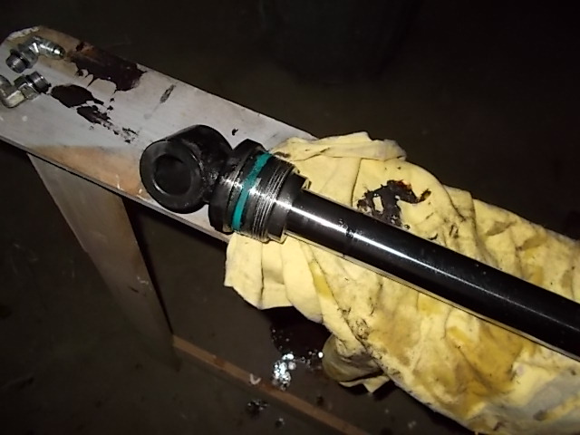

Well, here's one you'll enjoy. Was using my toothbar bucket Saturday to back drag some manure/hay out of a stall, when this big POP happened. End of the top cylinder/rod ( curl ) came completely out of the case, resulting in a really droppy bucket. Threads/seal completely screwed up.

Even though everyone does it -back dragging is hard even on heavy equipment. Do not know why It was something we were taught in class. I ran a crane so I kind of missed somethings
   / Beware Yellow Yanmar hydraulic fittings. #4
Think of it this way. It takes 2500 PSI (lets say that is your rated pressure relief point) to lift your rated load then when you reach the desired lift point or angle of bucket the check valves close. And now the system is trying to prevent further fluid flow. now you place twice the rated load on the bucket cylinder and you raise the pressure to twice the relief pressure. I have wondered what protects the hoses in this situation. Something has to give. Is there a secondary popoff kind of device that lets go when you reach some higher load?
Not from what I've experienced, maybe on some higher quality machines? I've blown out hydraulic hoses back dragging and hitting something more solid that peaked out the hydraulic pressure and the hose rating. Blew oil everywhere, thankfully in the other direction, it was scalding hot as well from working a few hours. Learned right then there is no relief for excessive "mechanical" pressure built, which makes sense as I saw nothing in my hydraulic diagram. Im actually glad it blew a hose before it ruined a cylinder seal or worse a loader valve seal. The hose was easy to fix.
