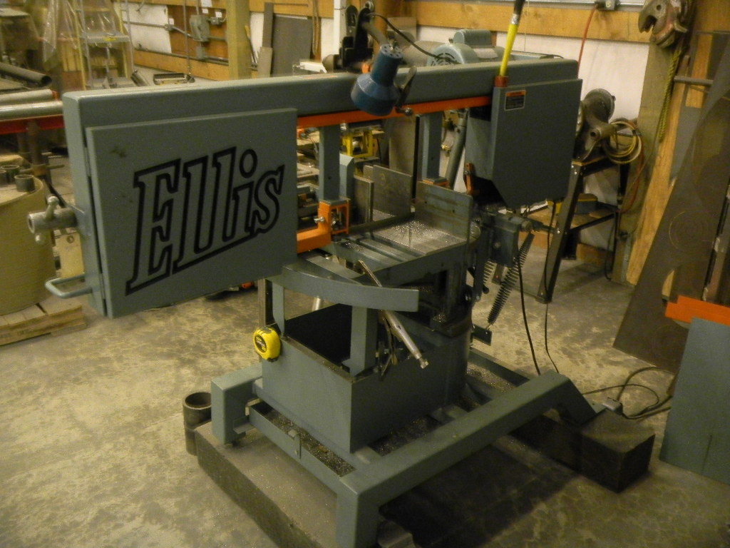

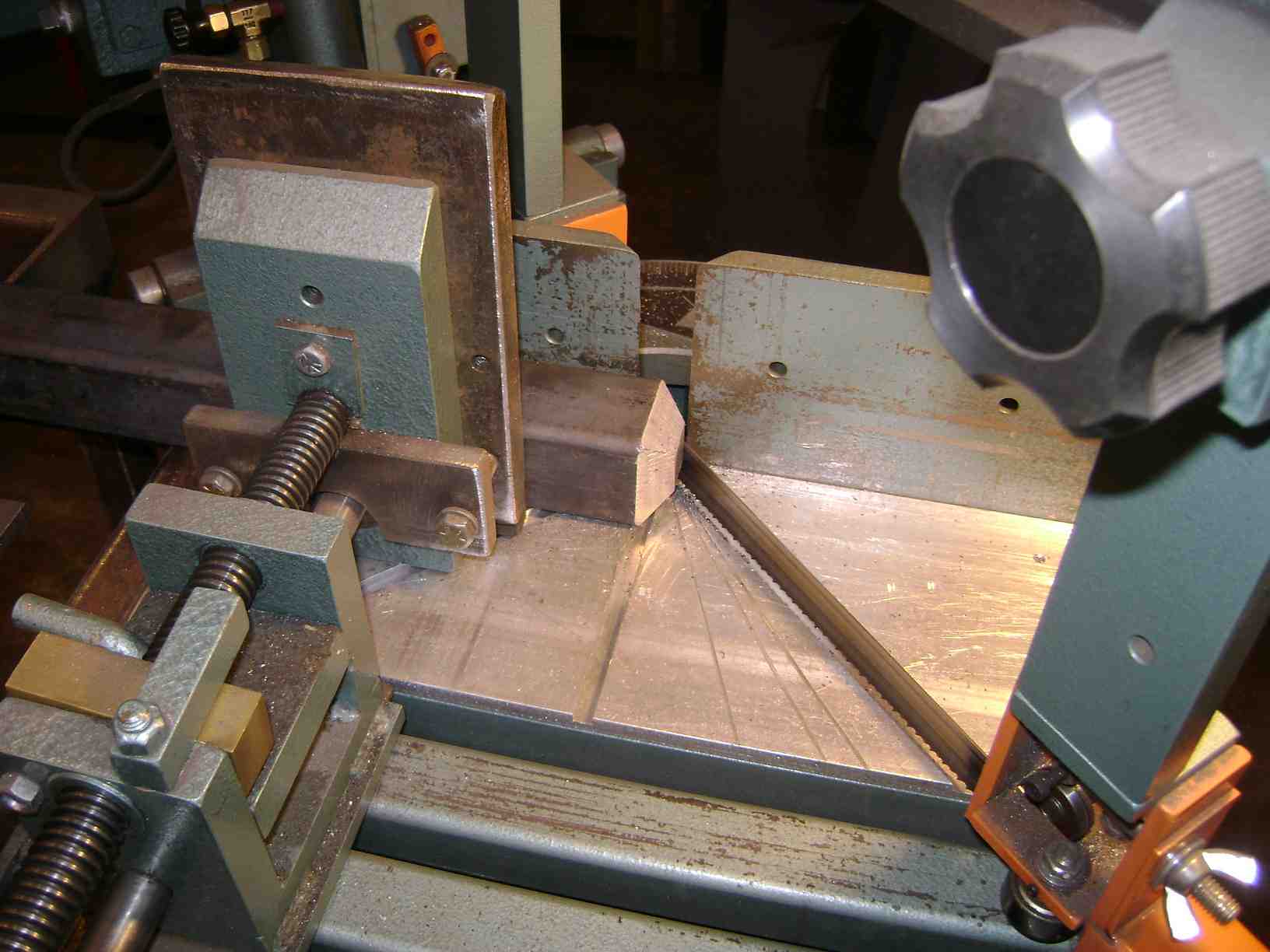

Ron you're more than welcome to come over and use my Ellis saw, tractor torch, or Mill.;)
