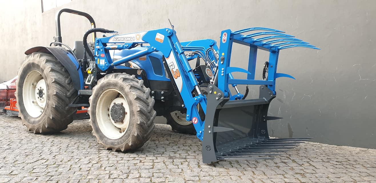

Feb 3, 2020 / Better front floatation #3 ptsg Super Member Joined Apr 3, 2013 Messages 7,269 Location Portugal Tractor Branson F36Rn - Agria 8900D Yes in Europe we use mainly R1 Radial tires. They provide better traction, ride and flotation.

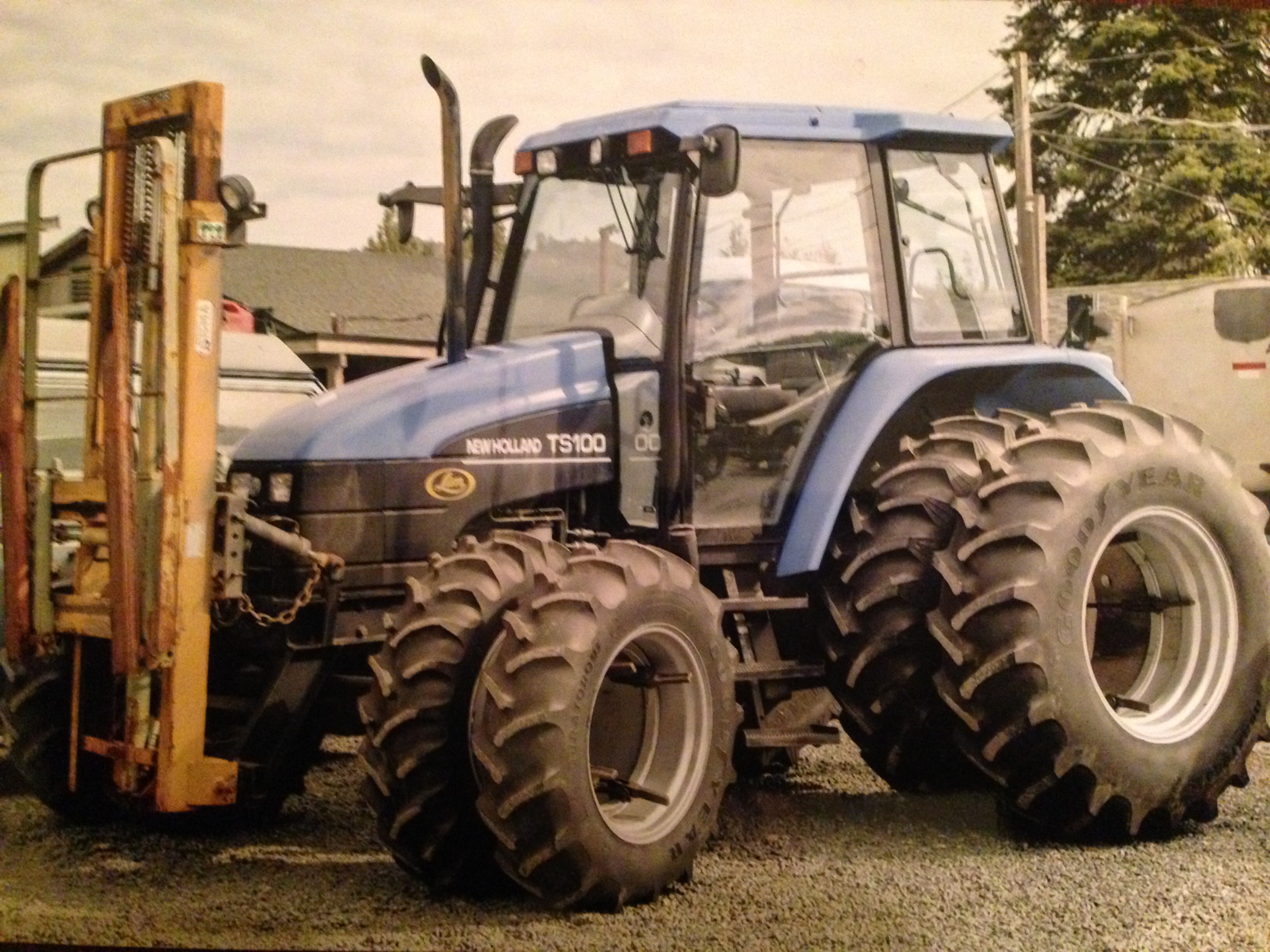

Feb 3, 2020 / Better front floatation #4 Big Barn Super Member Joined Aug 20, 2013 Messages 6,874 Location Victoria, B C Tractor More than 40 over the years. Ten at any one time. Mostly Ford and New Holland I put duals on the front of my TS100 for floatation.
