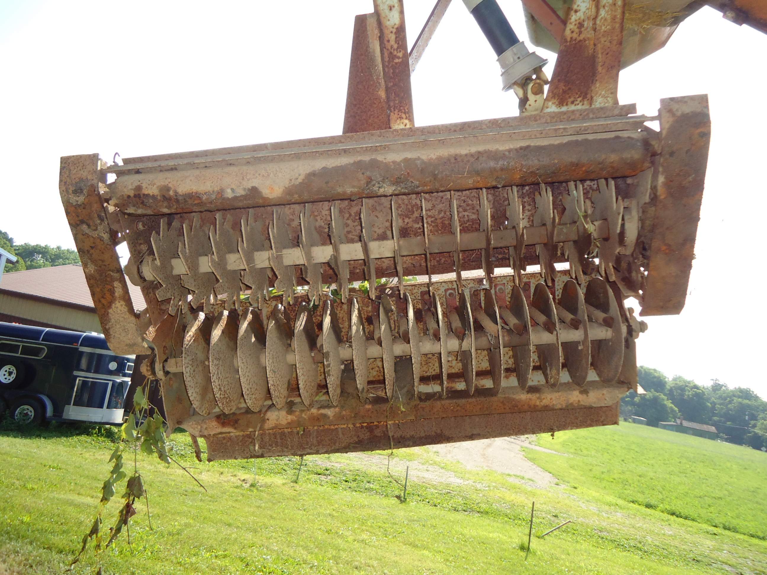

Here is an overseeder like Gator6X4 is talking about. Rotating cutters make a slit, seed drops in through tubes, disc's cover it up.
Some equipment rental's have them. We have a local dealer/rental business that rents them for $175.00 per day.
This one is not pretty, but barely used. Reseeded a high school football field for about 4 years, until they got astro turf. I got it off a fellow who bought it at the school surplus auction, but never used it. Found it on Craigslist for $100.00..!!
