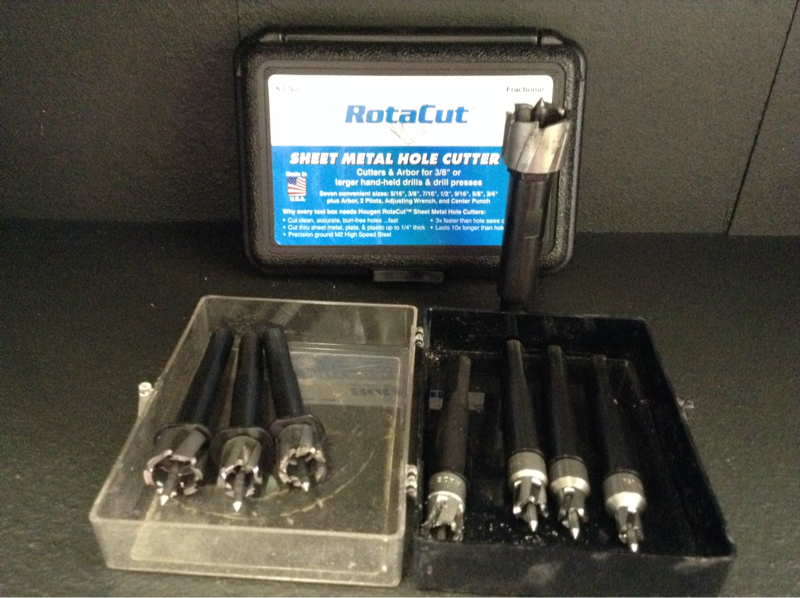

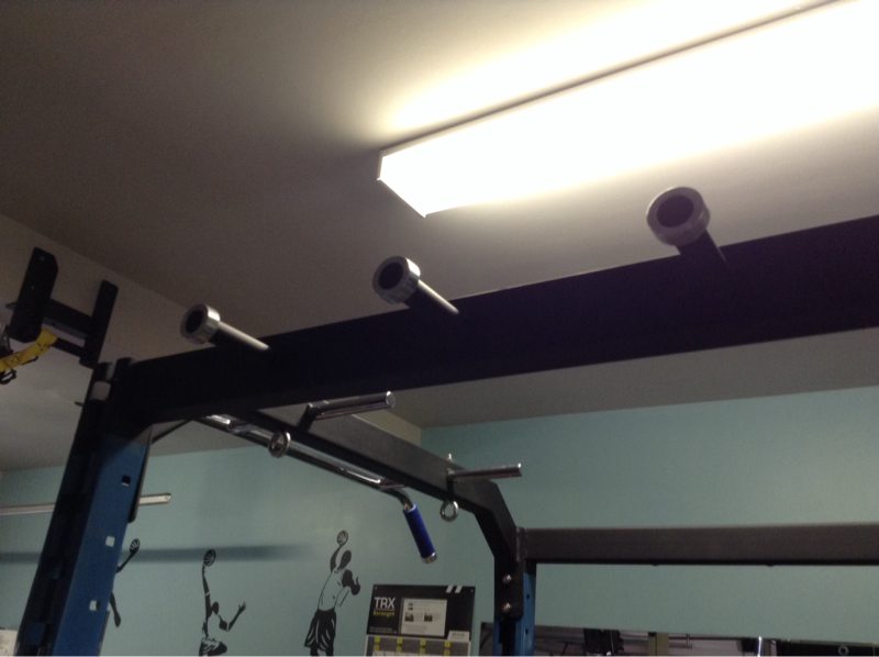

XMS. I have done it both ways. The first pic shows 1" solid round stock going directly through 2x3x1/8" tubing for a pull up bar
and the same round stock used for resistance bands butt welded.
The second pic shows the 1" sheet metal cutter I used to bore holes. They are similar to annular cutters and each hole probably took under ten seconds to bore with virtually no effort.
Terry

Thanks. I see you went Roman for the gym. Nice work.
I like those cutters. They say, "hand drill" but not sure I'd want to man-handle them myself. That would require more time in a Roman gym for me, I think.
