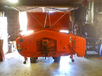

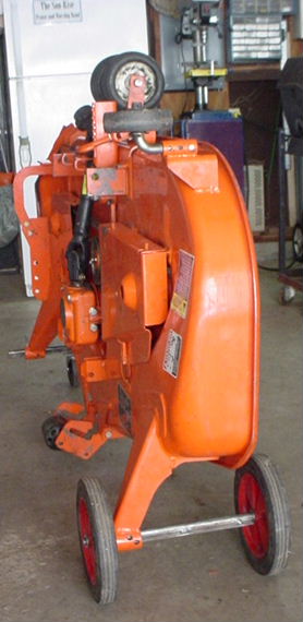

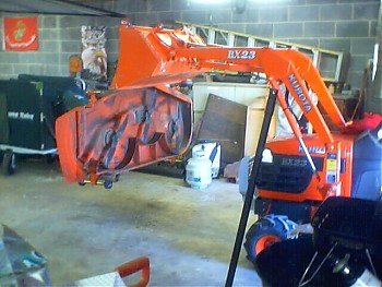

I use an air impact wrench to R&R the blades but I have also used a socket & ratchet and a block of wood to keep the blades from turning. While you have the blades and cups off is a good time to grease up the spindles as it's easier to see if your getting the spindles full.
To get the MMM positioned for easy serviceing I use the FEL to lift the MMM and I then install mower axles in the rear anti-scalp wheel sockets and set the MMM on end. The mower axles are good for servicing and stowage as I can easily roll the MMM out of the way for the winter.
Since you have a B series MMM, instead of useing the mower axles you can either lower the MMM just enough to where the rear of the MMM is resting on the ground whilst the front is suspended by the MMM. I've done this before without any issues -or- ueing the FEL, you can raise then lower the MMM and place it on the ground on it's top, exposing the blades for easy access.
I wouldn't worry too much about scratching. I use chains and haven't scratched the MMM yet, but after 3 yrs of use I do have various battle scars all over it :D

   / Best way to remove MMM blade. #6
Volfant, I thought you used Gator blades?
   / Best way to remove MMM blade. #7
Busted :D
I do!
The pic of my MMM standing on the mower axles is when it was still a virgin brand new mower (Dec 2004) and hadn't yet tasted the sweet nothings of the slaying of the grass :D
It still had the std OEM blades (that worked pretty well btw) and you can also see my failed attempt at fab'ing up a mulch plate too.
I sure wish that MMM looked that good 3 seasons later :D :D
The 1st two pics is after a yr of use but I still had the std blades on then too.
I guess I goota use newer pics :D
Those gatorblades I use aren't coming off. One would have to pry them off of my poor tired ole hands 1st :D

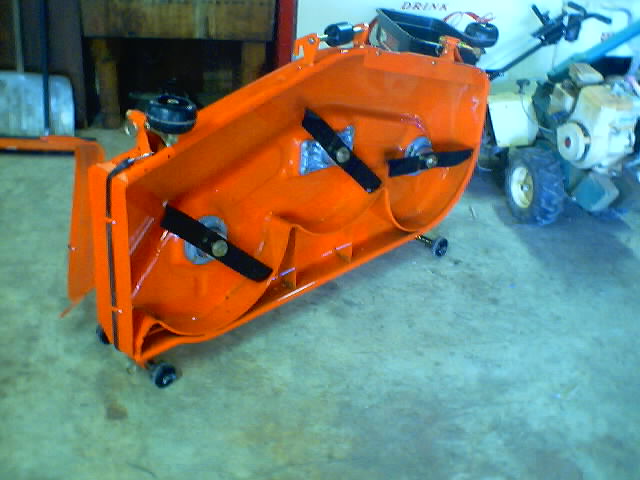

Don't hesitate to use that loader for a lot of things. That's how I get the 60" MMM off of my 7510. I take it off for snow season.
Attached is a photo of my deck dolly. It gives me a better way to stow as well as work on the deck. You may want to check out the post on cleaning the bottom of the mower decks too.
