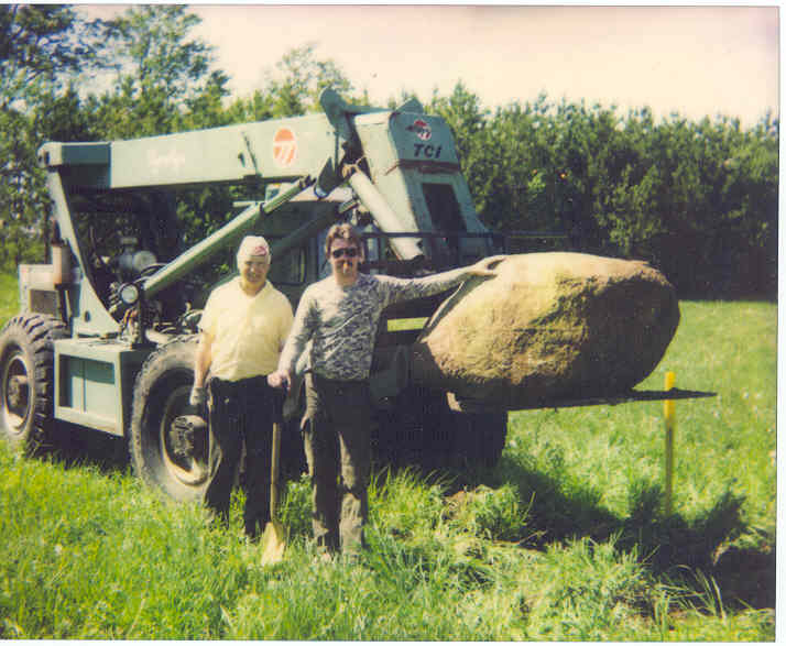

Guess it just depends on what resources you have at your disposal or what you are prepared to spend. I like the car hood idea. The pioneers had much less to work with.
