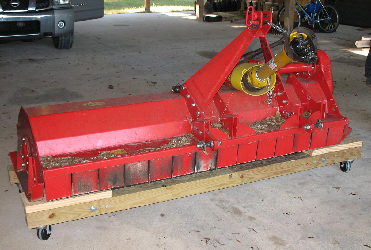

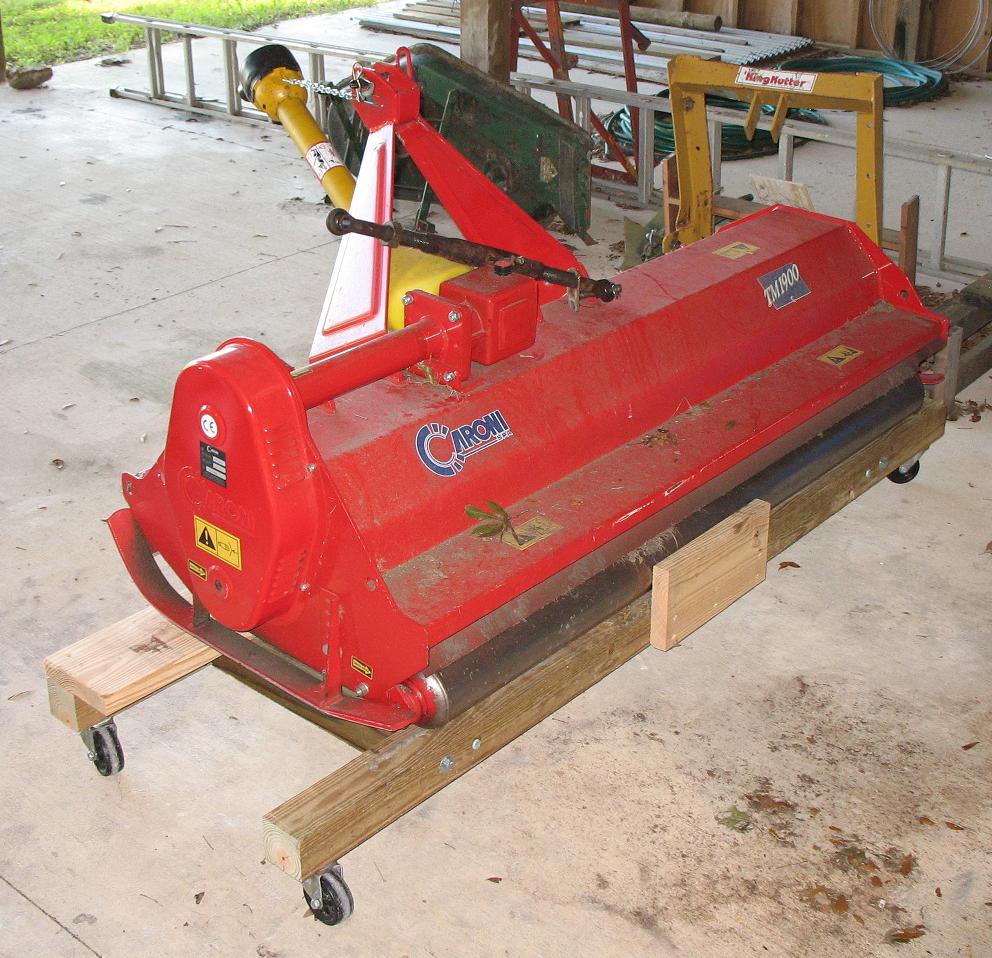

Put your implements on dolleys so you can roll them easily into place :thumbsup:
Or you could hang them from tree limbs or rafters so you can easily swing them into place :thumbsup:
Here's my dad's flail mower sitting on its dolley:
attachment.php
attachment.php

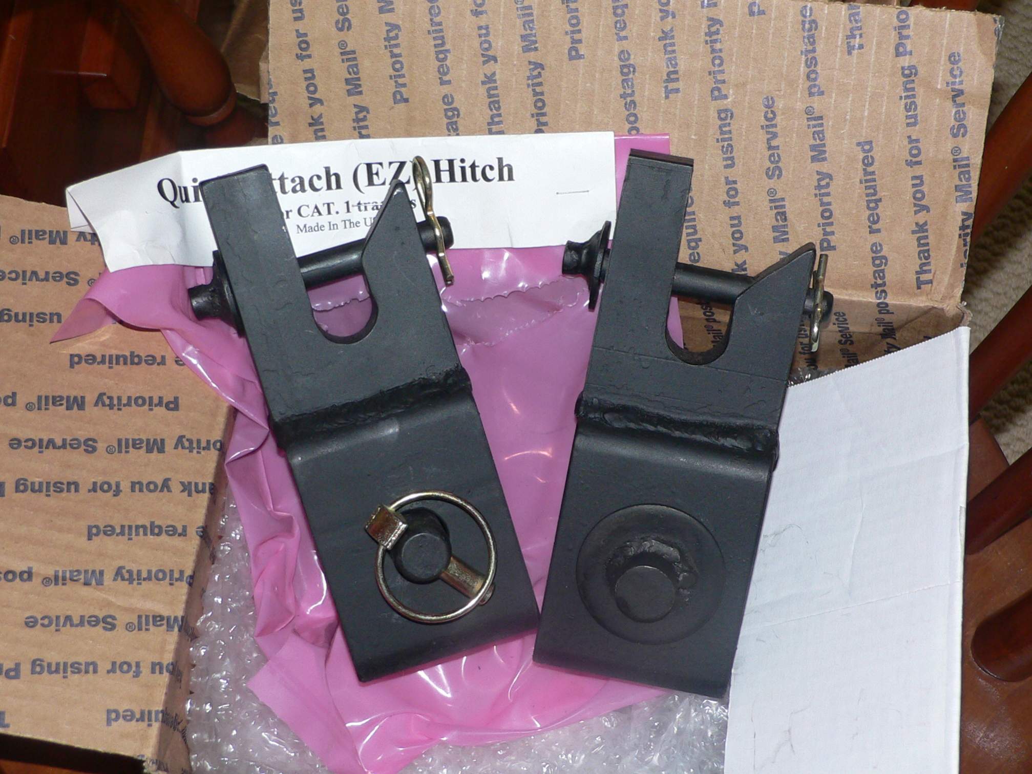

I got one of those HF quick hitch , it makes hookups a breeze for most stuff I got. :thumbsup:
   / BEST way to mount 3 point implement: BX2360
HF quick hitch - is that Harbor Freight? Sounds like a good idea.
   / BEST way to mount 3 point implement: BX2360 #6

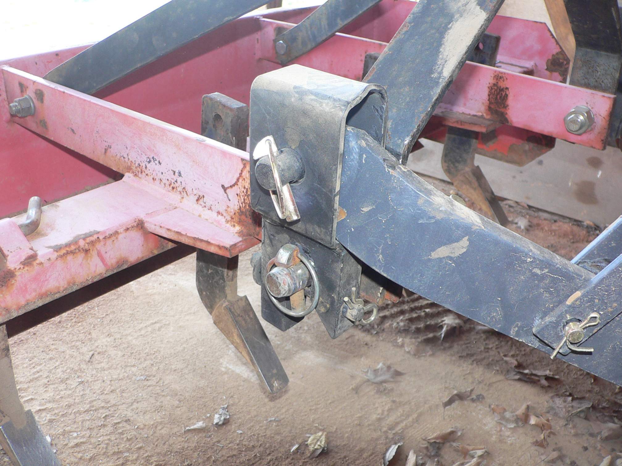

I use a Quick hitch. I started with Pats then bought a $100 one off Ebay and then bought anothe rone off ebay and sold the Pats. I have two now but mainly use the one that will hook coming down or coming up. The reason I use it mostly is with the QH my drive shaft on my tiller was to short but with the down one it works.
